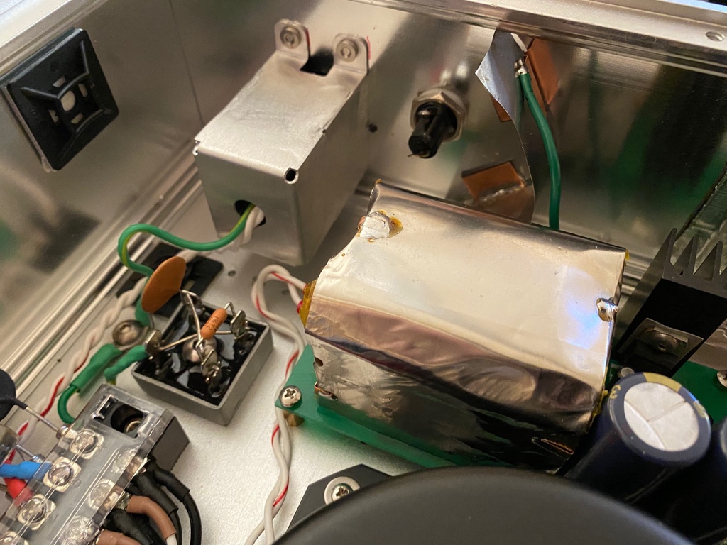

Going to create Faraday around IEC.
My first salas simplistic RIAA amps has the psu inside the same enclosure as the riaa amp.... I needed to create a screen between the iec inlet and the nearest riaa input rca... A steel plate connected to gnd was effective... later used mumetal with even better results 🙂

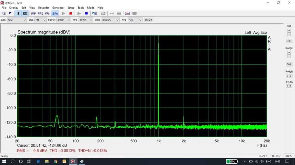

Well, beside the fact that my 60Hz spikes are appears only with Khozmo (and not with any of mechanical units that I have in hand) I installed IEC shield. It is GNDed aluminum that I found on one of my old junky industrial controllers. Also, I cleaned all RCAs.
And….damn, I accidentally dropped my test lead prob of GND on one of “-“ outputs on DCST. So, 400mA fuse and BC560 are both “kaput”. I replaced damaged parts and got back to business quickly.

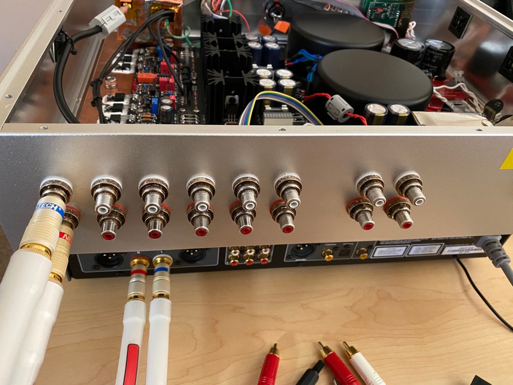

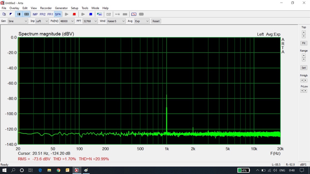

There is absolutely no noise then inputs are shorted and very little 60Hz and its harmo180Hz spikes when I deliver sine with 1VAC RMS -10dB. I found signal ground position that gave me no hum with Audeze. So, I decided to leave it as is and will close box tightly today.

L channel DCSTB GND out to Earth. No lifting anymore.
Yes in did, and Ricardo was right. His tip reduced total noise substantially. It was nice to use mu Metal there instead of Al, but I’m totally out of it. Do not understand prices of that Ni alloy either. It must be way cheaper since it is that exotic.
My Arta is calibrated since we discussed it about two years ago. I have 1V RMS on Focusrite input when I see 0dB on Atra screen. I just hope that my Fluke is measure right AC voltage with 1kHz frequency.
