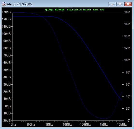

What BJT's did you use for the Q1 Q2 mirrors?

As for the Q1 and Q2 I used like stated in the BOM and kindly provided matched by Tea-Bag - BC560 🙂

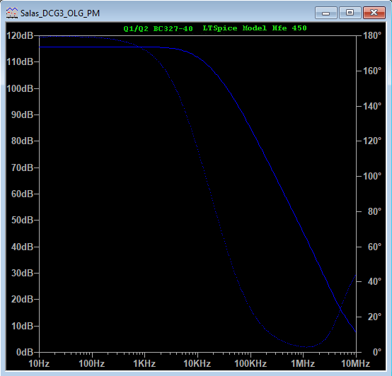

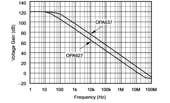

That's the technically more potent for peak OLG and easier to match standard. It won't change in the BOM because its the scientifically better choice. The BC327-40 alternative one is the lower 1/f self noise ~10dB milder but wider peak OLG plateau choice for the willing to find a good Hfe batch and wilder to match. It takes sockets to compare subjectively its impact in different systems and tastes. There is an early consensus its a subjective upgrade for tone and clarity. Although one member with the biggest speakers between other testers reported it indifferent for changes if not little bit boring for dynamics. In both cases there is 107dB OLG at 20kHz for the DCG3 though, no worries. An OPA627 offers just 60dB there to help you see the situation in some wider frame.

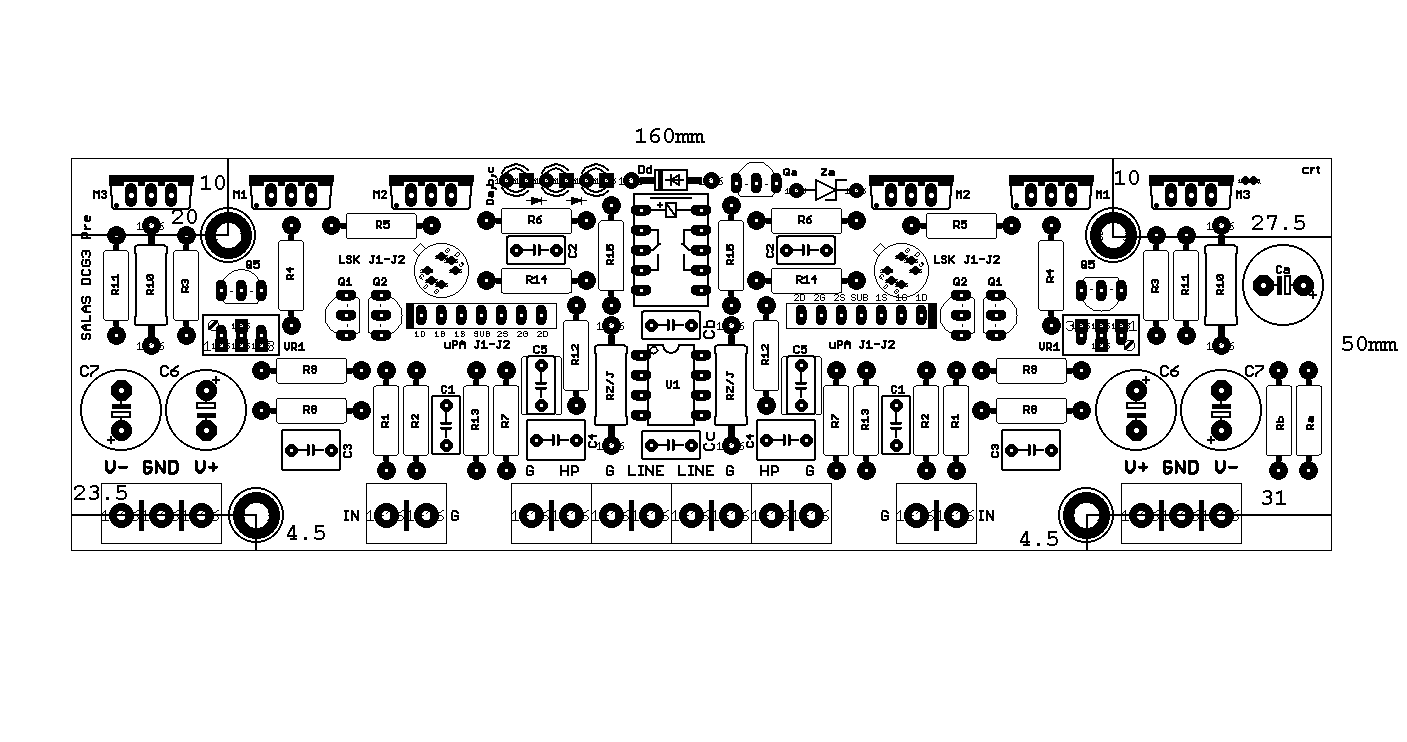

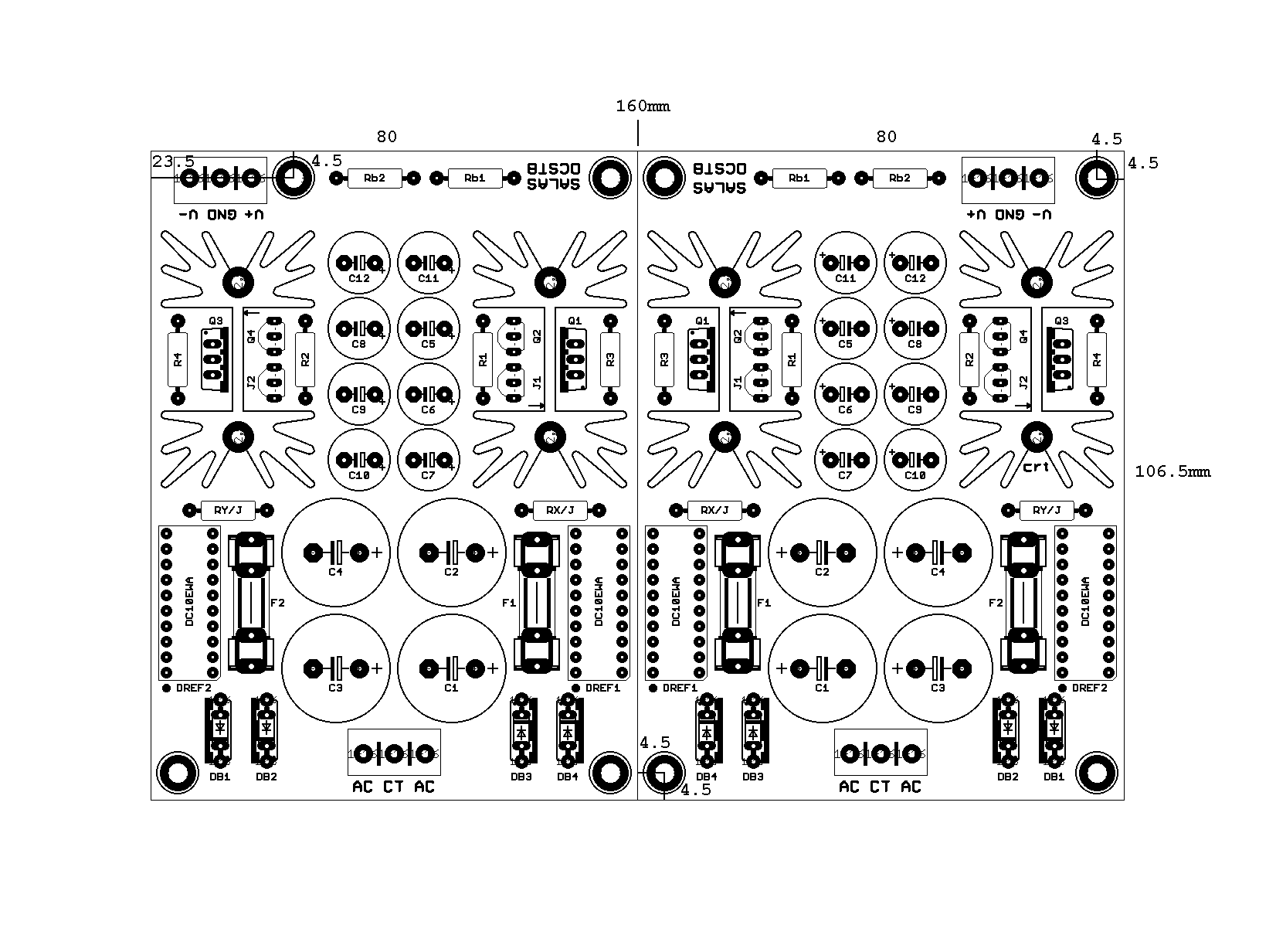

What I could make out about boards dimensions and their mounting points coordinates from grid view on the PC then with a ruler on my samples is attached. See if you can confirm on your boards too.
Hi Salas,
Thanks for the info and the help. I cannot easily get the dimensions from my boards since they are already populated & termporarily mounted and seriously spoiling my ears... And I also thought it would be most logical and exact to get all dimensions straight from the PCB design files.
Thanks very much.
