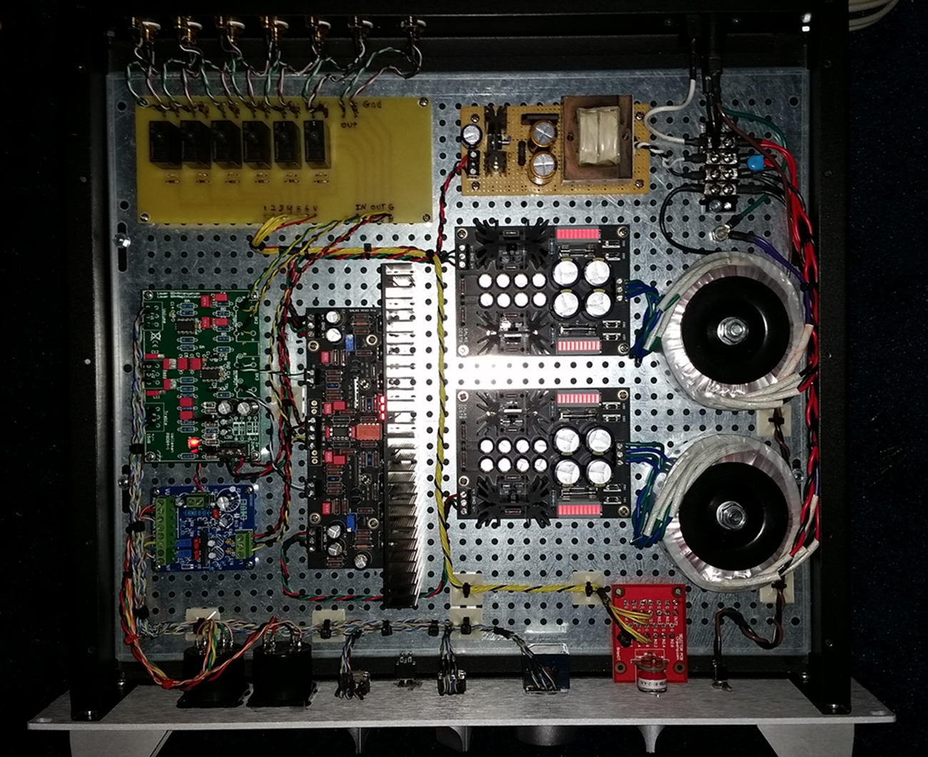

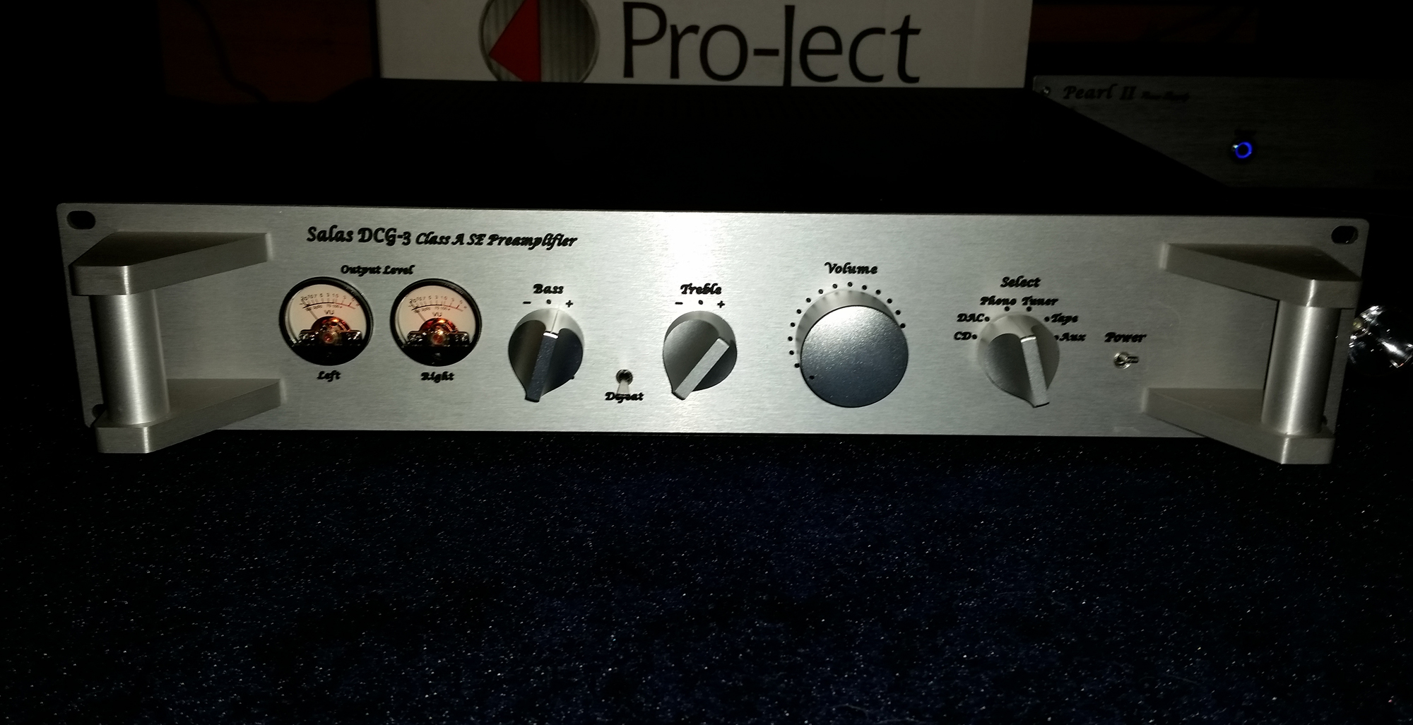

I did the cnc work on the front panel. The meters are getting blue LEDs inside once it's sorted. The 3rd power supply is 12v for the relays and the meter board. The Velman pre steals it's +/- from the rear DCSTB. The unconnected switch is going to be a tone defeat, someday. 🙂 I plan on also adding a headphone jack in there too.

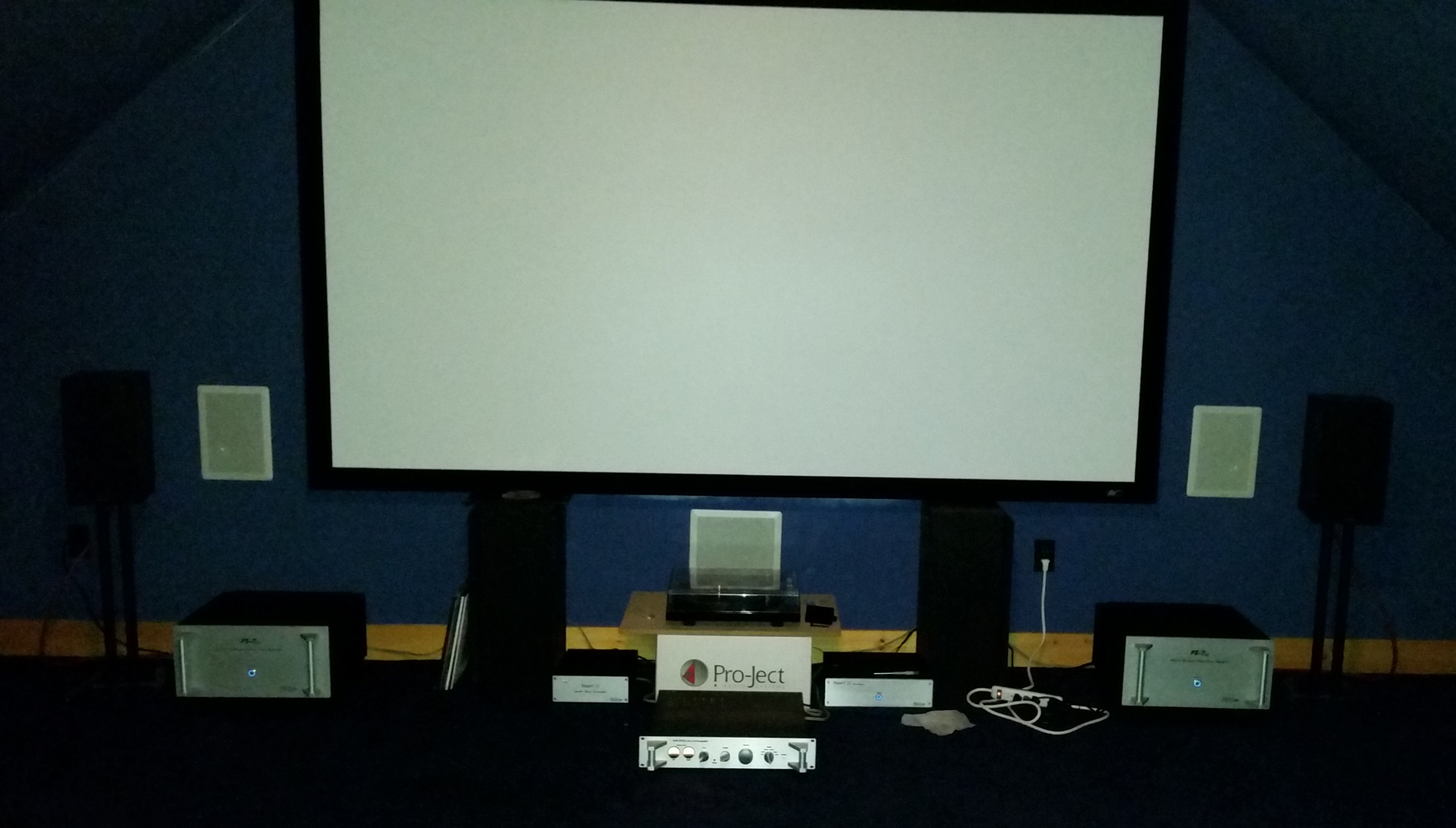

No phones yet and it may be a while for those...unless I win the lottery. :$: :whazzat: The speakers in the system pic are decent but they're temporary. Some 20 year old Polk Audio R50s. Next will be a 12" SB Acoustics 3way (or 4way) that I already have drivers stashed away for. 😀 Almost there!

But...I did notice something curious. I powered it up after the meter LED mod (no other mods) and I could hear a faint sizzling noise. I used a long piece of 1/2" shrink tubing up to my ear and moved it around until I located the noise. It was coming from the DCG3 around the relay. It was strongest over the transistor that drives the relay. When powered off the pitch swept up in frequency and stopped. When powered on again there was no noise until the relay clicked on. It gets quieter after left on for a while but still there. Nothing comes through on the audio, just physically from the board. I've heard similar sounds coming from the outputs devices of power amps singing while doing high power testing on dummy a load. Any idea what it could be?
Sorry it took so long, was waiting for parts before pulling it apart. I put in the 100pf cap and the sizzle is gone! I first tried disconnecting everything but the DCG3 and it was still there so I did the mod. It probably isn't anything catastrophic but something others may want to be aware of.
