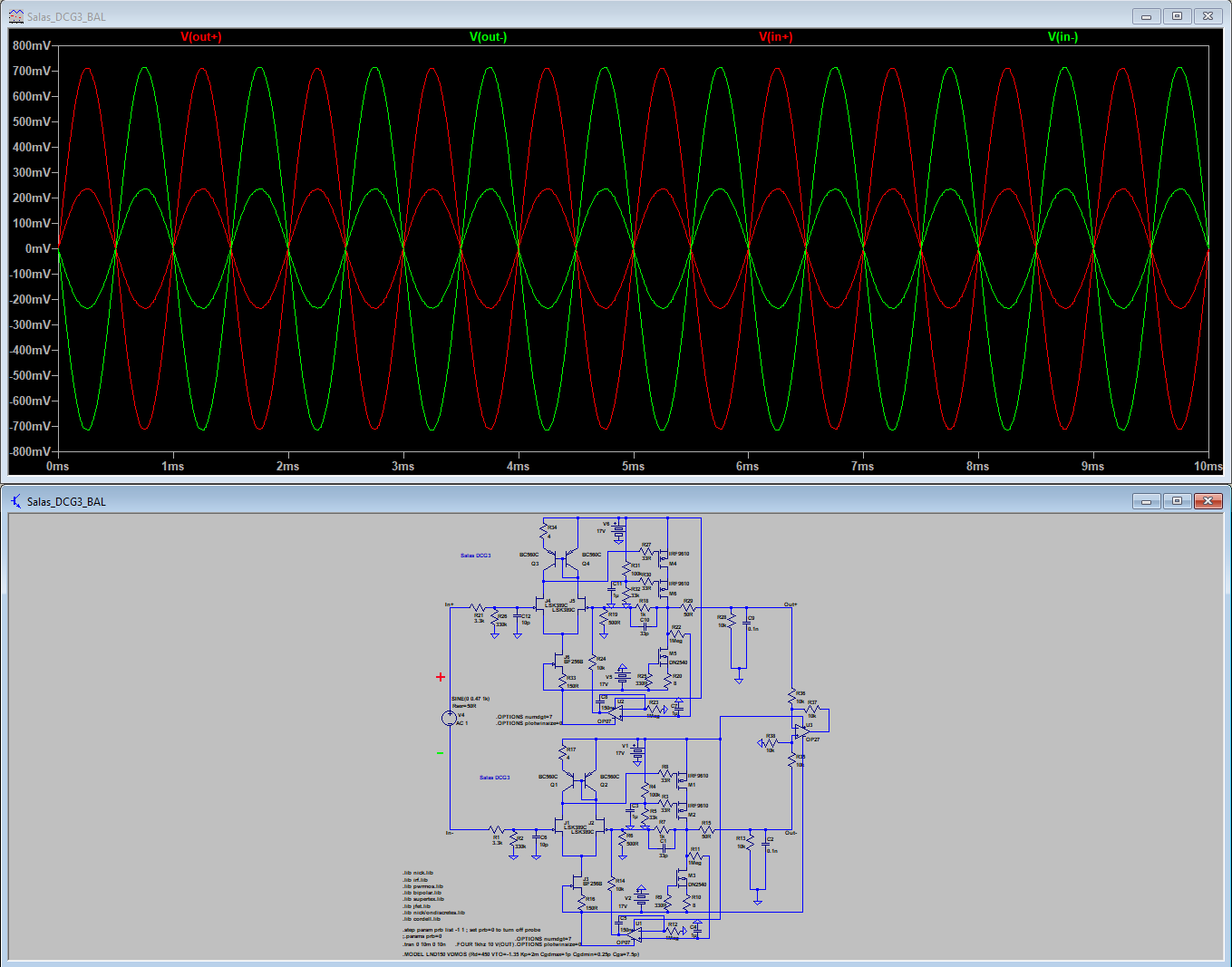

Trying to give a differential input to my DCG3 - a doubled build - I thought to test the circuit in post #61 of this thread A simplified universal differential or single ended phono preamp But this gave me another idea. To demonstrate it I had to cannibalize Salas' schematic, sorry. The idea is to provide the inputs of DCG3 with something to amplify while the source signal faces a balanced impedance. Would this work at all?

It looks like shorting both differential input signal lines to ground. If both phases dcg3 amps were floating it would have been feasible I guess.
Salas, thanks for reply! The meaning behind all this is to isolate the source ground from DCG3 ground. What we would call "XLR pin1 to chassis". In the schematic I posted the grounds are supposed to be floating. I just don't know if they should be separated or connected together and in any case not connected to source ground.
In your schematic, I assume that pin1 problem is addressed but the whole DCG3 works as an input stage to the final opamp?
I put a final op amp there to can also check recombination to SE. Normally the two amplified phases would just continue to feed a balanced input power amplifier.
OK I understand it now. So, I only need to disconnect the ground wire from the input XLR as the rest is exactly what I have at the moment. I'll test it ASAP. Thanks again!
