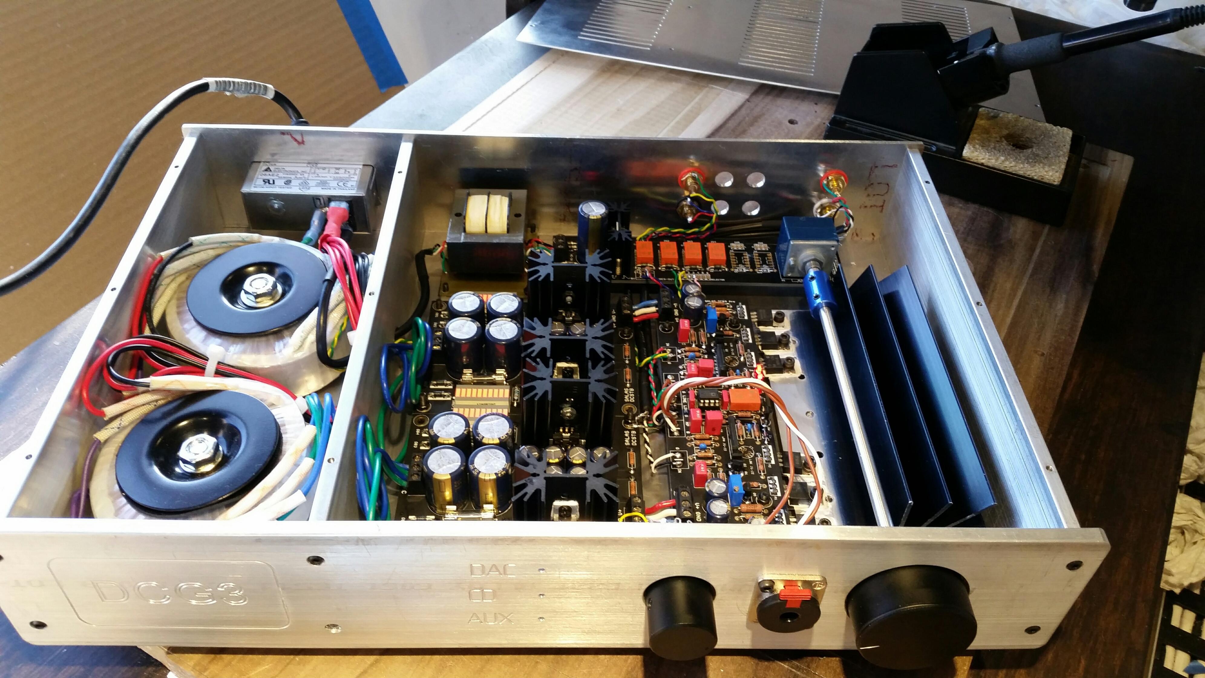

I got mine working for a while, but putting it on the chassis took more time. I used my homemade CNC (not too reliable) but good enough to cut aluminum, drill holes and cut the vents. The last thing I have to do is clean it up by sand paper and get anodized.

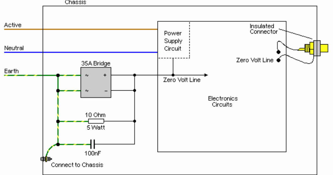

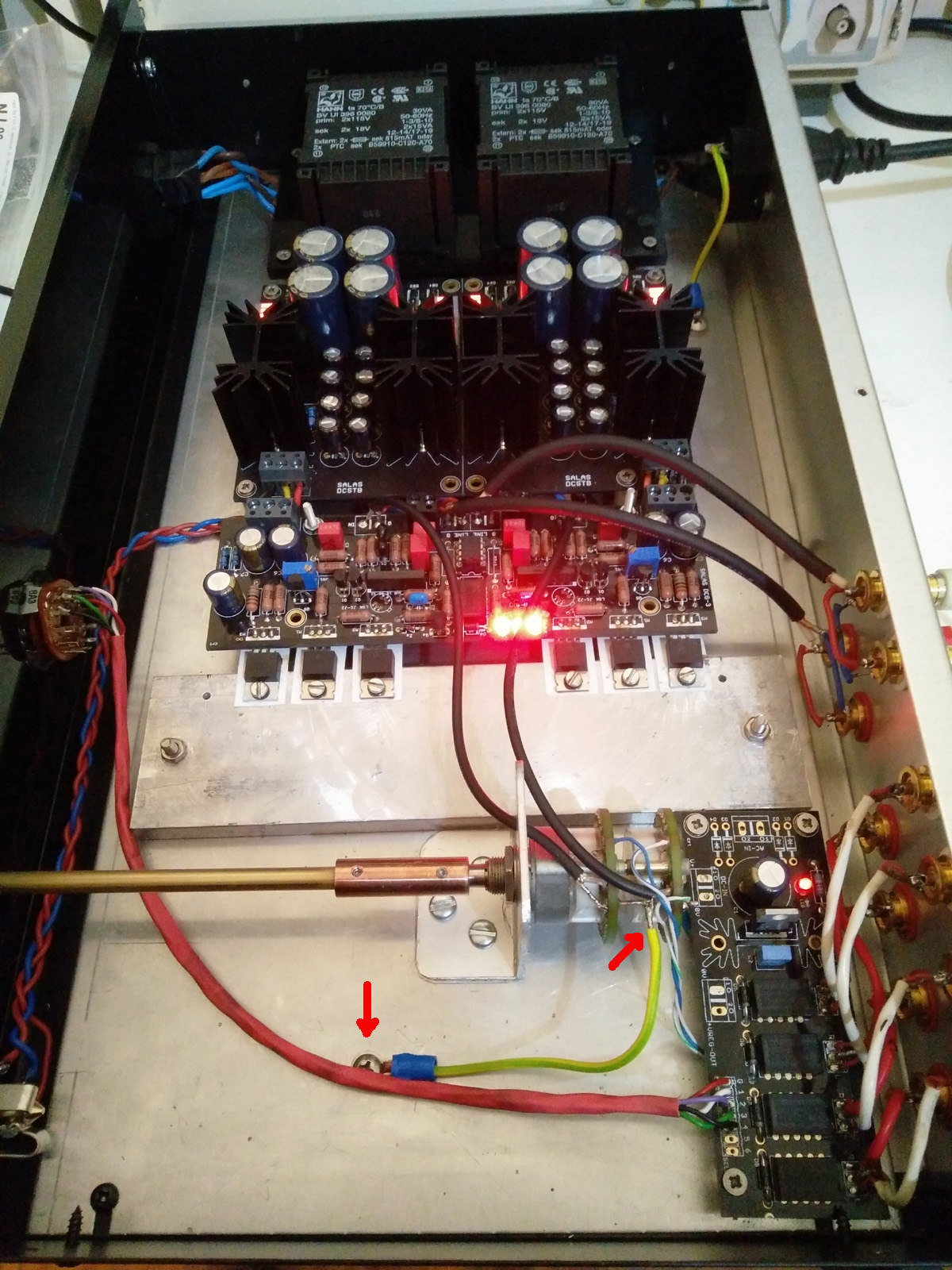

I encountered some grounding issues on mine when I first powered up. I can hear the humming noise when I increased the volume on the pot but when it reached the max volume, the noise goes away. Did try to isolate the problem using star grounding and also followed the attached schematic but same thing. I get tired of it trying many things, so I decided to connect audio ground directly to chassis ground. The DCG3 became dead quite.
Some said, its not a good idea but hey! it worked, so why not?

I like your homegrown CNC box result. Also has nice dimensions for housing this preamp. What are they?
Regarding your solution for chassis referencing to silence my guess is it has to do with the signal passing through the switch relay board which is powered from an independent transformer in your implementation so its local PSU does not see the rest of DCG3's PSUs grounding. Your pot sits on the same board. My switch board steals DC from the DCSTB and there was no hum but I habitually reference my audio ground return straight to the mains grid earthed chassis regardless. Brings the circuit's return to same potential as the box. So no interference fields can develop between them. As pointed with red arrows in my attachment. I add that fail safe mains earth lift scheme if and when there's a system hum problem. So no worries, well done. Please show it to us again when anodized, its nice to see how it ends up, and let us know how it further goes for sound after you will have even more play with it.
