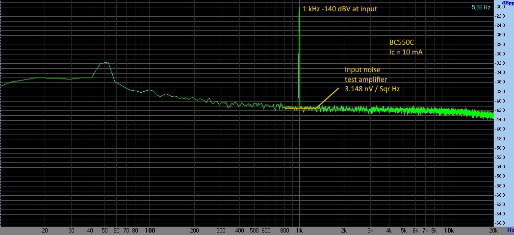

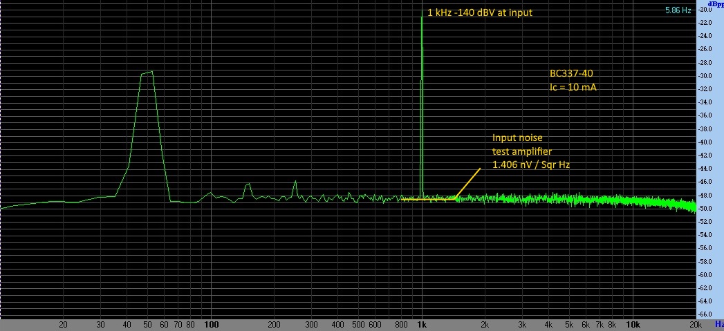

Hmm - didnt think it would make a difference. Have to try someday.
If it was a phono preamp lower noise active parts would certainly make a significant difference. Here the signal level is high and that parameter is not first priority. But the two types certainly differ in intrinsic noise. It could still arguably make a subtle difference. There is about 6dB self noise distance between those two BJTs in the main band and more at 1/f. At least when reading their NPN versions independent FFT test charts.
Measured by Dick Kleijer

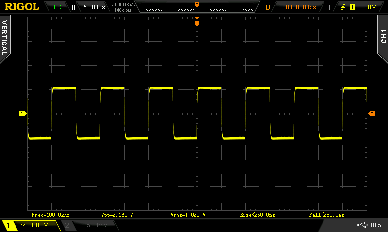

ΒΤW 100kHz square wave test with the new mirror transistors at a volume setting that I find plenty loud when on a sofa 4.5 meters away from my speakers. Its the same sound level that I would describe well loud before fatiguing for me on any headphones that are not mid-range recessed. 20kΩ series type switching log pot. Obviously the preamp remains fast enough for passing really high frequency pulses with such ease. 1.5MHz -3dB sine wave tested at that particular volume point.
Pretty ideal amp for driving http://www.lundahl.se/wp-content/uploads/datasheets/1570_0xl.pdf and get a single ended to balanced with a dB raise
That is a very clean square wave for 100khz..
