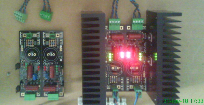

All set for my DCG3 to be fired up with all the parts installed and mosfets drilled and tapped on a good size heat sink. Also the BiB was setup to +/-17V DC very stable voltage using the new EI cores (18v) transformer and it runs cool, thanks for the suggestion Salas. I used a 150R 5W wirewound resistor as the load resistor for +/-IRF to set the voltage. Now that all mosfets look perfectly aligned to the heat sink will solder the pins. Checked the shorting of the mosfets to the heat sinks and all looks fine with the TO-220 insulation pads and small plastic bushes which came with Tea-Bag.
Here are the pics:
Here are the pics:
I just powered it up and the DCG3 all the 3 LEDs lit and within a few seconds the relay clicked and everything looked stable without any heating up issues.
A quick question regarding the DC voltages after powering up the DCG3 board with +/-IRF boards. I used the 150R 5W as load resistors and set the output DC voltage to a very stable +/-17V. Now after I connected the PSU to the DCG3 board and measure the voltages, either on the preamp board or directly on the PSU boards I get the positive being at around +16.98v but the negative side shows a dip in the voltage at -6.19v.

One of the channel the voltage drop across R10 shows correctly at 48mV but the other channel starts at 2.19v and stays there which is against the guide that it should be within 100-150 mA. Seems to be some problem with one of the channels.
For starters, are you sure that your BiB's positive and negative rails are both set for the same CCS current? On the BiB the positive and negative rails need different CCS setting resistors to obtain same CCS currents.

Maybe the DN2540 connected to that high voltage drop R10 is shorted. Either to chassis or it died during handling & assembly. Luckily the BiB limits any fault current in the preamp to its own CCS setting thus it drops the rail voltage and controls the damage. Like lab supplies in CC protect mode do. You look for 1.2V or thereabout across each R10 after you will fix the error. Measure those R10 for Ω value also.

Disconnect the BiB and test its polarities with dummy loads again. To see they still work well alone. Let us know Vdrop and value of your BiB setting resistors. Compare DCG3 components per position between sides while the PSU is disconnected.
Hmm need to check DN2540 but if its damaged then thats a big issue as Tea-Bag provided matched VGS 🙁. I checked for shorting for all the mosfets before powering up and they are perfect insulated from the heat sink.
I checked the resistances across the legs of the DN2540 and both of them look exact same with perfect matched values. So I hope the mosftet M3 on this side of the channel looks fine. Do I need to check anything else to resolve this issue.

Hmm let me check this as I used small shorting pins on the BiB output sides to make it regular 2 wire outputs rather than Kelvin types. So when we short with pins I presume it does not make a difference with which side I am going to run the output wire? Or does this make a difference?
There's a short somewhere unless your negative BiB section is set to just above the dummy load consumption and limits with for few more mA.
Does not matter. But maybe the pins press together and short -F to 0?
Your guess looks correct on the BiB negative board Salas, I see that the Q205 is reversed on the negative board. Those small transistors are hard to see the orientation if not done carefully. I think this reverse makes the polarity correct. As the positive board has this the opposite and looks fine with my orientation as well. Hence the positive side gives the output correctly but the negative one might be actually giving wrong polarity.
Yep, for one side the polarity is reversed, so it's

Thanks Savvas, I hope that once I reverse the Q205 on the negative board I should get the proper polarity and then I will set the output voltage again on both the boards using the 150R 5W load resistor to get to +/-17V DC and power the DCG3 again. I hope nothing has damaged on the DCG3 board 🙁, as desoldering any parts on the DCG3 looks like a pain with so many small parts.

I reversed the Q205 on the negative BiB board and checked the DC output voltage with the load resistor. As you can see from the below pic I still do not see the '-' sign on the DMM for the yellow cable which is for the negative board.
But if I change the probes of the DMM then I get to see the '-' sign for the DC output voltage. So not sure where exactly is the problem for the BiB boards.

Stupidity of me to connect the wrong colored shorting pins on the negative board 😡. Now the negative voltage shows up correctly after I found that with the DMM probes reversed the voltage was becoming negative. Let me now connect to the DCG3 and hope nothing would have happened to the preamp board 😱
Now Q205 looks in the right way. Your yellow cable is the 0 and the black is the - (negative board)
I assume that you are using one bib for both negatives (i.e. both channels) and the other for positives
In that case you have to join all the 0 of both boards together
If your positive board has black for 0 and red for +, you have to join the yellow from negative and black from positive together. It would have been for appropriate to have used the colors in your negative the other way (yellow for -), so all black cables were connected together.

Yes it looks fine now with the first power up and I get around 1.2v on both the R10's and mosfets are slowly getting warmer.
