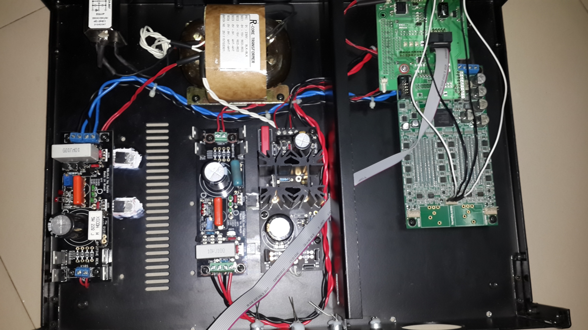

What I understand when you say 2-way classic output wiring for the BiB for the DCG3 is that I need to use dual wires on the DC output for each + and 0 of the +/-IRF boards. If you look at the below pic from my Soekris DAC build where I am using the BiB + Ref-D boards I think I have used the same logic of taking out the wires. Is this what refers to the classic 2-way?
Thanks Salas, looking at the pic I just need to jumper the +F,+S and F0,S0. After this just use single wires on either +F/+S which becomes the positive wire and another single wire on either F0/S0 which becomes the ground and connect to a multi-wire adapter so that I can run multiple output wires to power the 2 channels on the DCG3's DC inputs. This is the classic 2-way wiring when compared to my above pic which is the Kelvin mode.

Yes that's the procedure but don't forget to do the negative side also. -F/-S F0/S0.

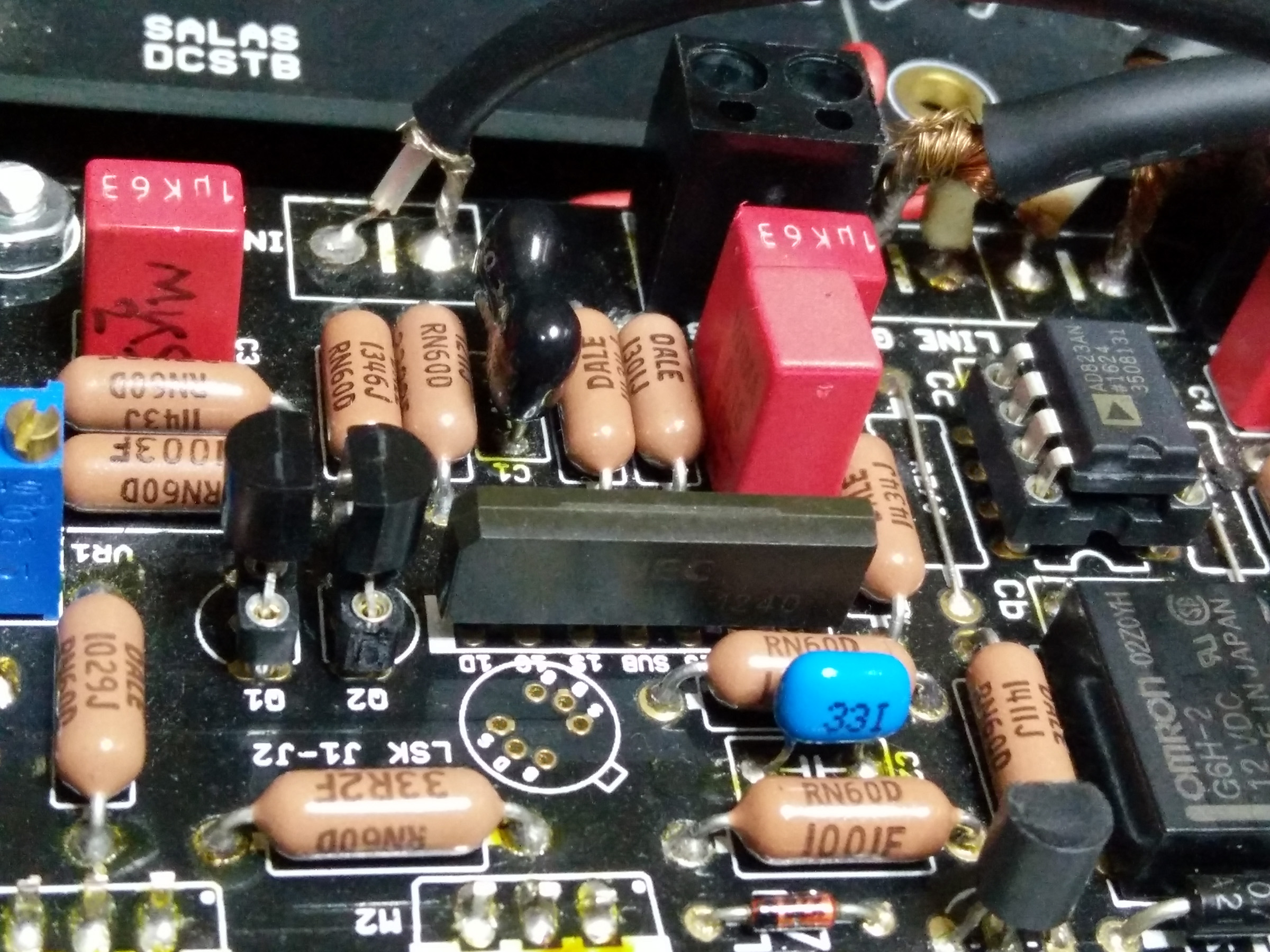

My take on Q1,Q2 BC327-40
So I picked and matched two pairs of 500+ Hfe BC327-40 BJTs and also checked for their curves align on the tracer within each pair. I used Atlas DCA75 to both identify Hfe and trace. Then I disassembled my preamp and put a row of three 0.1 inch (2.5mm) pitch female header pins for each transistor position that I cut out from a bar of 40. The BJTs legs fit snugly in those gold plated headers that are exactly what the usual DIP-8 good quality opamp sockets have organized in a frame.
First I checked with the gen and the scope that nothing went wrong or no alarming spec change was imposed by these smaller current gain bandwidth product (Ft) but also lower noise BJTs. The preamp achieves 2.7MHZ -3dB HF extension when with the pot wide open (no pot's impedance added to the 50Ω generator) and the rise times on various kHz and attenuation level square waves are still roughly as before.
On same day I listened with the Sennheiser HD 600. The next day I listened to the same music on my DIY tower speakers which have Tangband doubled up oval woofers, a PHL 6.5 inch midrange and a Celestion 1 inch exit compression driver on a FaitalPRO aluminum tactrix horn. Power amp was Mirand Audio TSSA V1.7 modules fed from a CM Darlington BJT supply of my own. Player was Foobar on Wasapi event mode XMOS driver and DAC was the Aune S16. I went through various genres of music tracks with up to 352800 Hz sampling rate.
To cut it short I am with Alex on this. Brings more meaningful character to the preamp's musical rendition. Deeper digging into detail and better focused in a smoothly cleaner kind of way. Not shouting "upgrade!" but bringing it out in a calm but surefooted manner. I did not hear any kind of rounder or ripe tonal tendency though. Maybe its a matter of particular sound systems and building parts synergy or simply down to the rigorous matching and high Hfe that I kept about to what Hfe my BC560s were. Those original ones brought the musical picture out bit more enthusiastically maybe but the alternative ones are helping even closer to natural in my humble opinion. I can listen at one click louder before its too loud. Talking about small things that are arguably prone to be swamped or shine between different audio systems but on the other hand in this kind of performance level they are also worth mentioning and exploring. For the enthusiasts every clue is useful nonetheless.
All in all I recommend you guys try for yourself and decide which rendition you prefer better or which one simply matches your build and the rest of your system better. As for me I am keeping those 327s as installed in the picture.

Hi Salas, where have you purchased your BC327? Unfortunately, none of mine got to that high Hfe. I used 375 and 346 pairs. The highest I got were in 400 range, but I could not get them to match. Is it from Mouser? On-Semi? Nice idea about headers. I regret that I did not do it in that way.
Those I have are leftovers from some years ago. They should be Diotec brand purchased in Europe. They are in ammo pack (cowboy legs row on a tape). Not very consistent but they score many hits well over 400 Hfe with few extra strong ones hitting over 500.
BTW what you use to measure Hfe? Because testers differ in the currents they use. So they can be OK to match Hfe but its absolute number won't follow other people's measurements when using another tester.
I use Atlas DCA75, same as yours I guess. Not sure about its accuracy (I do not have any standard-reference), but precision is very tight. I’ll try to get 20 more from Mouser and see if that batch has higher Hfe.
See to sample different brands. Also the room temperature should be the same when comparing noted down results from different sessions. And don't grab them with fingers but use a tool. Fingers transferred heat is enough to unsettle them for a while. Something helpful is we run them only at around 2mA-2.5mA Ic in the DCG3 circuit, so if your high Hfe hitting ones are matching their Ib labeled curves well at the Ic/Vce test chart's bottom half but differ in its upper half, its preferable to use those than well lower Hfe ones that match all over the different Ib curves. Always check that the tester's parameters are still the same when tracing close enough Hfe samples. Strong Hfe 327s will keep the OLG of the preamp near to what it is with the BC560s for a fairer subjective comparison.
I remeasured all with that precaution way and got bit higher values in steady room temperature. What % of matching is considered to be sufficient? I have high Hfe once with values equal to 425/420/418/407. All the rest is in the range of 340-360. I’m looking for the set to upgrade my second unit with LDR volume control.
