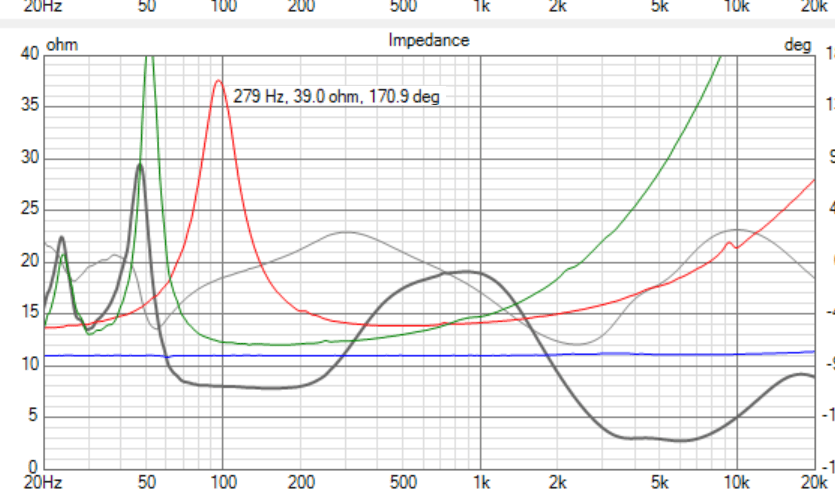

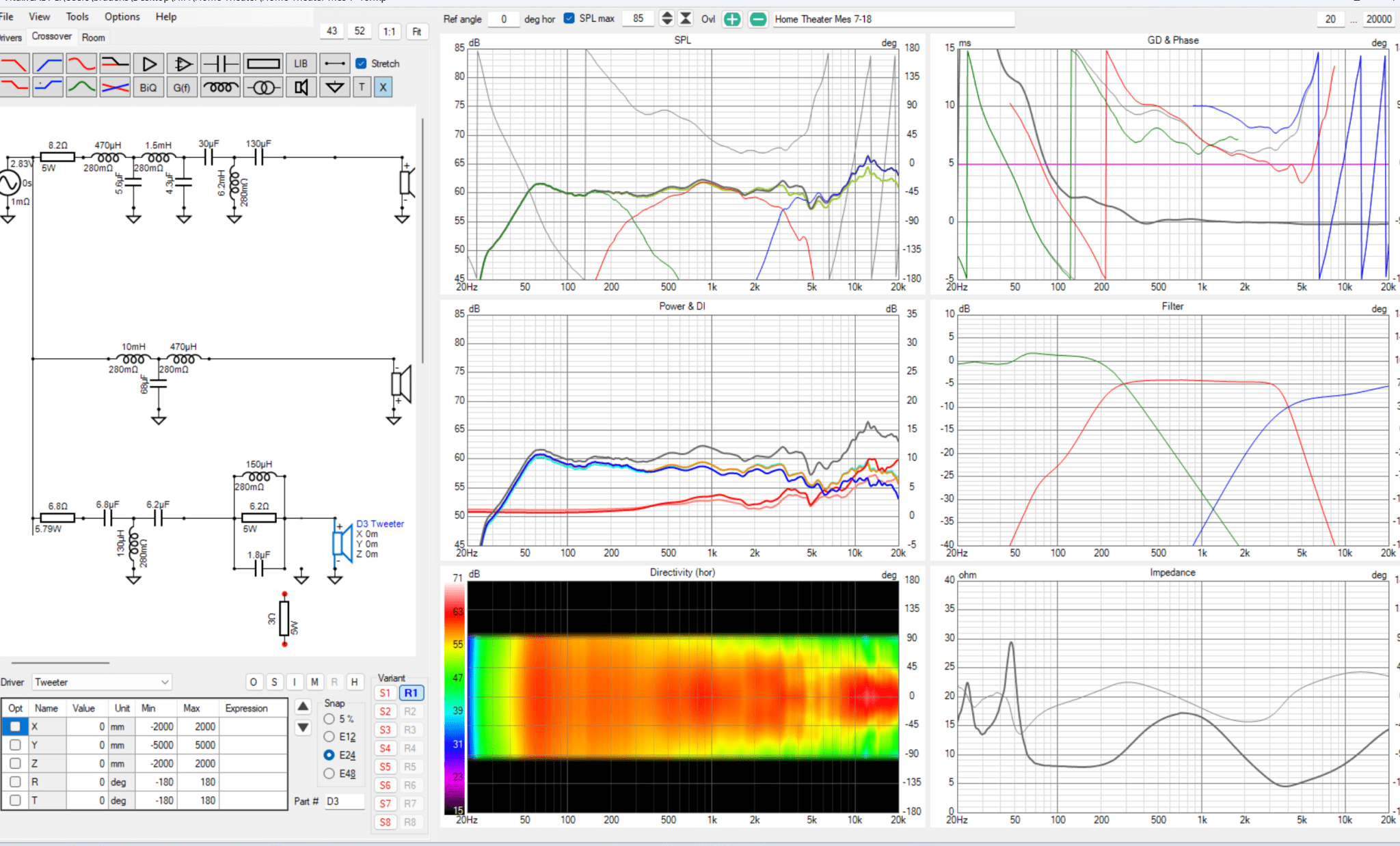

@Bmsluite - to erik's point above. Hoover over the Impedance pane of the VituixCAD 6-pack, right-click your mouse and select "Show Raw impedances". Right click again and select "Export image" to export an image of JUST the impedance pane and post that. That way it will be very clear to see. Sometimes if you export the whole 6-pack it is hard to see some of the details.
Here is the raw impedence. It now looks very similar to yours

Edit: just saw you don't use a shunting resistor anymore!
So it's ok now!
It will heat up to a dangerous level without you noticing it. The complete music spectrum current will flow through these two resistors (around 4 times the current that will produce useful sound, by the way).
It is really a terrible idea using very low value resistors and putting them at the unfiltered fullrange side of the crossover.

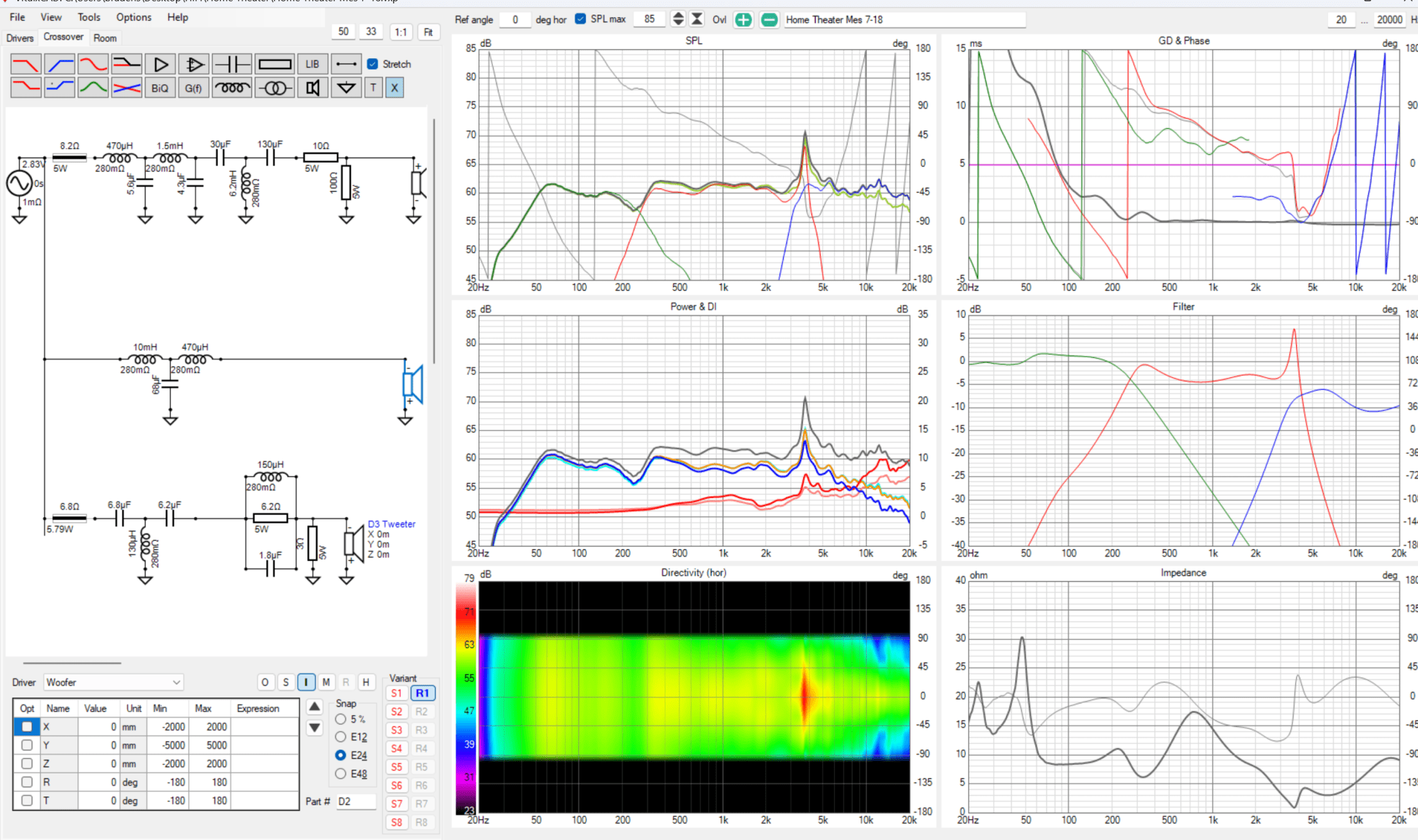

Ok good because I just tried to move an Lpad to past the filters and I either get cancellation on the fore with regular or on the aft with it inverted

Should I remove the shunt from the tweeter too? Seems this fixes cancellation up there as well. My directivity definitely takes a hit from this though

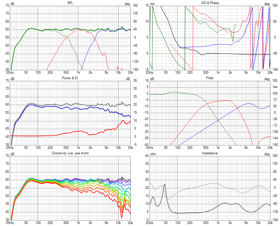

One suggestion: focus on on-axis response. Then try to fix phase. This will probably mess up your nice response so you'll have to work in iterations.
Then look at impedance. It's probably bad. Fix it. But this will mess you your nice response and phase so work in iterations.
Once you have a nice response, phase and impedance turn your focus to listening window and in room response. And... When you fix one of those it will mess up what you've done.
You can save 8 crossover variations at a time in VituixCAD. I tend to run through 24 to 32 variations. But I'm a lot less experienced with crossover networks than a lot of the guys posting, who might be able to come up with something in a few iterations because they have a pretty good idea of the value to start with and they know what each change is going to do to phase and impedance without having to "play around" as much.

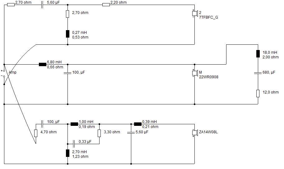

I dug in my archives...

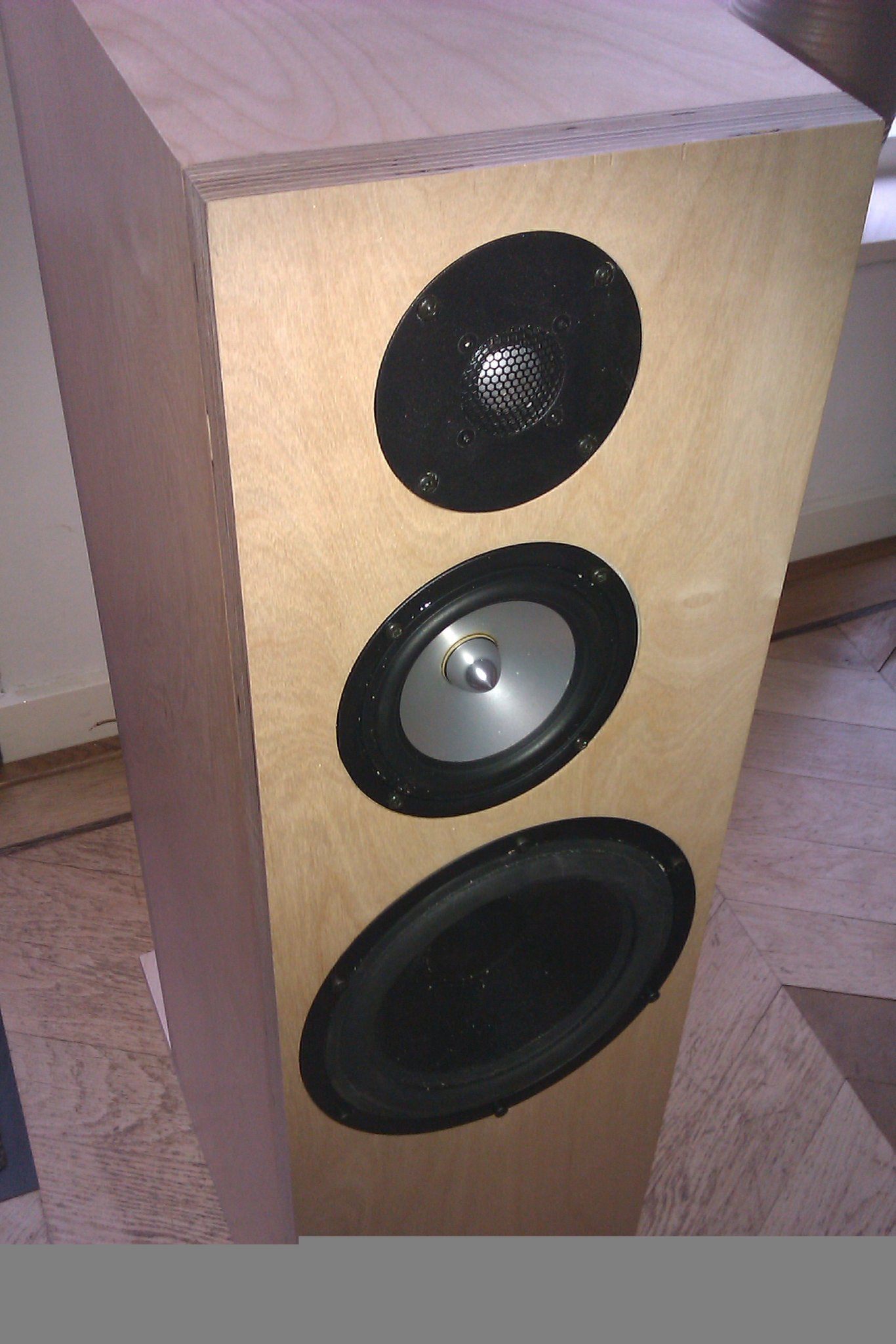

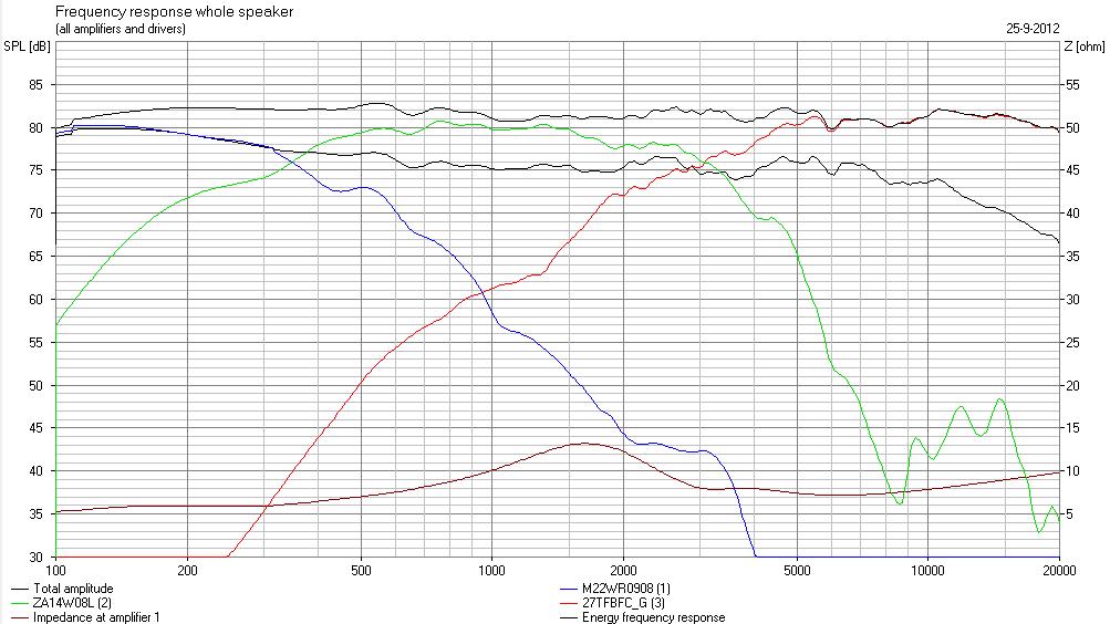

Back in 2012 I finished a 3-way design around the ZA14.
Overall response was pretty okay.
As was the proof of the pudding. Don't pay attention to the part under 200Hz, I didn't mind stitching the LF part for this measurement then.
This in an enclosure of 24cm wide and about 1m high. Just to point out that ZA14 isn't that hard to use and to give some inspiration.

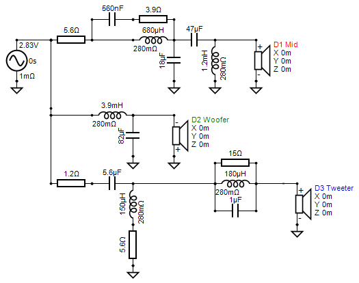

OK, this takes 15 minutes of my life 🙂 (but I have done hundreds of crossovers so far):
Home Theater Mes 7-20- low end phase fixed.  Removed shunt from high end Six-pack.png
Home Theater Mes 7-20- low end phase fixed.  Removed shunt from high end XO-schema-1.png
Mind you, this is far from optimal crossover! Among other things, in room response between from 2 kHz trough 4 kHz should be better.

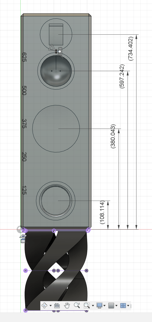

Edit: I just realized - you don't have "Y" values - distances between drivers! Crossover above would be correct ONLY IF the drivers are coaxial design! Please post distances between drivers!

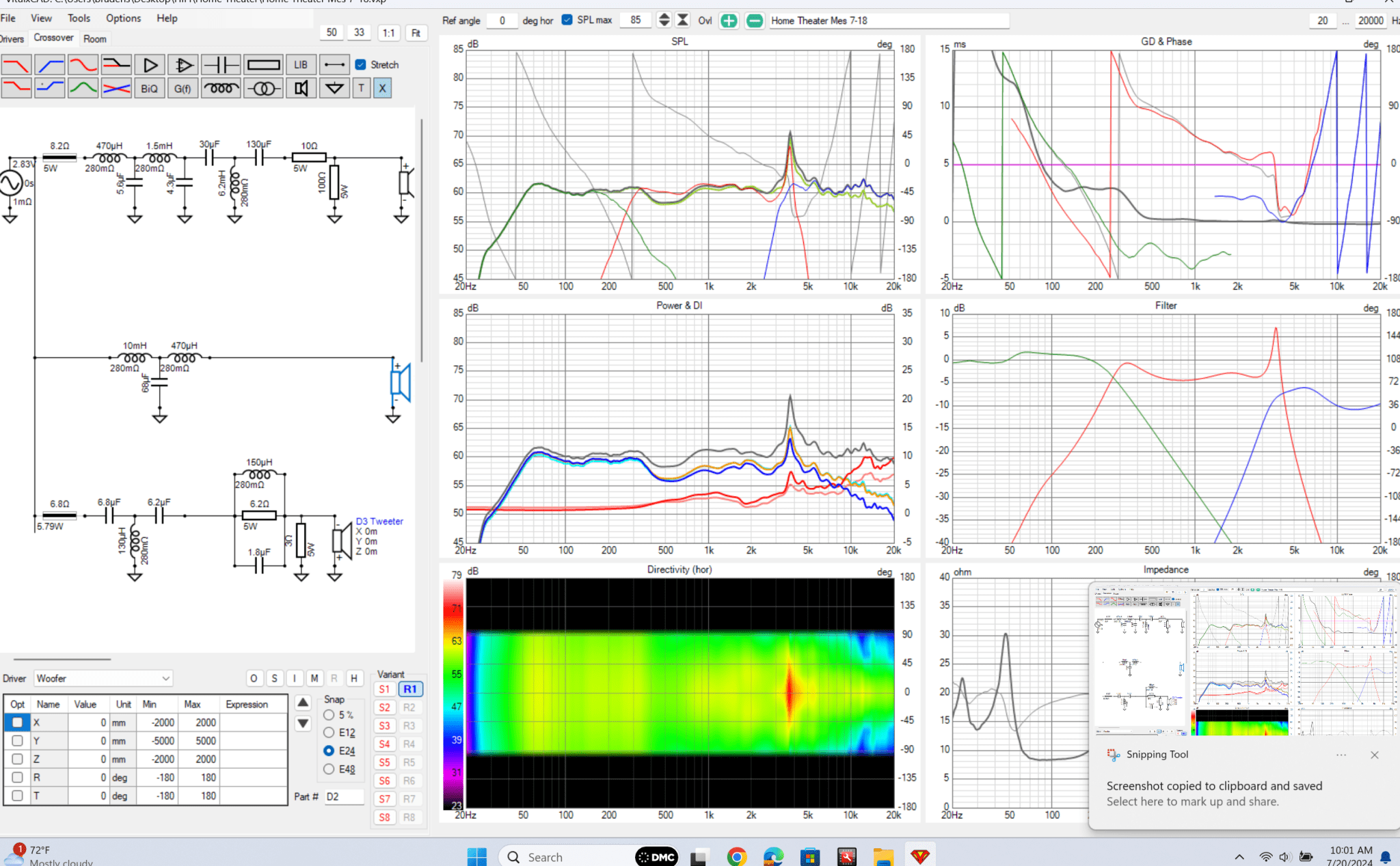

Having the resistor after destroys the whole thing. How is putting it before a fire hazard? As long as the resistor can take the wattage it will be fine. We use shunt resistors at work all the time. We are dissipating far more energy than this.
Having the resistor before the filters is going to give it the entire frequency spectrum and will cause it to have to dissipate a lot more heat. I would definitely put them after the filters and then redesign the filters. Having a single resistor after the filters changes the impedance that the filters see so their values will have to be different to get the same frequency response but this is much better practice.
It might also still be useful to have a resistor in shunt with these since that creates an L-Pad, which leaves the filters seeing the same impedance as the driver. But at this point you're getting a lot of differing advice and I'm sure that's frustrating. Maybe we should go back to discussing the port and redesigning the box. hahahaha.

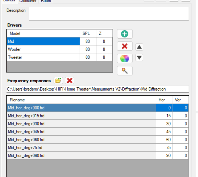

Yeah that looks better than what I made. I'll attach the baffle dimensions. I actually tried to change the y axis but it doesn't show up in my driver box. I'll post a snapshot of that too. For some reason it only gives me SPL and Z. I watched a video where someone was changing the y values on the drivers but my screen doesn't look like that.
