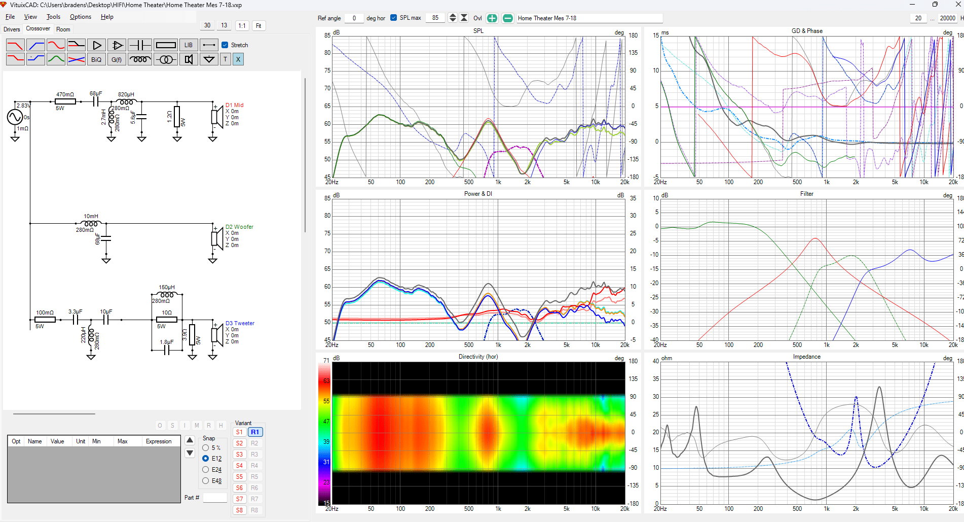

I notice any time I try to design a bandpass filter wide it starts to sag in the middle. Is this just the nature of a 4th order bandpass filter? I have to go up to a 6th or 8th to avoid the sag?
See purple oval in the filter section.
It's possible that the sag in the middle is related to the hump on each end. The "Q" of the filter is wrong. For the high pass filter section there will be a capacitor (68uf) in series then an inductor (2.7mh) in parallel. Changing the value of the inductor will change the Q and should both lower the hump on the end and raise the sag in the middle. Same goes for the low pass filter at the top. There is an inductor (.68mh) in series than a capacitor (6.8uf) in parallel. Changing the capacitor value there will change the hump and sag. This can get very complicated with a mid range driver since the closer you get with these two filters, the more they will affect each other. I also agree that the L-Pad should go after these filters (closer to the speaker). I also second the point that you have a phase issue with your woofer and mid driver. Try swapping the polarity on the woofer to see if it sums better. Though, the problem might just be the slope of the high pass filter on the mid woofer so it could get better once you correct the hump and sag.

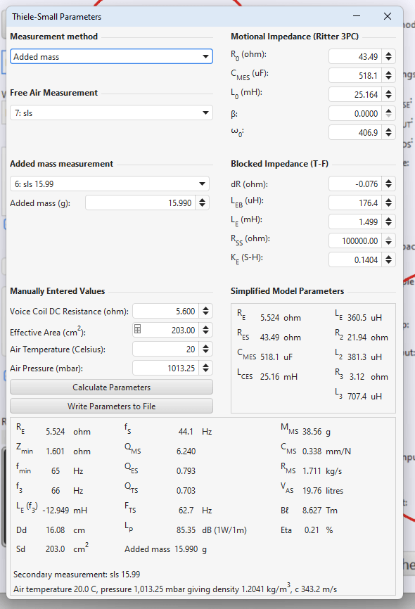

Yeah, enough with the port talk. I am not rebuilding this enclosure. Here are the actual measured parameters. I'm going to try to tun it lower just to see what happens. Cost me $12 worth of filament to try. No big deal.

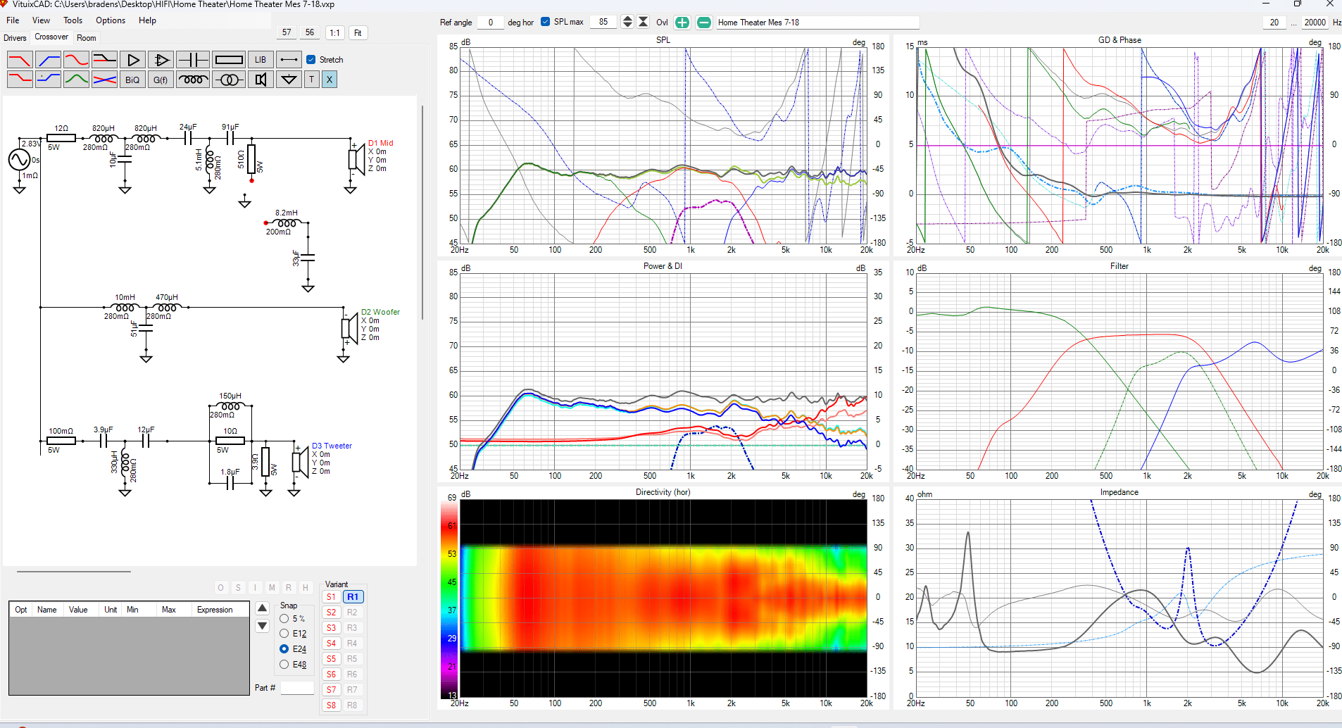

Why 3rd order the woofer and the mid? I inverted the woofer.
I honestly know nothing about the phase alignment. Can you trace out and give me an idea of where I want the phase to be? I need it explained like I'm a 7 year old with an engineering degree lol. I don't know what to even look at.
Picture is just where I am so far

You don't have to, just remove the port and make it closed. By my calculations, with your measured specs (which aren't far off from the datasheet), a closed box of the size you have, well stuffed and assuming Re=0.28 ohm will give you a Qtc = 0.77, which is not bad at all, and F(-3) = 46Hz, which again isn't bad for the box size and better than it looks given the gentler slope of the closed alignment, F(-10) is 28Hz (a reflex box with that F(-10) would have an F(-3) of about 37Hz). This is indeed a woofer intended for a closed box and it will work and sound best in one.

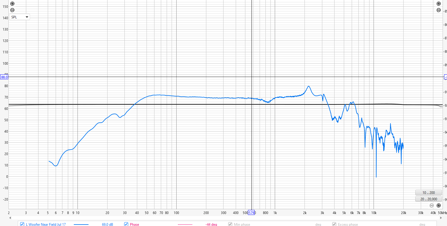

Attached is the woofer response by itself. Its not bad at all even with the hole in it. Will be interesting to see the difference between it having it plugged and it not having a giant port hole in it.

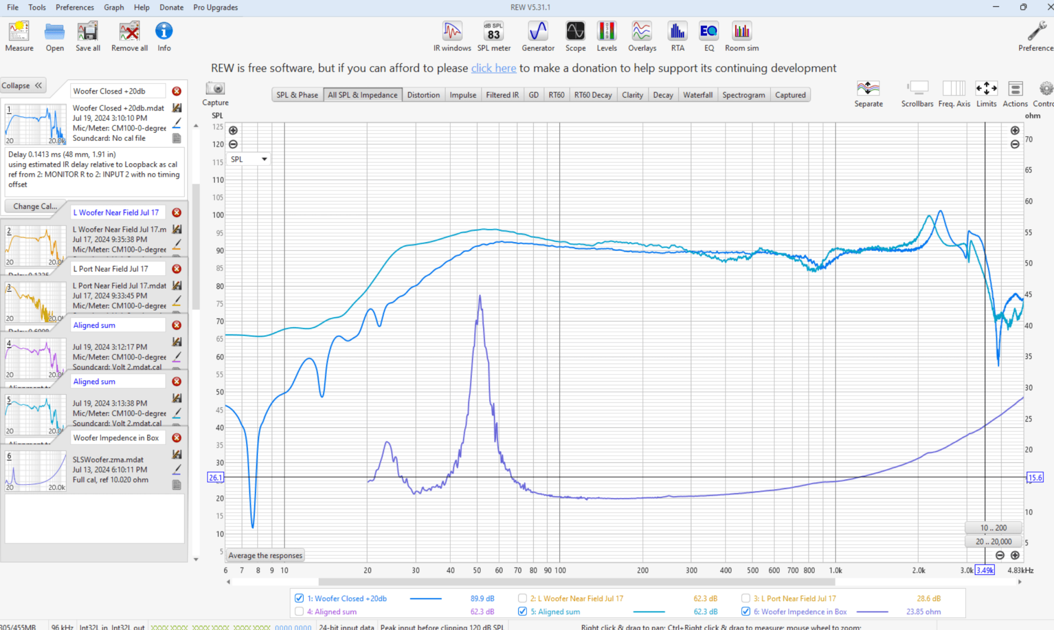

Alright so here is the port closed vs ported (ported is the aligned sum of the woofer and port). Idk, none of them are perfect. I'll likely keep it sealed for regular use and just stick the port in if I want to crank it up some day.
It doesn't seem like its going to affect the crossover. At the XO frequency nothing changes.

OK. For phase alignment, you're going to be looking at the points where the drivers crossover (plus above and below that point). From woofer to mid you're going at about 350Hz. From mid to tweeter you're at about 2600Hz. To check if they are in phase at the crossover point, they should sum about 6db louder at that point. So the woofer and the mid-woofer should both be at -6db at that crossover point and the measurement that you take of all of them together should sum there to be 6db higher. Same with the mid woofer and tweeter. Sometimes it takes different combinations of 1st, 2nd, 3rd or 4th order filters to get them to properly sum.
When you're looking at just the mid woofer frequency response and parts of it are louder by itself than they are when the woofer and tweeter are playing then you have a phase problem. In essence, nothing should get quieter when there are more speakers playing. So if part of the low woofer's frequency response is louder by itself than when the mid is also playing then you have a phase problem. It's similar to when you flip the polarity on the tweeter and there is a massive hole at the crossover point. That means it's out of phase.
In your earlier graph there was an area around 250Hz-1Khz where the mid woofer was louder by itself than with the other drivers. That means that the phase is incorrect and they are cancelling each other out. So you will need a different "order" of filter there along with the possibility of polarity inversion. Your last graph looks a lot better and they seem to be summing properly. I'm doing my best to explain this. Let me know if you have questions.
