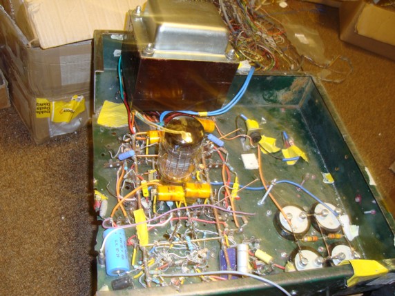

For all new to tubes!
So when you are working on or building a project.
Please ensure you fit discharge resistors to your project!
A good safety feature is to fit a 1M ohm 2-3Watt across your HT supply it will give a slow discharge should you have a break and start work on your project assuming you have discharged your HT! It may save you!
The golden rule test before you touch!
Those that already know take precautions!🙂
