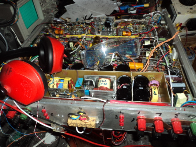

Adage....Please use safety glasses and ear protectors.
Photo: 200+200W tube power amp currently in build: PFC box as part of the power supplies of the B+ 300-600V rated at 1kW.
richy

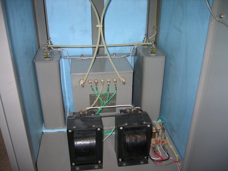

Not really audio related, but definately HIGH VOLTAGE related. I'm used to building Amps with large tube's and very high Voltage. With this stuff there is no second chance so my rules are extreme. The Voltages in this are 4850 Volts at 1 Amp (Plates of the 4PR1000B's) Filament of the tubes, Start current (cold filaments) 100 Amps+, run current, 42 Amps at 7.5 Volts. Input AC 240 Volts 40 Amp Mains.
So.....Power disconnected before any service, this includes the mains. All High Voltage is bled off with a Large bleeder resistor at the end of a insulated pole,(4850 Volts.) After they are bled off, the Main filter caps are shorted with a jumper, then aligator clip shorted while servicing.
When dealing with high Voltage, always be the safest you can be. Whether it's 450V on the plates of some 6L6's or 150V on a 12AU7's plates....or in this case 4850V on the plates.
Here is a picture of the power supply (for those interested) The 2 big square blocks with the ribbed glass insulators, on each side at the rear are the filter caps.
Picture resized and attached by moderation.
