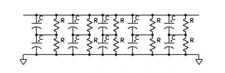

A few things:
First, you probably don't want the first filter cap to be all that huge. Big input cap = high ripple currents = bad juju. 47u (four in series parallel) is more than adequate in that spot. Save the others for use downstream.
Second, you only need to have one set of resistors to balance the voltage. All of the "middle" junctions are at the same potential so can be connected together. That will simplify things greatly.
Third, the equalizing resistor values aren't too critical. 100K/2W will be fine.
Fourth, try to use high temperature rated caps.
