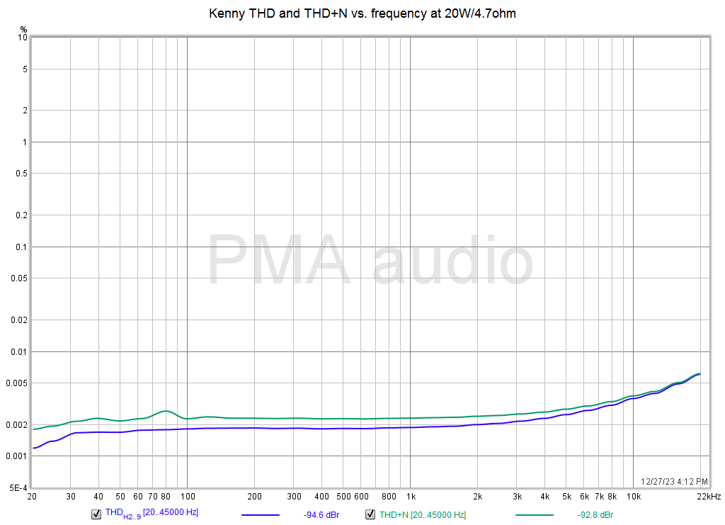

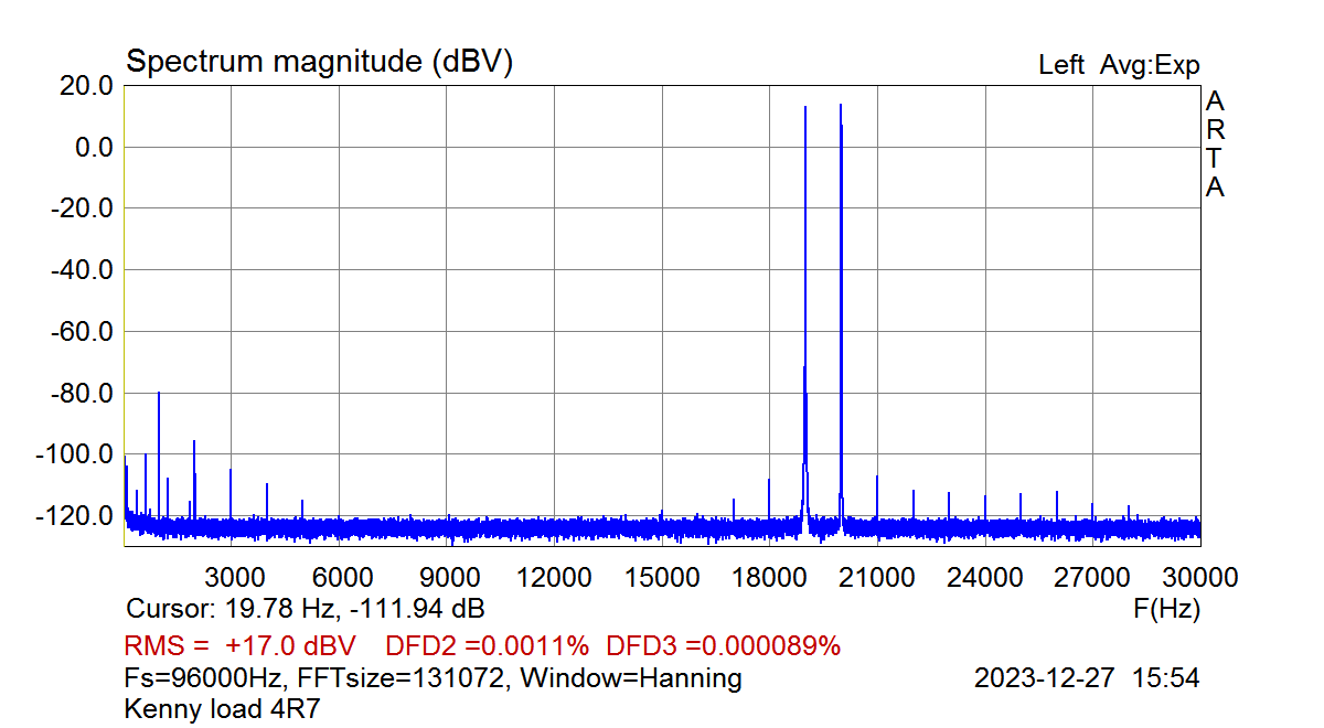

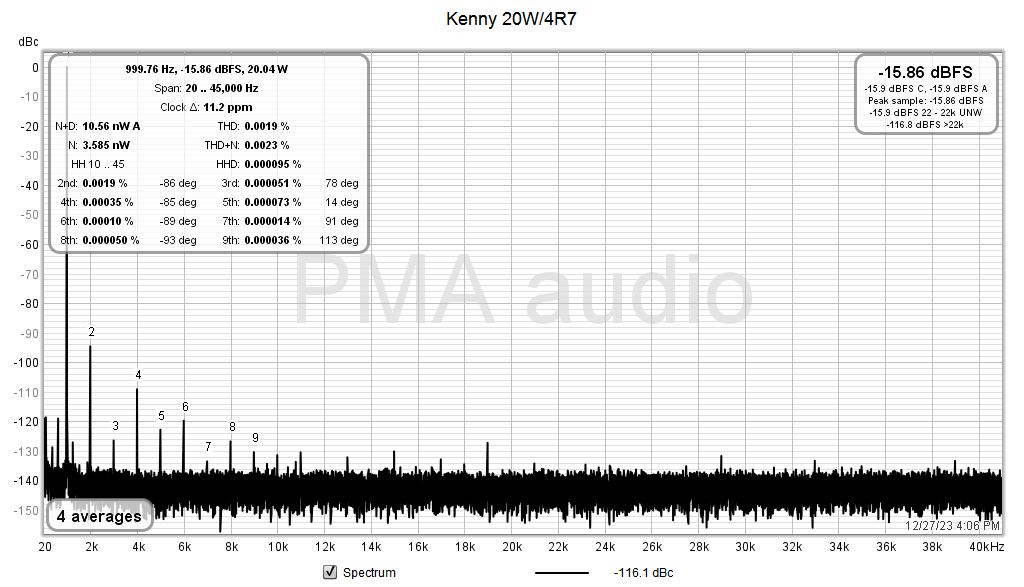

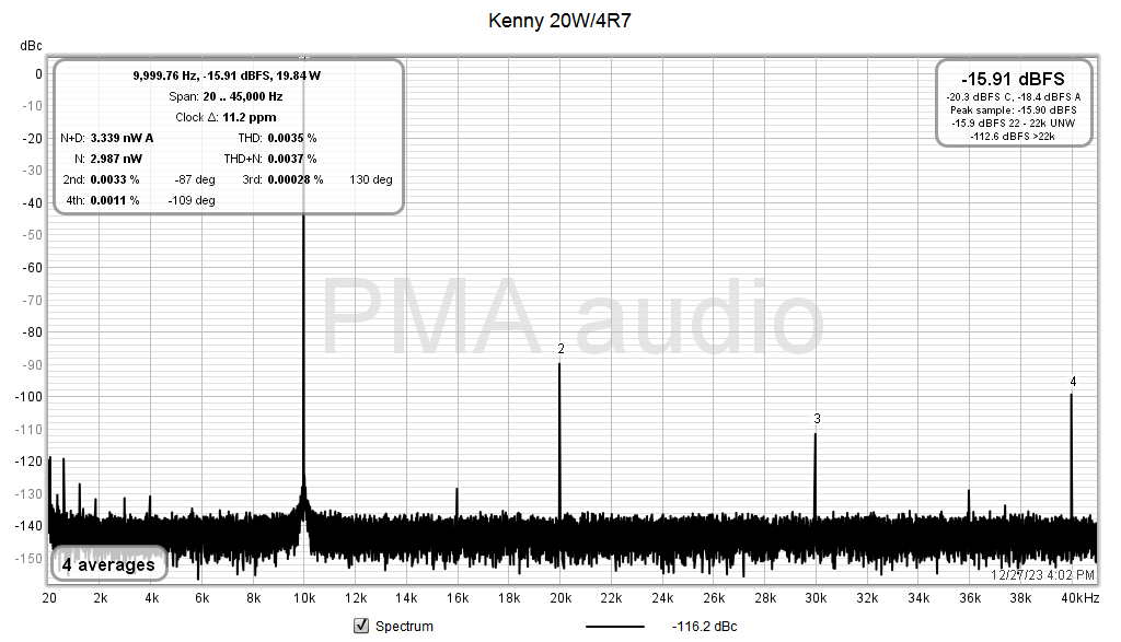

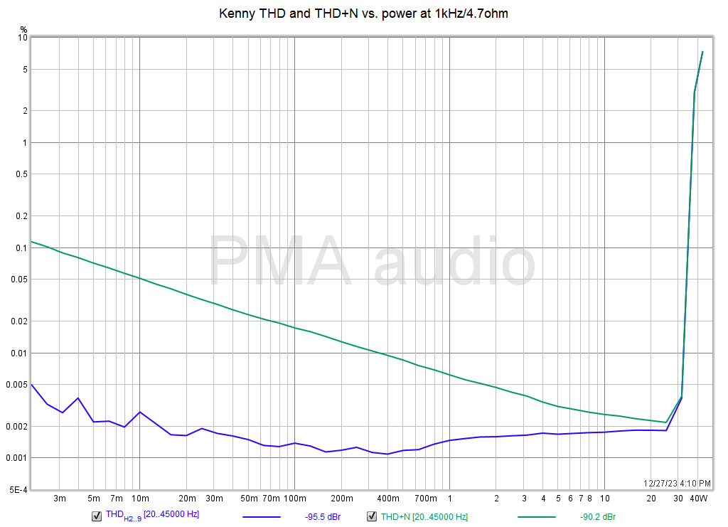

The thread has been covered in dust but I think it is an interesting topology that is worth mentioning. Here are some new measurements made with a common 2 x 25V power supply with bridge rectifier and capacitor filter.
THD 1kHz Dec 27 16_01_44 Kenny 1k 20W 4R7.png THD 10kHzDec 27 16_01_44 Kenny 10k 20W 4R7.png
THD+N vs. power Stepped THD Kenny thdlevel 1k .png THD+N vs. frequency Stepped THDfreq Kenny 20W.png
All the plots are measured, NOT only simulated.

You like to measure final designs and so do I.
Arguing with subjectivists, which prime “argument” is that measurements doesn’t tell “how it will sound”, I always say that it doesn’t take one measurement (they usually quote FFT) but as many as possible.
May I suggest that you add 31 or 32 tone measurement, like is standard for DACs. It is as close input signal to real music as it gets and it tells enough about IMD for complex signals and noise floor.

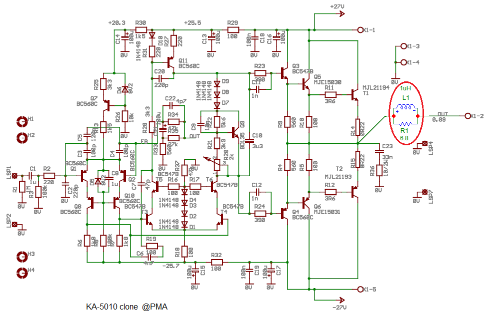

Interesting. At 20 W, 3rd and higher harmonics are really good but 2nd is not. Could this be an imbalance? The two diff pairs do not have current mirrors so their balance is at the mercy of part tolerances. Can you improve 2nd harmonic by making the Q11 current source adjustable?
What do the harmonics look like at 1 W or below? The THD vs. power plot imply an optimum at 0.1 W.
H2 level seems inherent to this kind of design, i ve played much with this topology and got about the same THD values whatever i did to improve the number, the values on the schematic are well thought overall.
A few things can be modded but they wont improve the final result, only thing i would point is that 65V BC546/556 should be used instead of 45V 547/557 for the pre drivers and everywhere else where there s a VCE that is close to the the supply voltage.

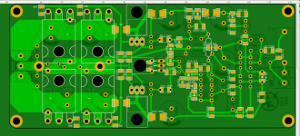

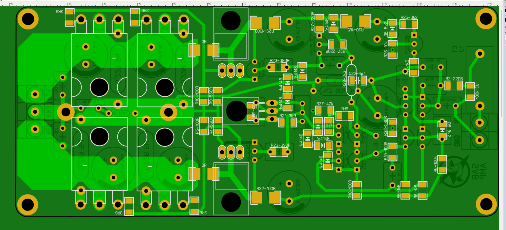

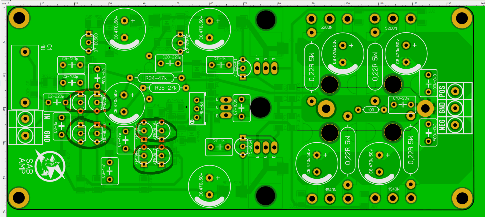

I made a sketch of the board, but I won't do it. I will have to order too many film capacitors in the correction -))
As I understand it, dedicated transistors need to be combined with thermal paste...
