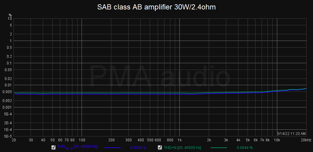

Nobody hears it, neither on music, nor on a single sine. This is again a prejudice. People are not able to tell percents of added 2nd harmonic in DBT tests, with music. Only on a sine with proper level, before the intrinsic ear distortion starts to work. I am always wondering how people were confused by the decades of audiophile brain washing.

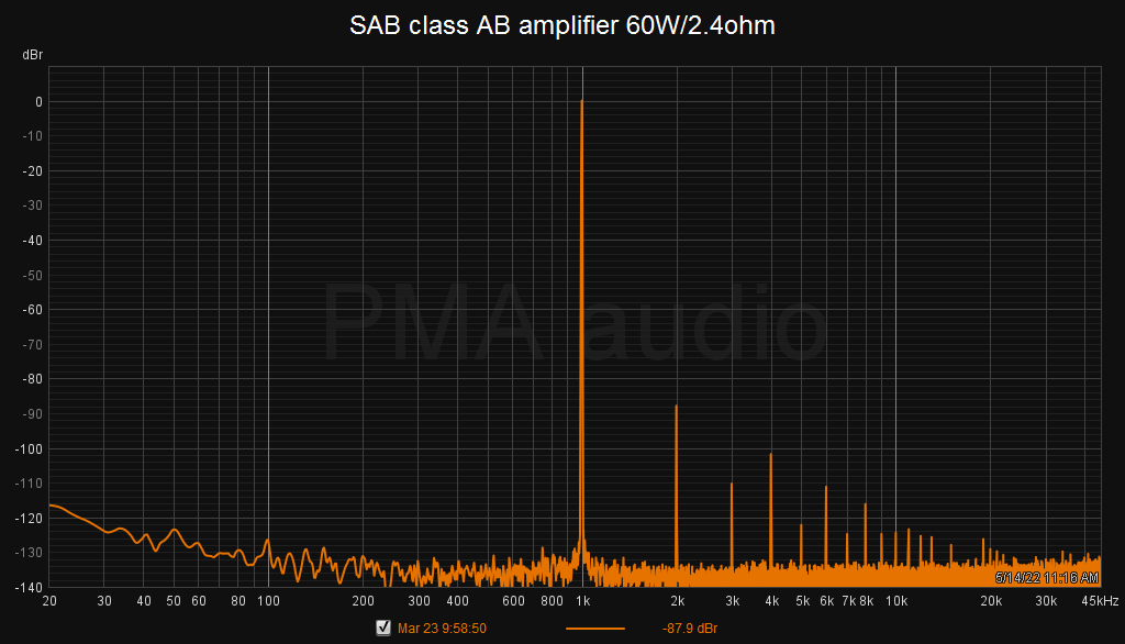

I don't doubt that -92 dB 2nd is not a problem, and it may be a wise choice to have higher even than odd order. But then pursueing the best possible performance is what some of us strive for. I am just curious what gives rise to the rather average even order performance when everything else is just excellent.
Did you ever measure the original amplifier? It might have a slightly different operating point of its differential amplifiers. It also uses more advanced small signal transistors and power devices. The end transistors are a lot faster so maybe one could get away with more aggressive compensation?
It is in fact -94dB, if you give a closer look at the spectrum and read the Y axis properly, but it is not important.I don't doubt that -92 dB 2nd is not a problem
The original is an integrated amplifier and as such cannot compare, because everything comes into game at such low distortion level.

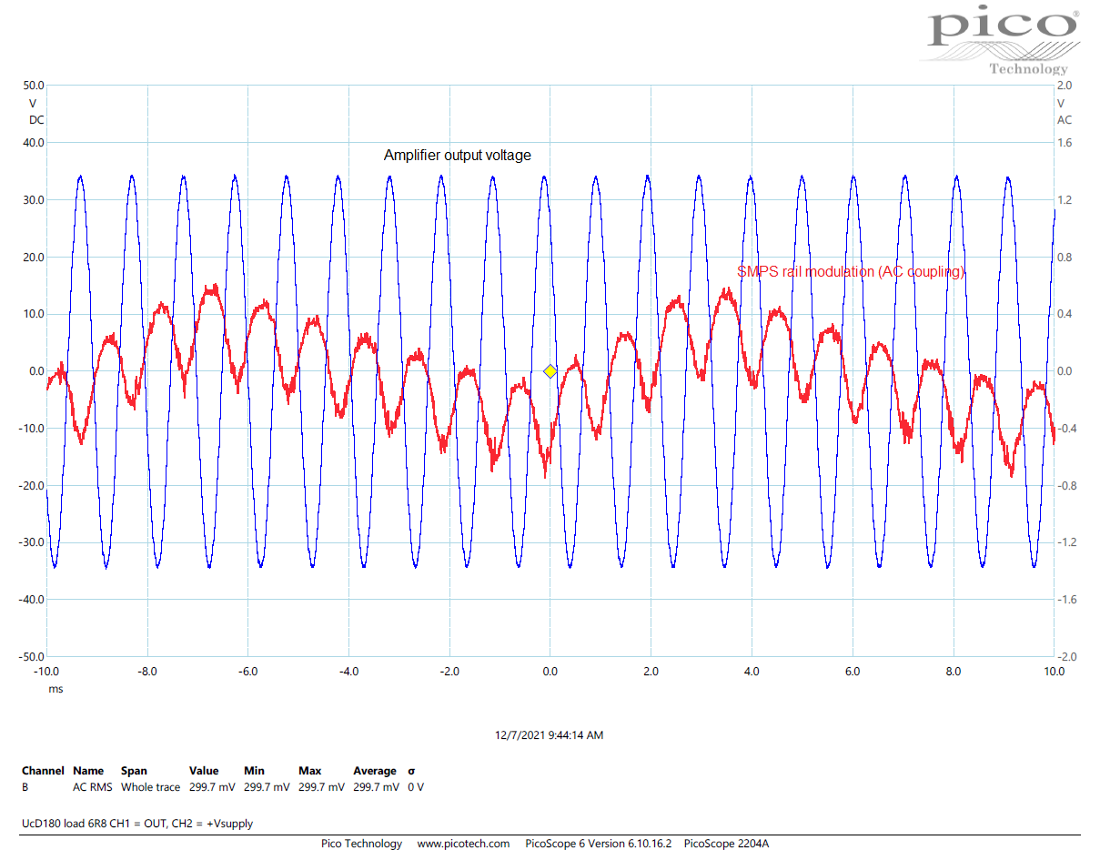

Specifically here in this project, the even harmonic distortion comes from rail voltage modulation from the input signal, modulation of rails resulting from impulse currents of the class AB output stage. With a standard transformer + rectifier + cap filter bank power supply, THD1kHz is lower (below -100dB), but high frequency distortion is higher and also distortion is more dependent on level and on frequency. With SMPS, the distortion behaviour is more consistent. Do not forget that the amplifier, power supply and wiring make the complete and unique solution. Analysis with ideal DC supplies is far from reality. All of this gets disclosed only after working on real circuits, real amplifiers.

You're right, it is close to -94 dB.It is in fact -94dB, if you give a closer look at the spectrum and read the Y axis properly, but it is not important.

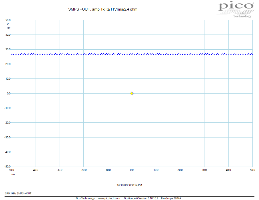

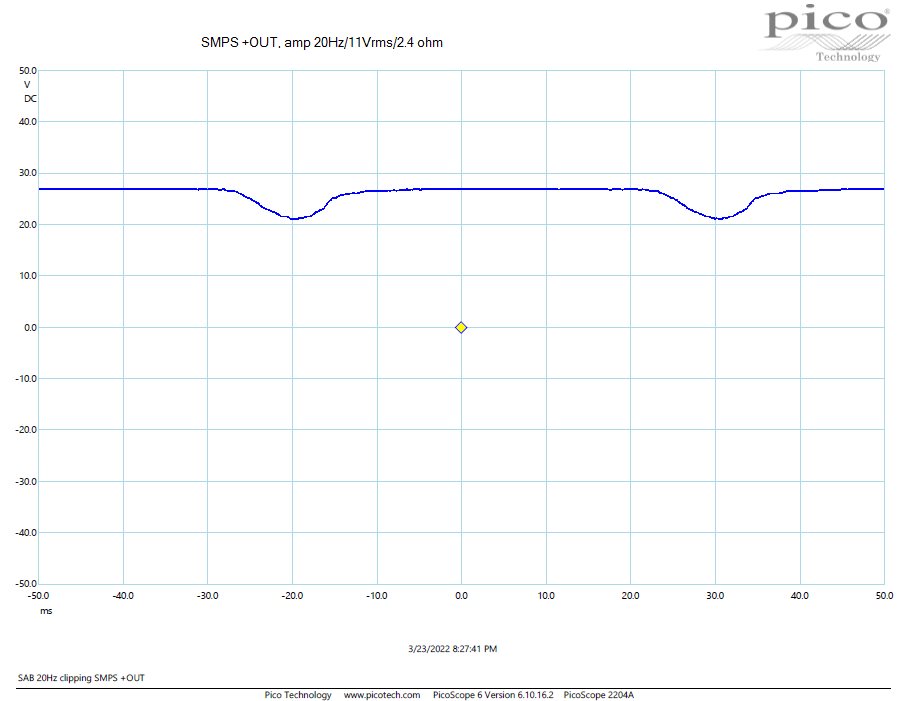

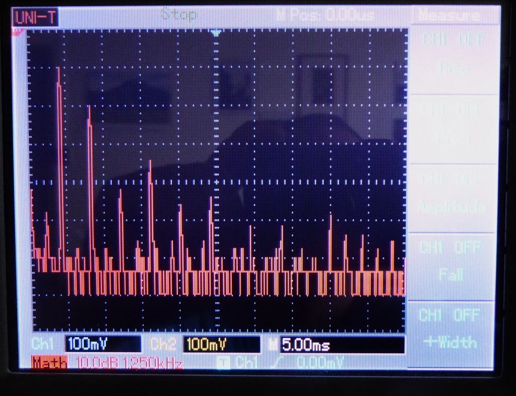

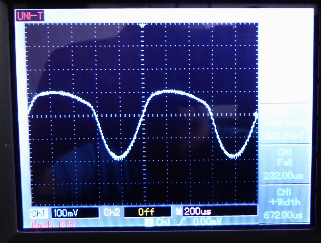

Basically it works as per attached image, but please note it is measured on another amplifier (class D) with another power (linear) supply. Rail voltage is measured AC coupled, so you can see the ripple voltage modulated by input frequency. The second and third plot show this amplifier (with SMPS) loaded with 2.4ohm with 20Hz and 1kHz signal, see the half-wave drops on the rail voltage (at 20Hz and 2.4ohm load the SMPS is close to current limit). The 1kHz plot should have been measured AC with higher sensitivity to see.
PS rail modulation by load will end in the amplifier output attenuated by amplifier PSRR. Can it be major reason for odd harmonics domination? So far, I was able to find only claims/opinion that adequate PS will not determine amplifier’s distortion.

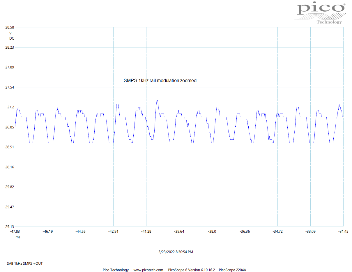

Just measured the SMPS rail modulation from 1kHz properly. Please see the time plot and spectrum attached. In the spectrum, one may see high H2 harmonic component which is supressed just by amplifier PSRR. Please note we are talking about -94dB to -100dB distortion components. Regardless this rail modulation effect on even harmonics, overall amplifier parameters are better with the SMPS than with the heavy linear power supply. It is time to leave prejudices formed by decades of audiophile discussions and popular magazine articles and reviews.
