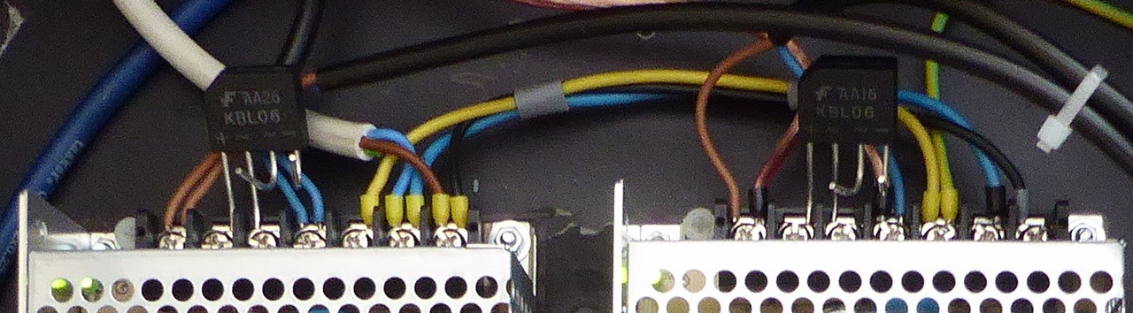

No, there is no additional filter behind the SMPS. The only and important addition is the reverse voltage (parallel) blocking diode, see the image below. Output wideband noise is attached as well (2RC filter mentioned is only to suppress scope FFT aliases).@PMA Can you share something about the SMPS that your used - why that model etc

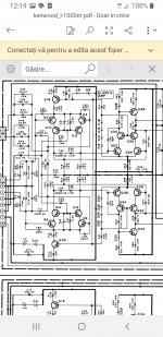

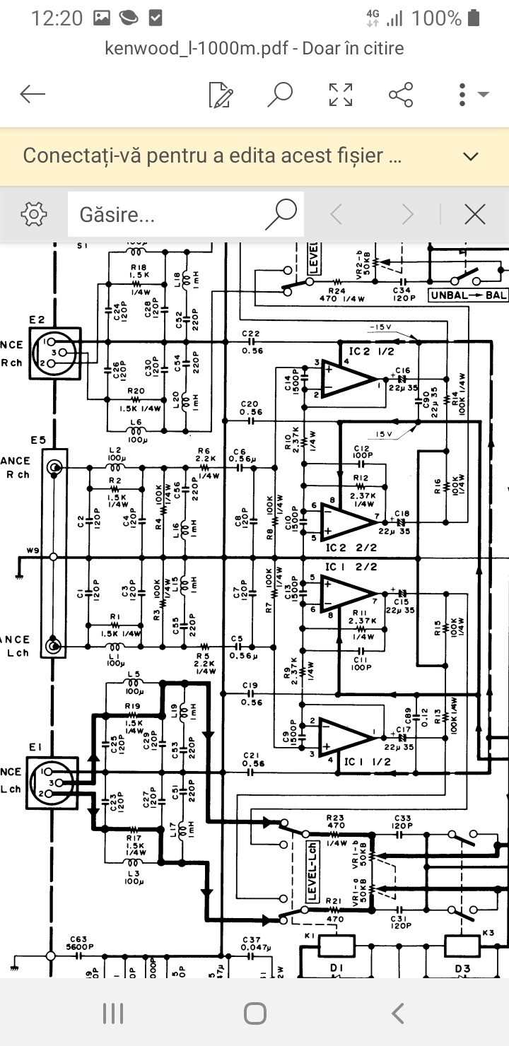

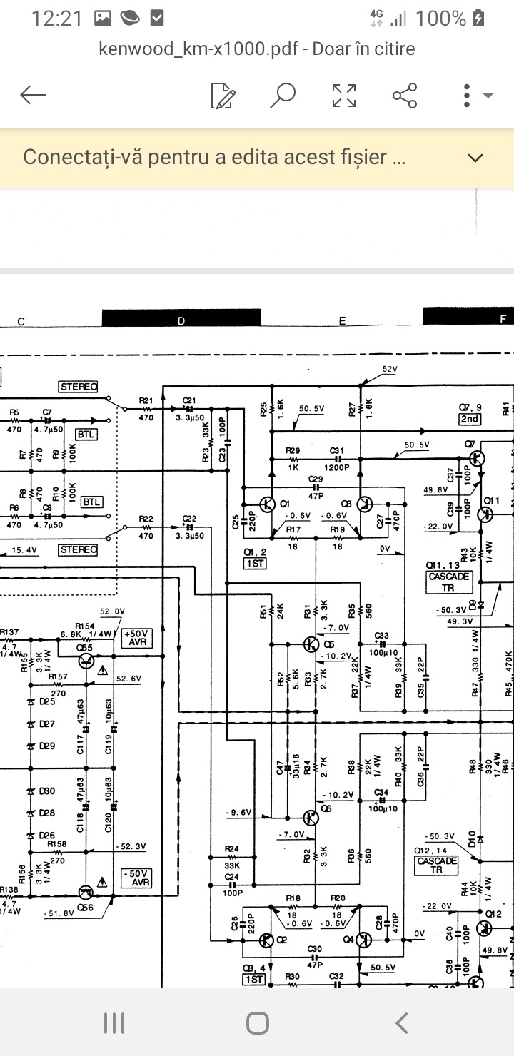

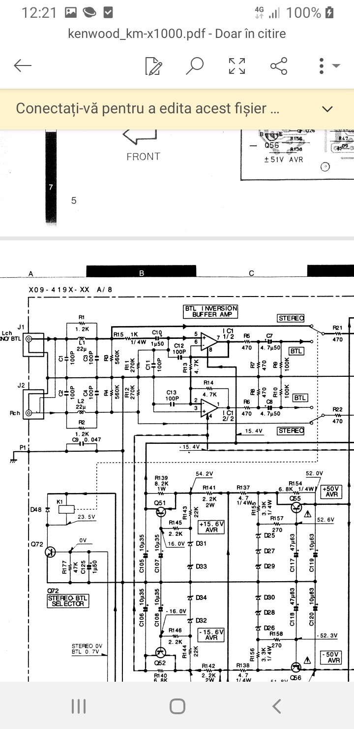

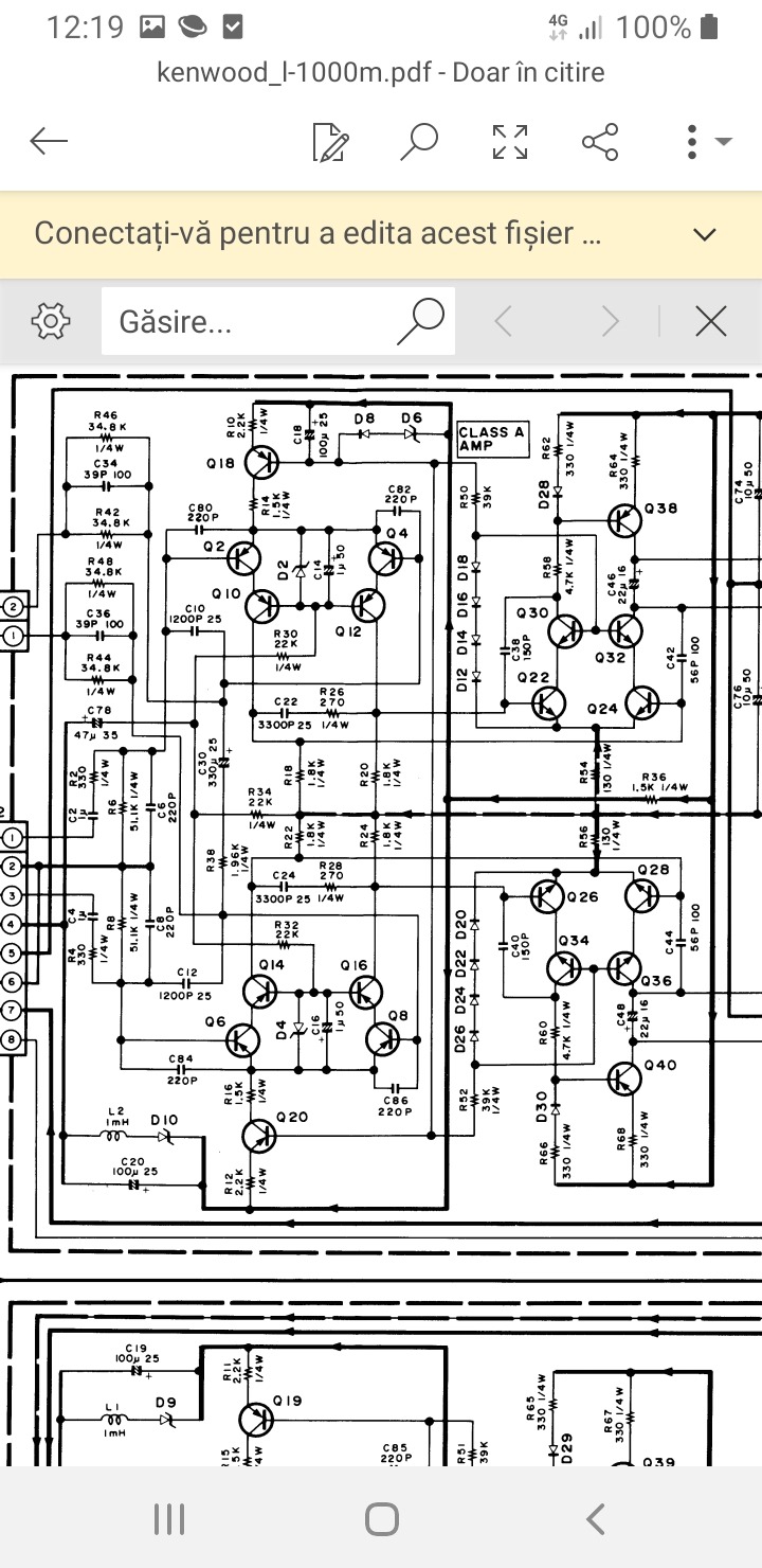

For EMI prevention in bjt input amplifiers I'd point out to bridged kenwood's best amplifiers input sections like Kenwood L-1000M or KM-X1000.I had the occasion to hear a km-x1000, one of the few 90's kenwood amplifiers to receive the Dolby THX certification.That's a Beast!I always preffered Kenwood's best designs over any other company not only for I had some of their best amp and never heard anything more neutral, but also because they had a better sense of electromagnetic interference as they were also comissioned to service USA army com equipment for decades.

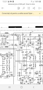

I forgot saying something really interesting I saw only in KM-X1000.It has two power transformers, but not one for each channel, instead it's using one transformer to supply the positive rail and the other to supply the negative rail as when used in bridged mode it helps delivering instantaneous power from both amplifiers preventing hysteresis effects delay due to core saturation charging the filtering capacitors too slowly. It also comutes the power line voltages to a lower value in bridged mode which is the professional way to go and I haven't seen it in other equipment, but you may point me to other simillar designs I ignored checking and I'd be happy seeing them. Also all venerable kenwood amps are using e+i transformers which I heard are better at preventing saturation than toroids just higher emi noise so they needed good shielding.
... and they have much lower primary/secondary stray capacitance and make measurably better preamp/amp combo if single-ended link is used, better S/N and lower residual mains multiples related noise due to cable shield currents.Also all venerable kenwood amps are using e+i transformers which I heard are better at preventing saturation than toroids just higher emi noise so they needed good shielding.

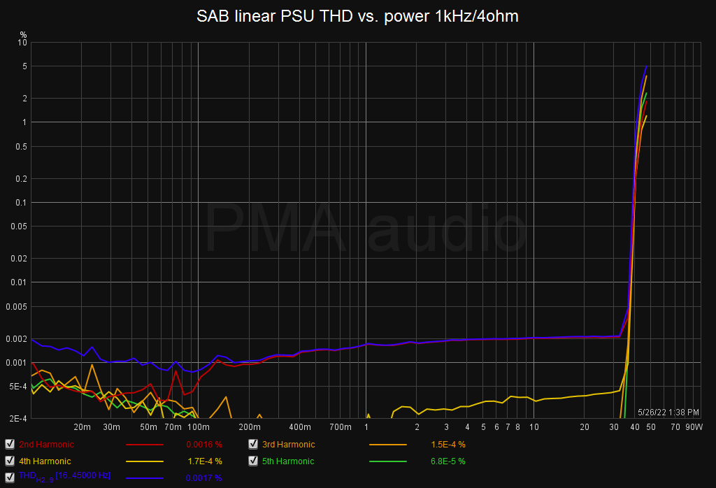

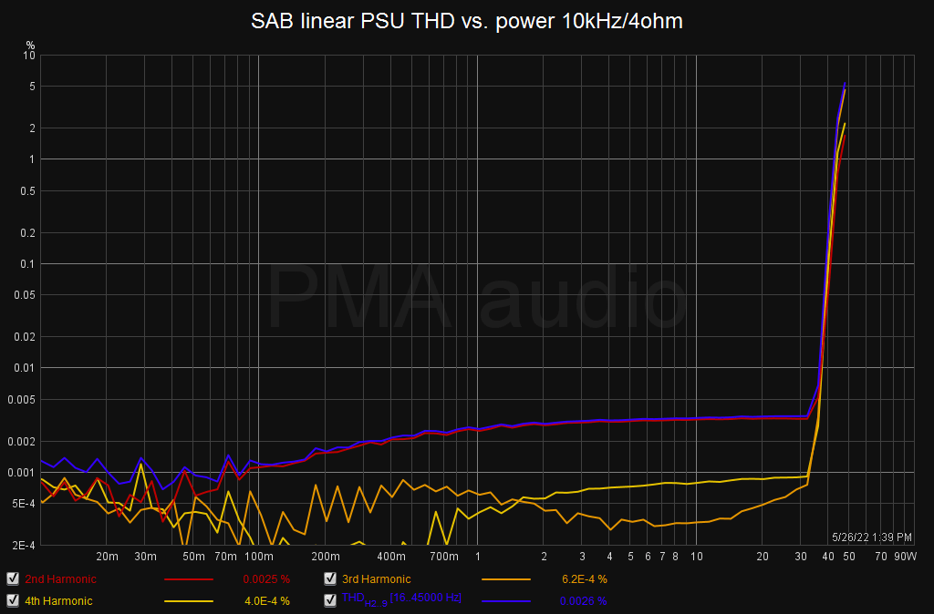

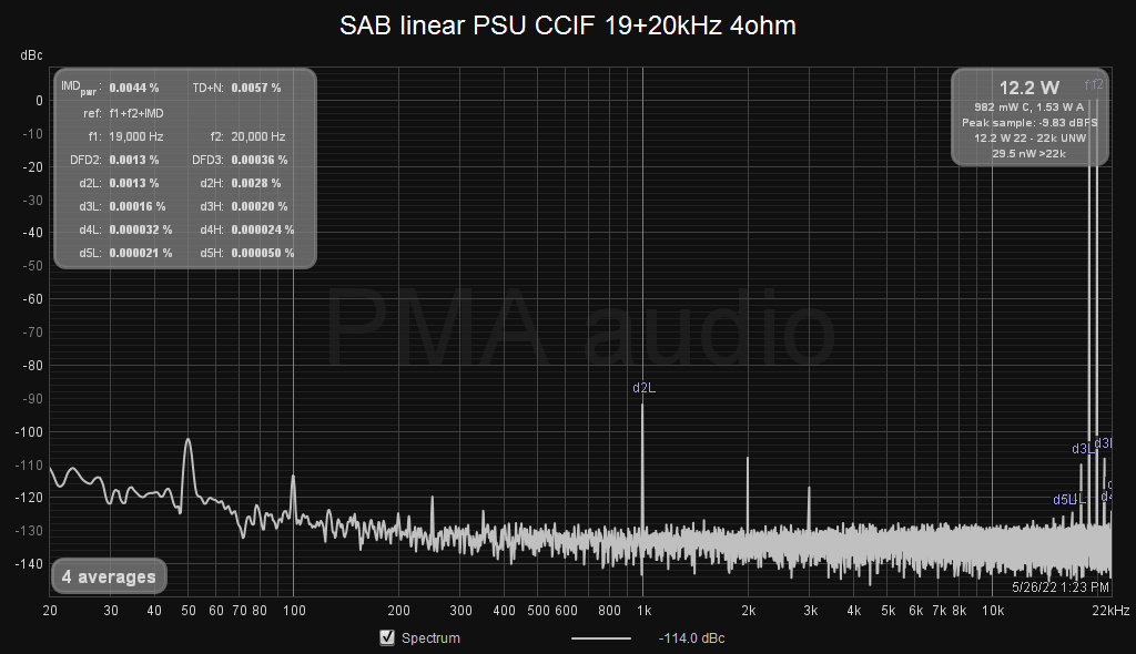

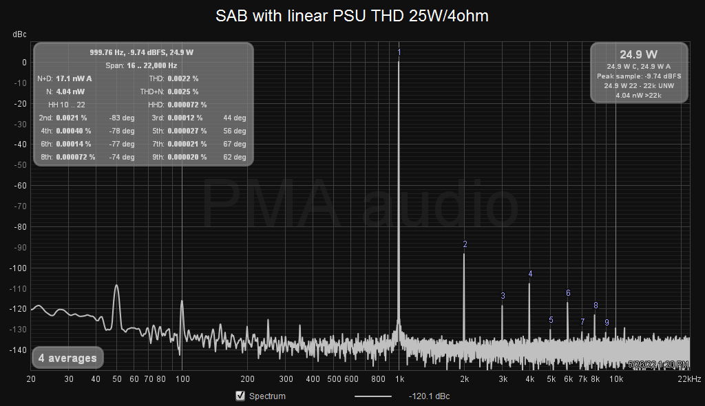

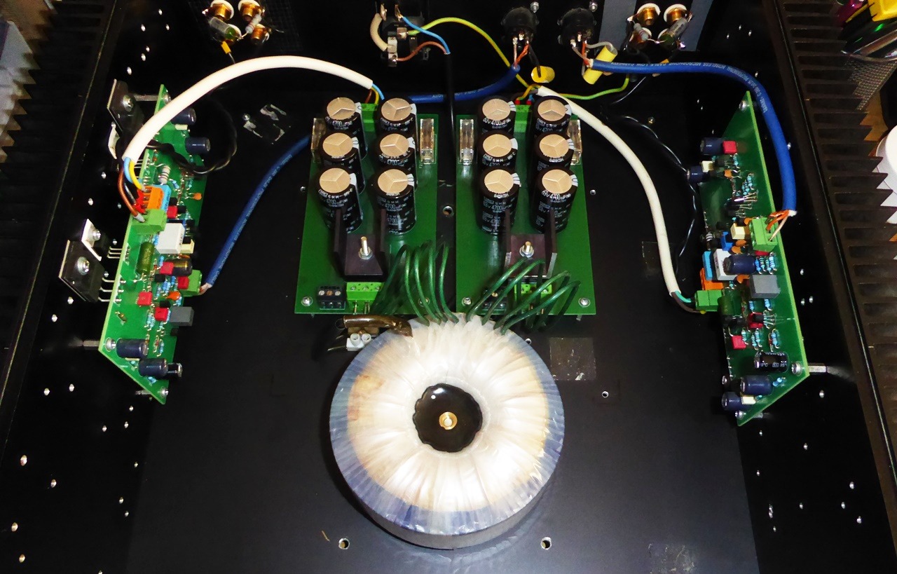

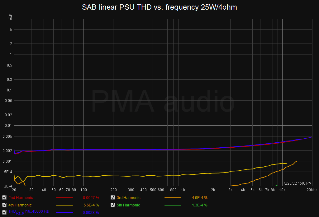

I have re-measured this amplifier with linear power supply, 2x25V, capacitor bank 2x14100uF per channel, transformer with separate secondary windings for two channels. My theory about differences in distortion between operation with SMPS and linear PSU has failed 🙂, distortion results are almost equal.
So far prevailing theory, that (good enough) PS is not affecting distortion numbers, is confirmed again. 🙂My theory about differences in distortion between operation with SMPS and linear PSU has failed 🙂, distortion results are almost equal.
Most intriguing question is why different PS, resulting in same distortion figures, sometimes result in different sounding amplifier. To exclude all sorts of supernatural hearing beings, present on this forum, there are knowledgeable members with vast experience and top equipment at their disposal, who discuss such matters. To name few, Jack Walton and audioeXpress team from the legendary power supplies test. I noticed Jack mentioning several times that they could hear rail harmonics by “bad” PS as “sound smearing” and rail harmonics were introduced by bad PS transient response.
So, it could be useful to not check PS/amp with “soft” stationery signal as 1 kHz sinewave is, but to apply big square wave signal and observe rail response and harmonics for any mayor difference between different PS. IMO, it could tell a lot about how good PS is for an audio duty.

It prevents SMPS failure from reverse voltage coming from the amp if one of the supplies starts much earlier than the other one. Yes cathode to +. Keep those diodes, they will save the supply modules and the amp as well. For more detailed explanation, please google on reverse voltage SMPS blocking diodes. BTW, such diodes are good to use even with the linear PSU, placed behind the fuses. Same reason, in case that only one fuse is burnt they will save the amp, any amp.

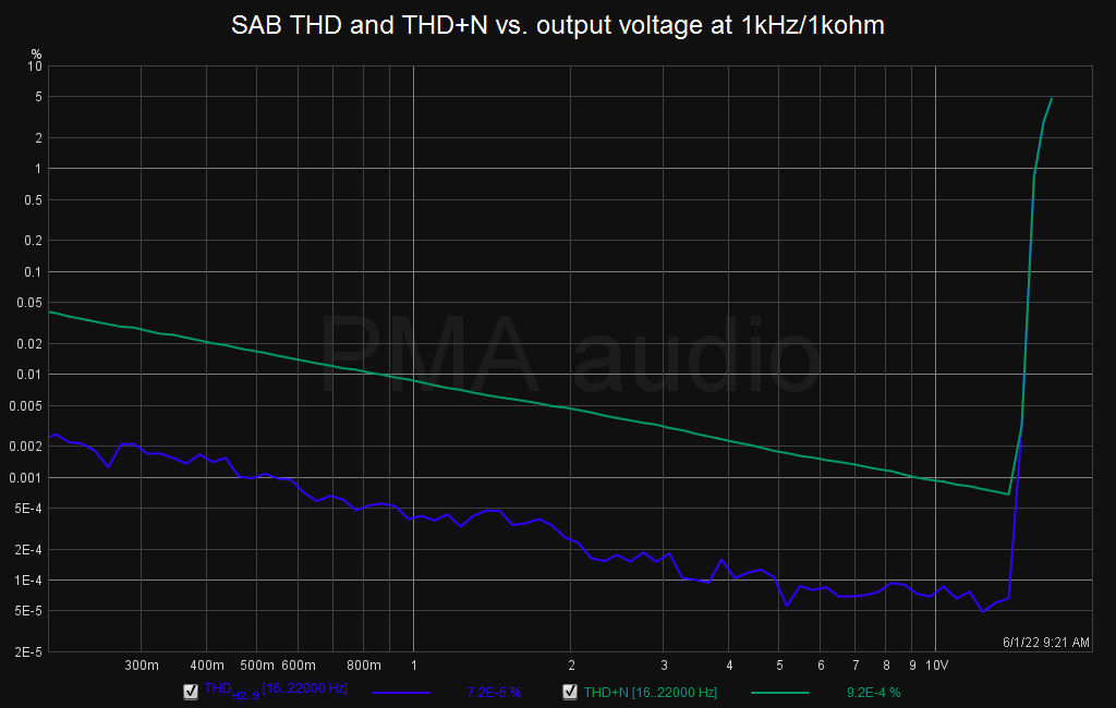

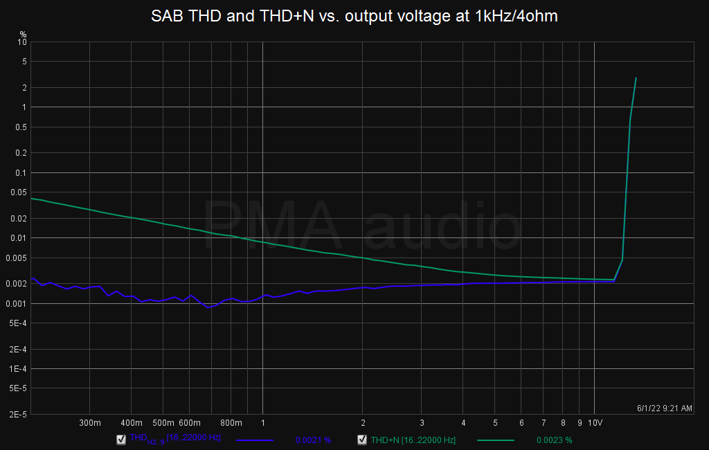

I have some new measurements using my new toy, E1DA Cosmos ADC
https://e1dashz.wixsite.com/index/cosmos-adc
It is interesting to see that in a class AB amplifier with low distortion front-end, all the distortion is solely related to the output stage crossover distortion. Please note the difference in distortion with 1kohm and 4ohm load. With 1kohm, it is better than almost any preamp 🙂.
