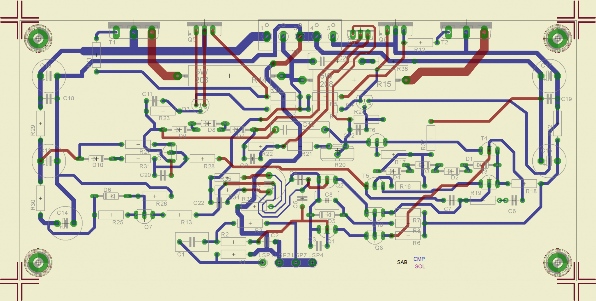

Gerber files have been released in post #25 for non-commercial, non-profit personal use

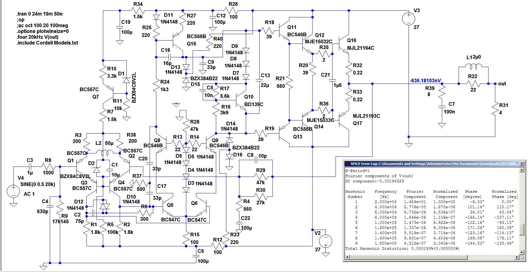

This is the circuit schematics

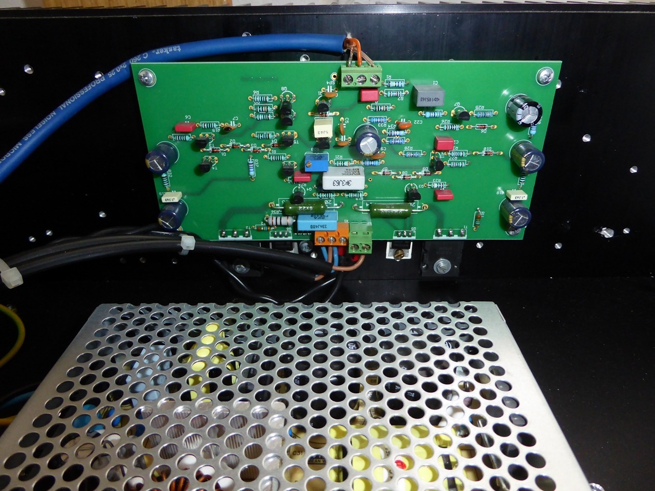

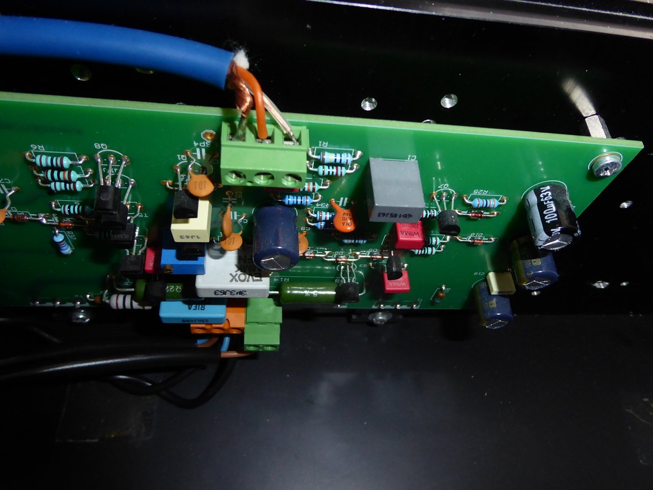

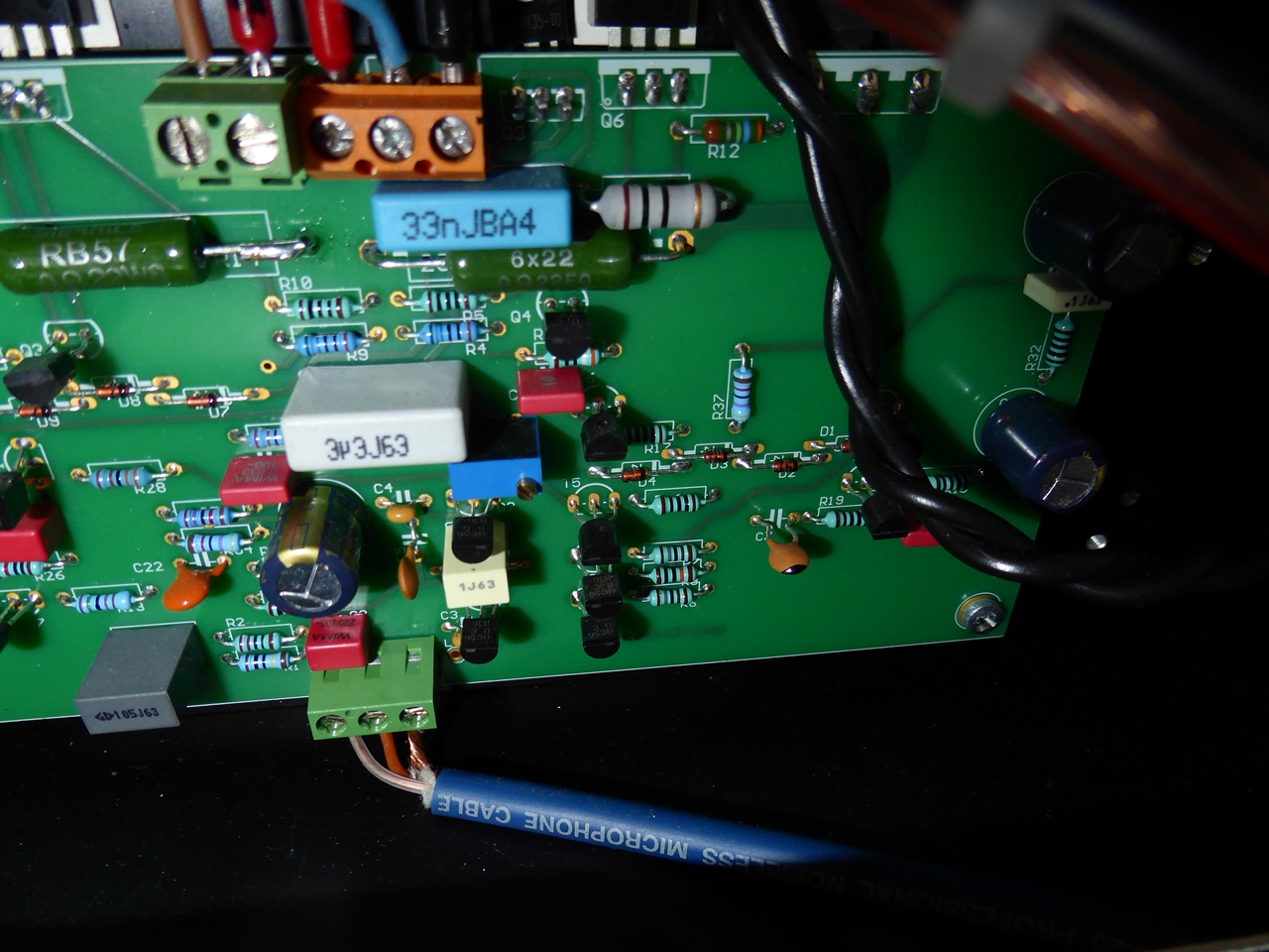

As a power supplies I used Mean Well RS-100-24 modules, one per channel. This is the amplifier DIY built in one of my prototype cases

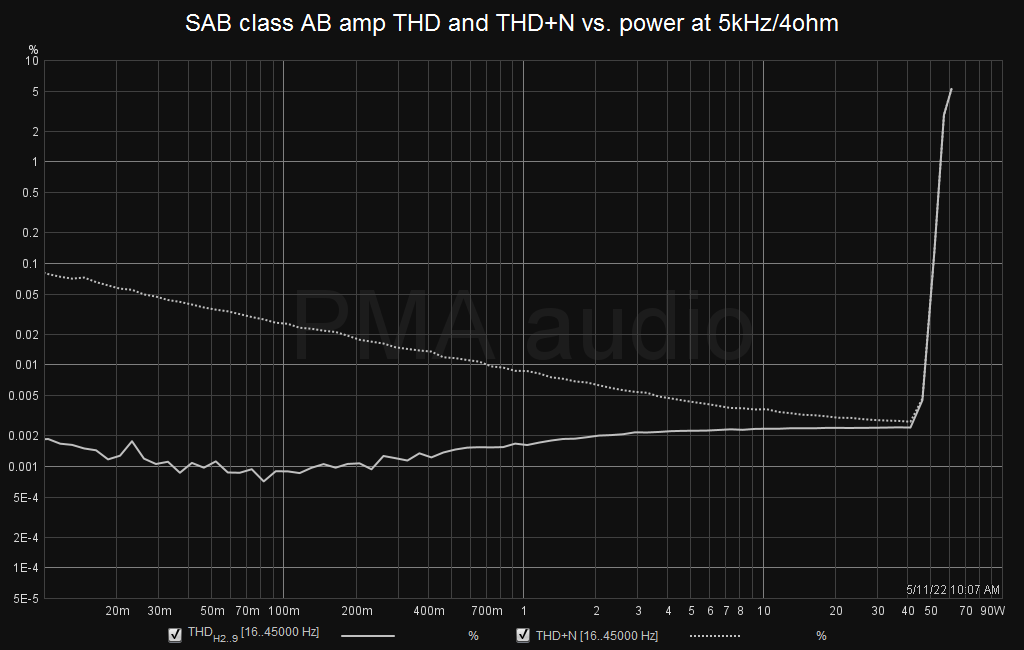

Technical parameters

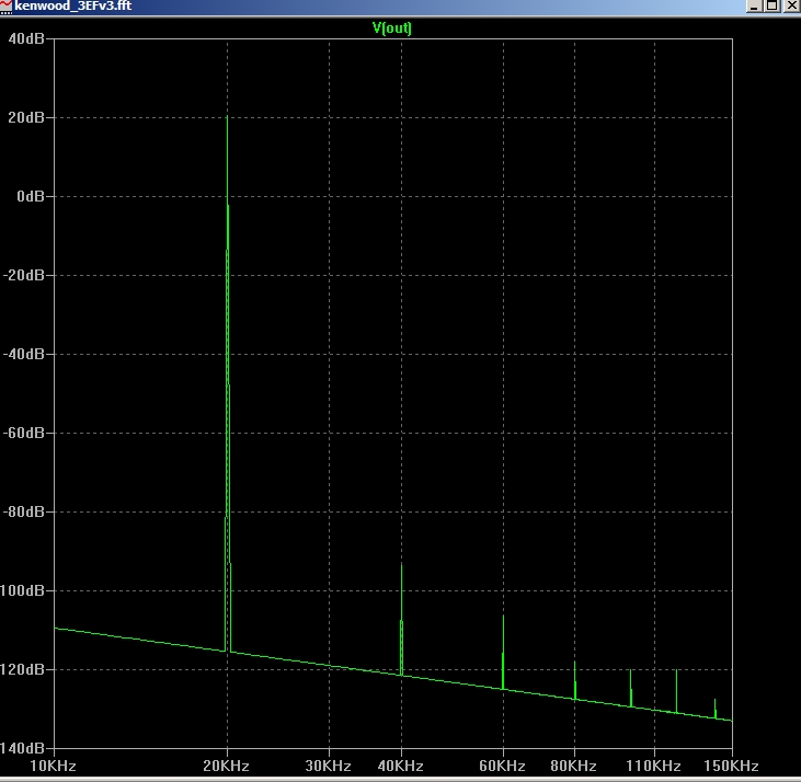

Measurements of THD and THD+N vs. output power, with 4ohm load
Measurement of THD and THD+N vs. frequency at 20W/4ohm

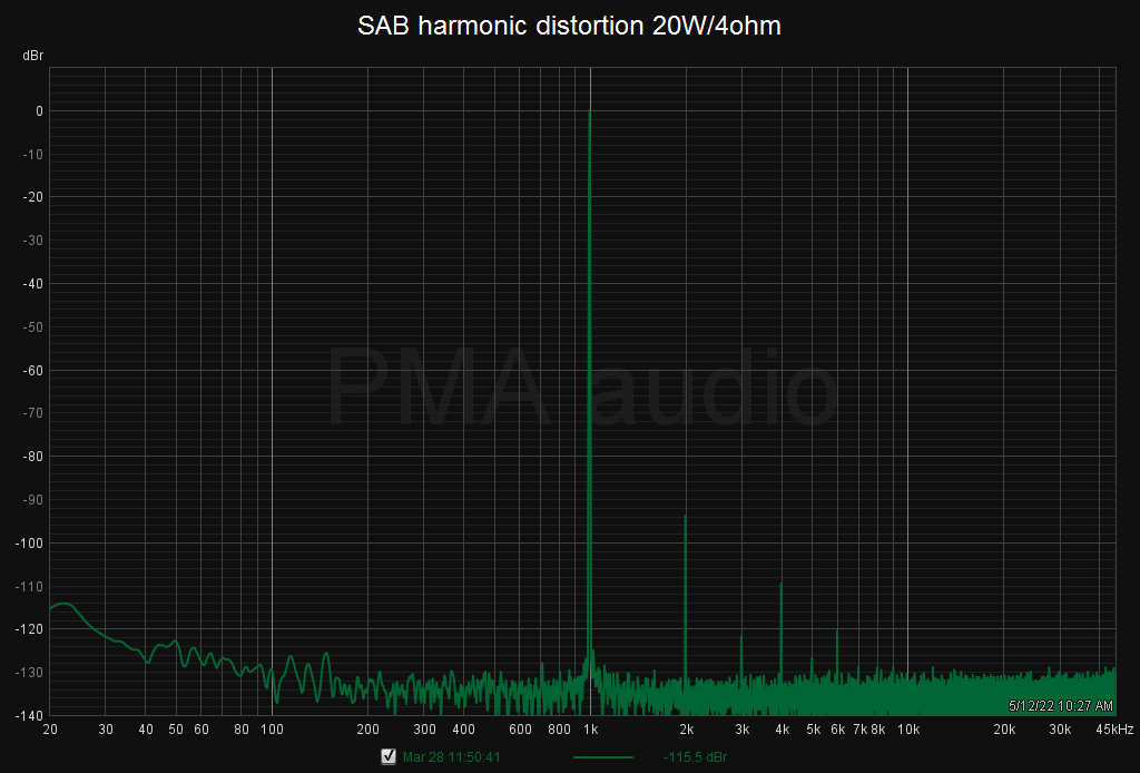

Distortion spectrum

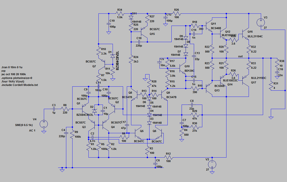

- input impedance 90kohm
- voltage gain 30dB
- output noise voltage 22uV/20Hz-22kHz unweighted
- output power 2 x 50W/4ohm
- THD < 0.002%/40W/1kHz/4ohm
- THD < 0.003%/40W/10kHz/4ohm
- minimum load impedance 2.5ohm
- frequency response 10Hz – 100kHz/0.2dB/4ohm

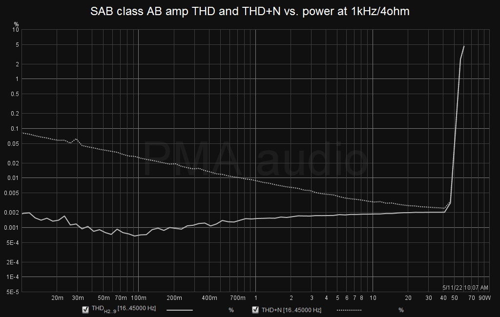

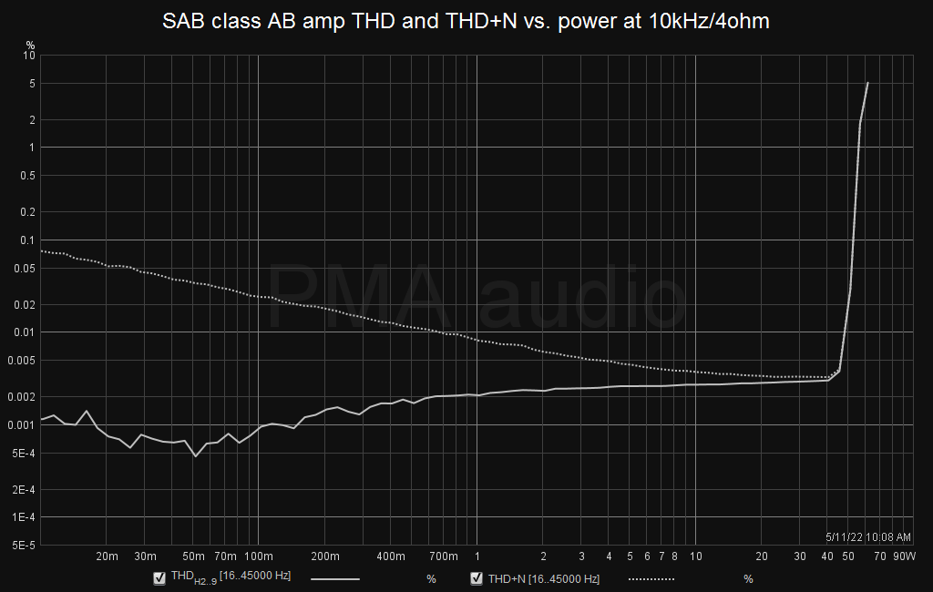

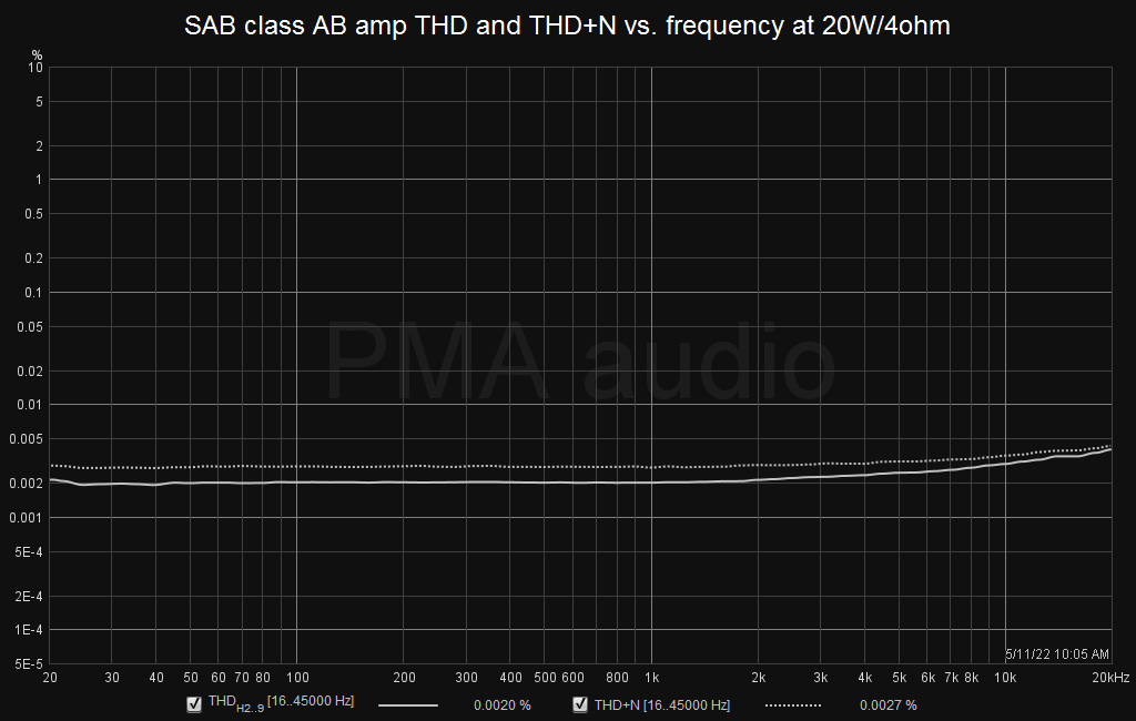

Distortion spectrum

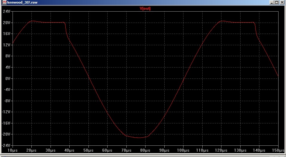

The famous circuit is Hitachi Topology. For Negative Feedback I'm misleading why position C7 & R30. This is new to me
The circuit is basically taken from Kenwood KA-5010 service manual, with some modifications. C7 (in LTSpice scheme) is a FB DC blocking capacitor. (R30//R29)/R4 make a feedback divider. R30 with R29 prevent accumulation of DC charge across C7.The famous circuit is Hitachi Topology. For Negative Feedback I'm misleading why position C7 & R30. This is new to me
Hi, thank you, yes the clipping can be improved, if one cares about clipping.Hi, PMA. I propose revision to improve the clip.
I will try this modification to my other cascoded VAS. Decreased clipping behavior when using cascoded VAS vs other standard/advanced VAS. Thank you very much for the knowledgeHi, PMA. I propose revision to improve the clip.

Hello Pavel, any chance of this PCB being made available to purchase, or supplying the gerber files. Just what I am looking for - a good 50WPC class AB amp, using easily available parts.
We shall see, normally I do not give away the Gerber files and also stopped PCB sales 10 years ago. Let's see 🙂.
Interesting. At 20 W, 3rd and higher harmonics are really good but 2nd is not. Could this be an imbalance? The two diff pairs do not have current mirrors so their balance is at the mercy of part tolerances. Can you improve 2nd harmonic by making the Q11 current source adjustable?
What do the harmonics look like at 1 W or below? The THD vs. power plot imply an optimum at 0.1 W.
At -92 dB it is probably good enough, maybe even pleasing (euphonic) but one should expect better with this kind of a circuit. Note how all the even orders are higher than the odd which points to an imbalance somewhere. Not that I'd want to have it the other way around, i.e. 3rd at -92 dB and even orders very low.
I'd rather have H3 -92dB and H2 -100dB, than H3 at the same -92dB but H2 at -70dB.
But that is my choice.
Patrick
Patrick
Nobody hears it, neither on music, nor on a single sine. This is again a prejudice. People are not able to tell percents of added 2nd harmonic in DBT tests, with music. Only on a sine with proper level, before the intrinsic ear distortion starts to work. I am always wondering how people were confused by the decades of audiophile brain washing.At -92 dB it is probably good enough, maybe even pleasing (euphonic)
Then why bother with "Small class A amplifier with THD below 0.0001%" ?
Patrick
Just for fun, nothing else 🙂. Regarding audibility, there is no difference between these 2 amps and nobody would tell a difference in a properly matched DBT test. In a sighted test, everyone hears everything, better say just thinks so. Such is audio🙂.
