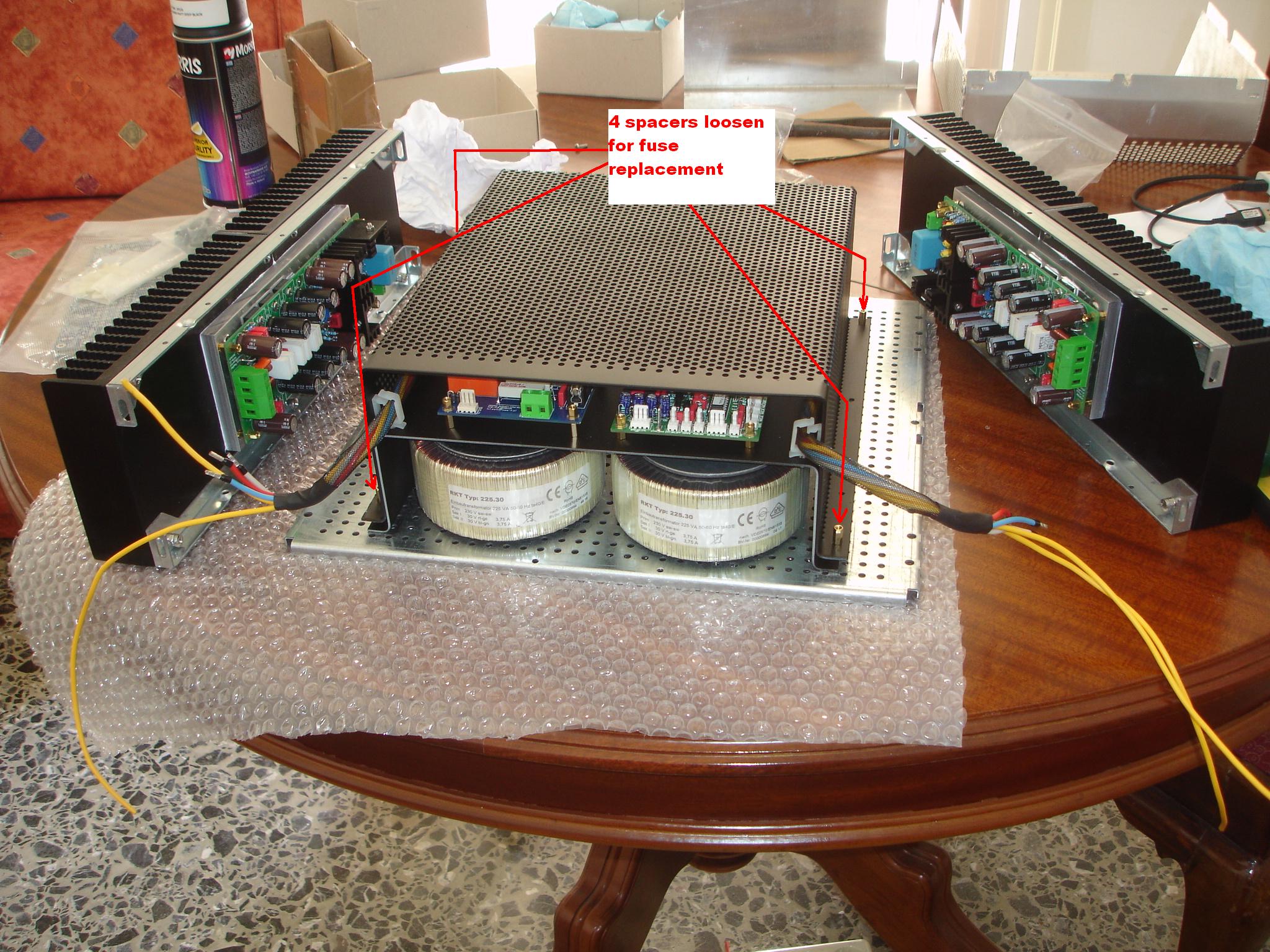

Bravo Thimios, it's a great job!
Just one thing, if your fuses are breaking make sure you can change them easily.
Easy fuse replacement.

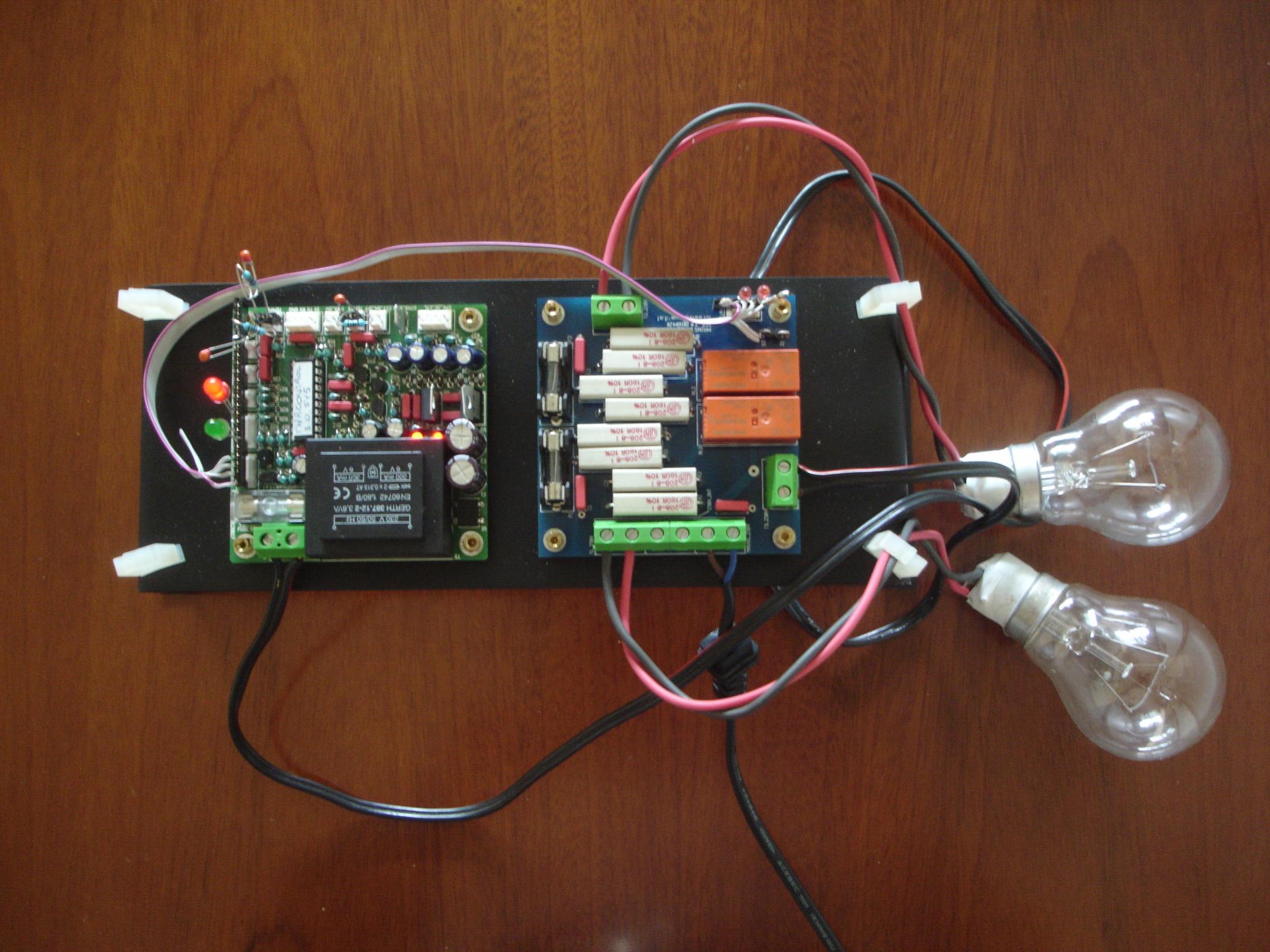

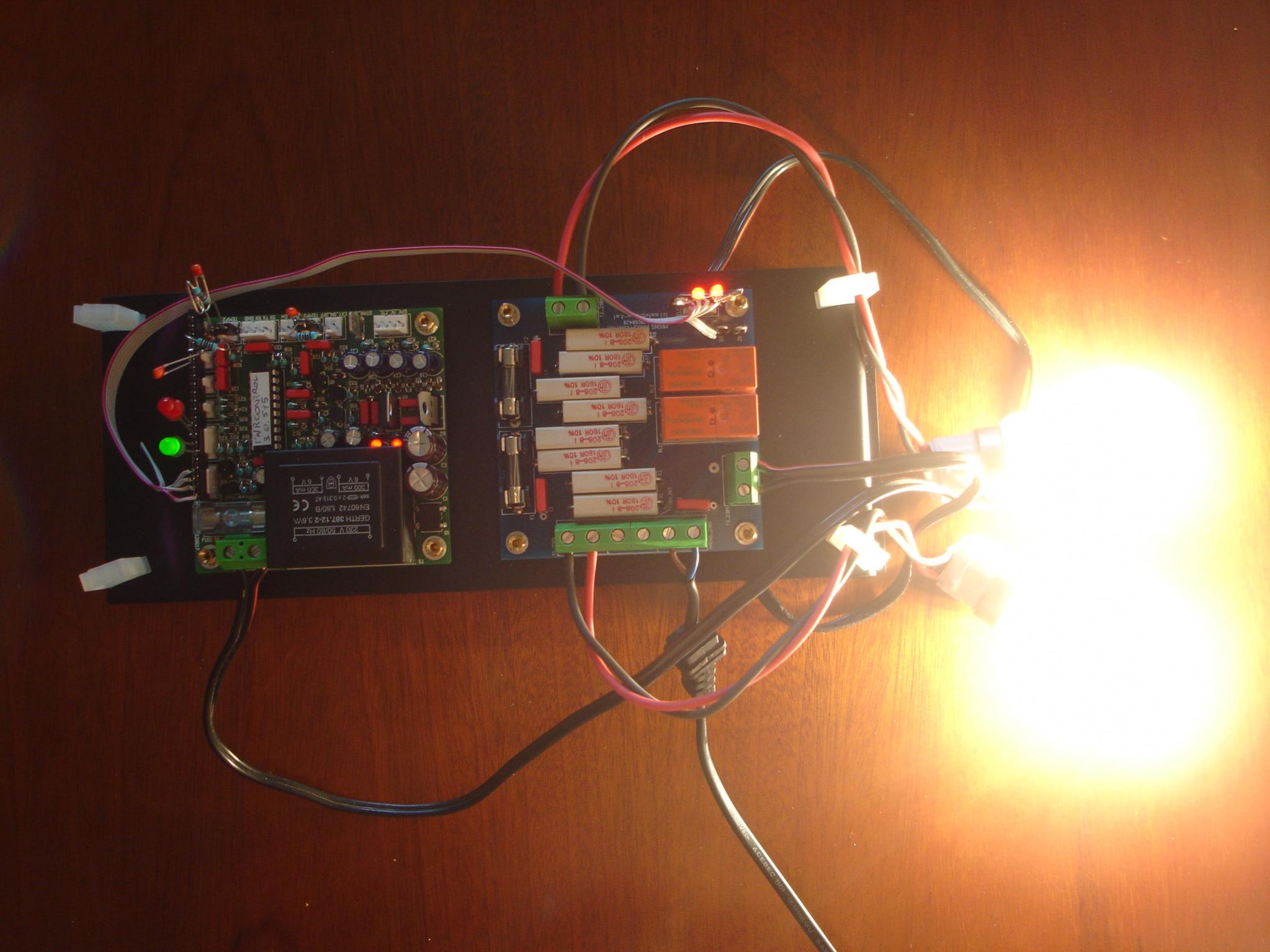

Testing the housekeeping(protection)board.
Just to see how this work.
Two lamps instead of the transformers.
3 resistors(1K) in series with the 3 NTC because fault tempreture recognized under normal temperature conditions.
May be different value NTC configuration in software?
Two leds added parallel to relay coils.
DC sense looks good as a multimeter( in diode scale)connected between star gnd and one of sensing pin is enough to recognised as DC fault.
I haven't used a Power switch now,just momentary short Power On pins.
Is this a reason that delay isn't always the same?
The most times is about 25".but sometimes only 5".
Placing the hot soldering iron near the NTC recognized as temperature fault.
Next step will be the communication between housekeeping and PC.
Have you used 2.2k NTC?
The MCU is highly configurable:
  • 3 x temperature (+/- 3 degree accuracy with typically available 2-3% NTC)
  • DC detection sensibility
  • inrush current delay (typically 250ms)
  • mute delay (typically 2.5s) - output invert-able
  • forced re-powering delay 15 - 30 sec for resistors cooling and children safety
  • repower lock on failure
