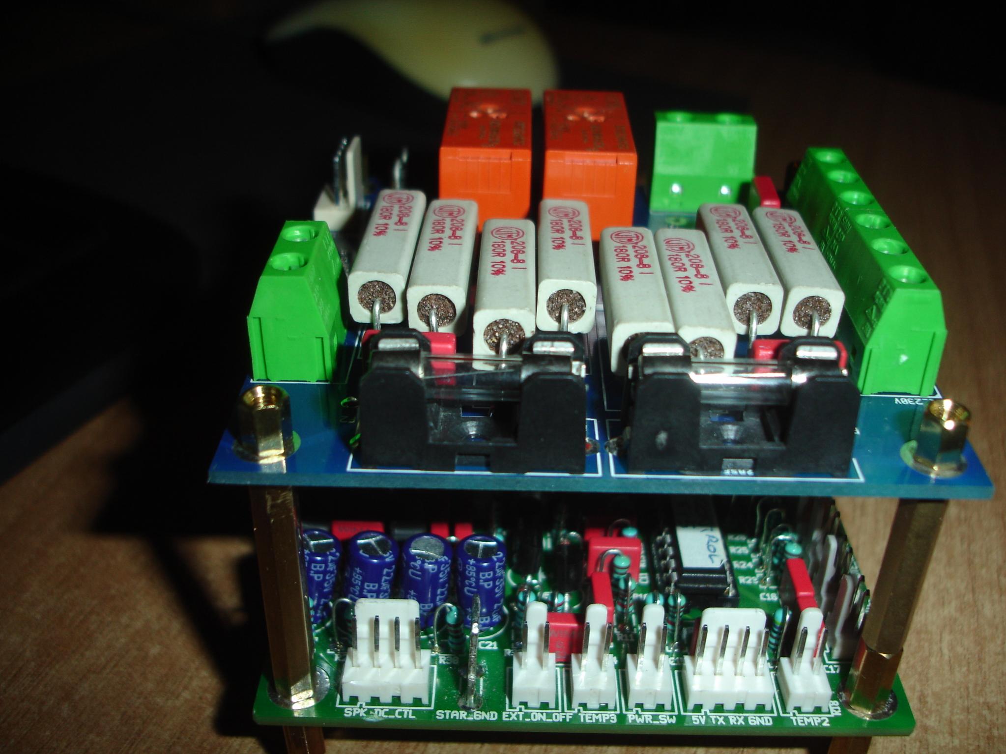

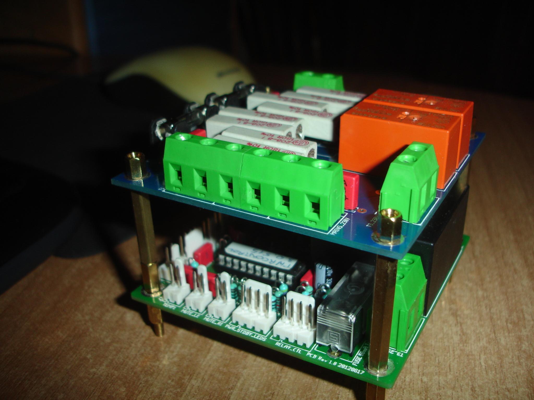

BTW i have a question.
Is it safe the metal spacers usage(10mm long) mounting these 230vac boards ?
Like photo.

Ok Toni,i will mount this as your recommendations.
Given that the design is for a dual mono(separate transformers,rectifiers,caps bank), i wonder about the common usage of star ground and speaker returns on the housekeeping board.😕
For your version of mcu board just connect the mcu gnd via 2 pieces of 22 ohm resistor to each channels star ground. You need this only for dc detection.
Given that i haven't the output (speakers relays),what you think about using two general use speaker's protectors, keeping the mcu for all other function,on-off,inrush control,over temperature protection?
Is this way more ground loop proof?

Given that i haven't the output (speakers relays),what you think about using two general use speaker's protectors, ...
It's better to use the MCU build in features because MUTE and SPKDC work together to keep the maximum safety for your speakers and your amplifier. All parameters can be configured in software. Temperature shutdown, mute delay, SpkDC sensitivity, auto shutdown with repowering avoidance, galvanic decoupled remote powering ...
BR, Toni
BR, Toni
Ok thanks,i will try finding the output relay pcb artwork,then i will come back with many questions about the mcu customisation.🙂

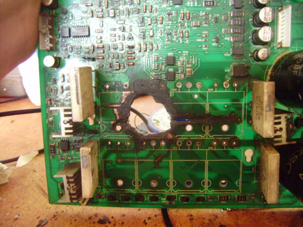

Looks like a design without any safety circuits - power supply delivered power and delivered power and delivered power ... 😱
MOSFETs tend to become a short circuit on failure. No fuse to stop those hazard?😎
It was Crest Audio CC1800 amplifier, using BJT output, and quite sophisticated protection system. Maybe that BJT was weak...

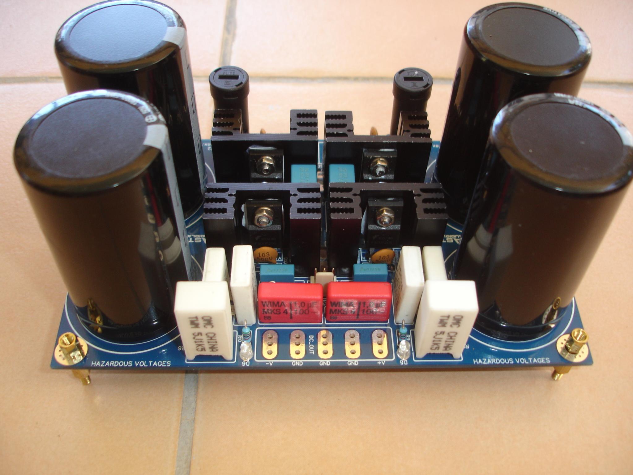

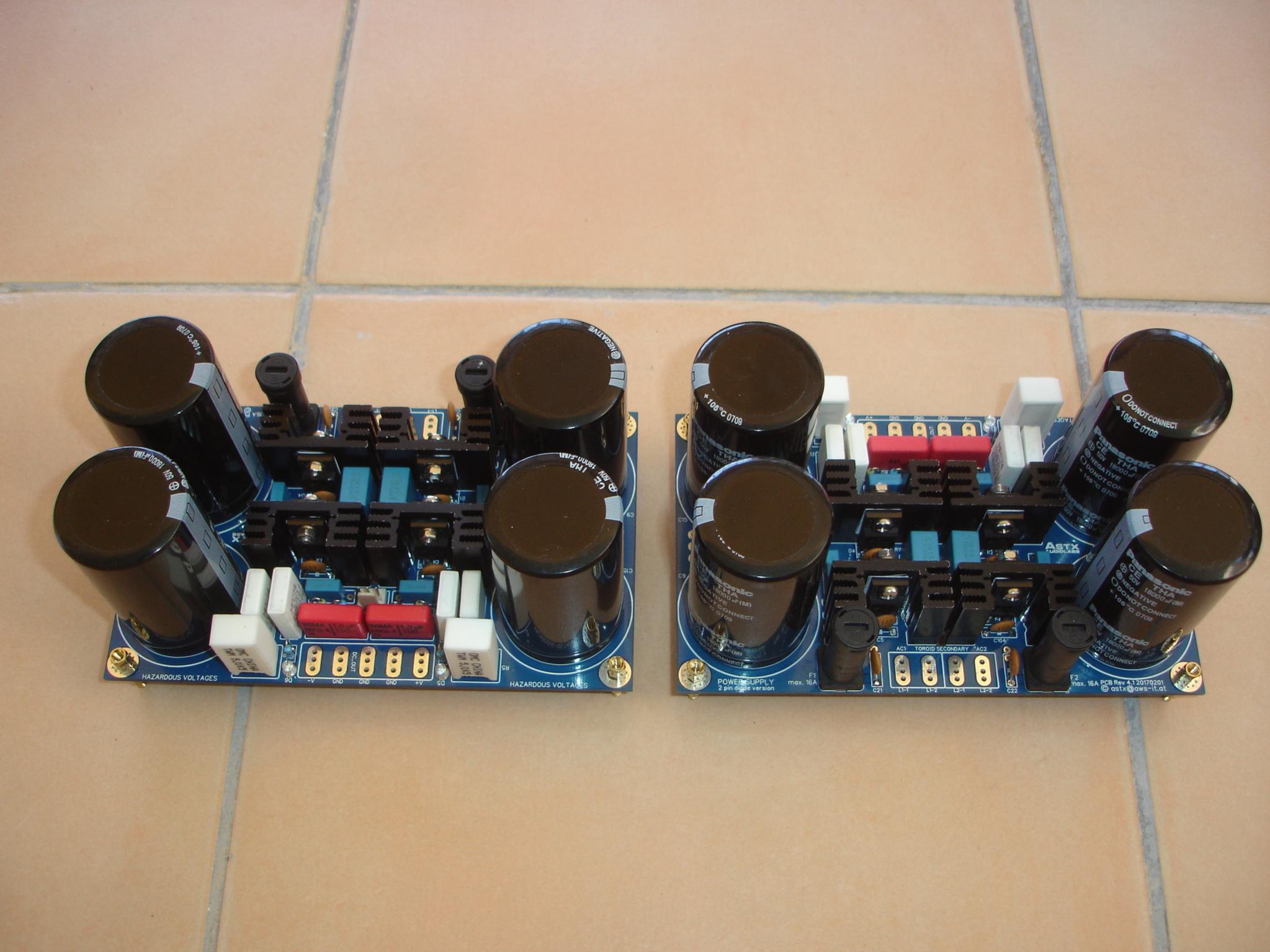

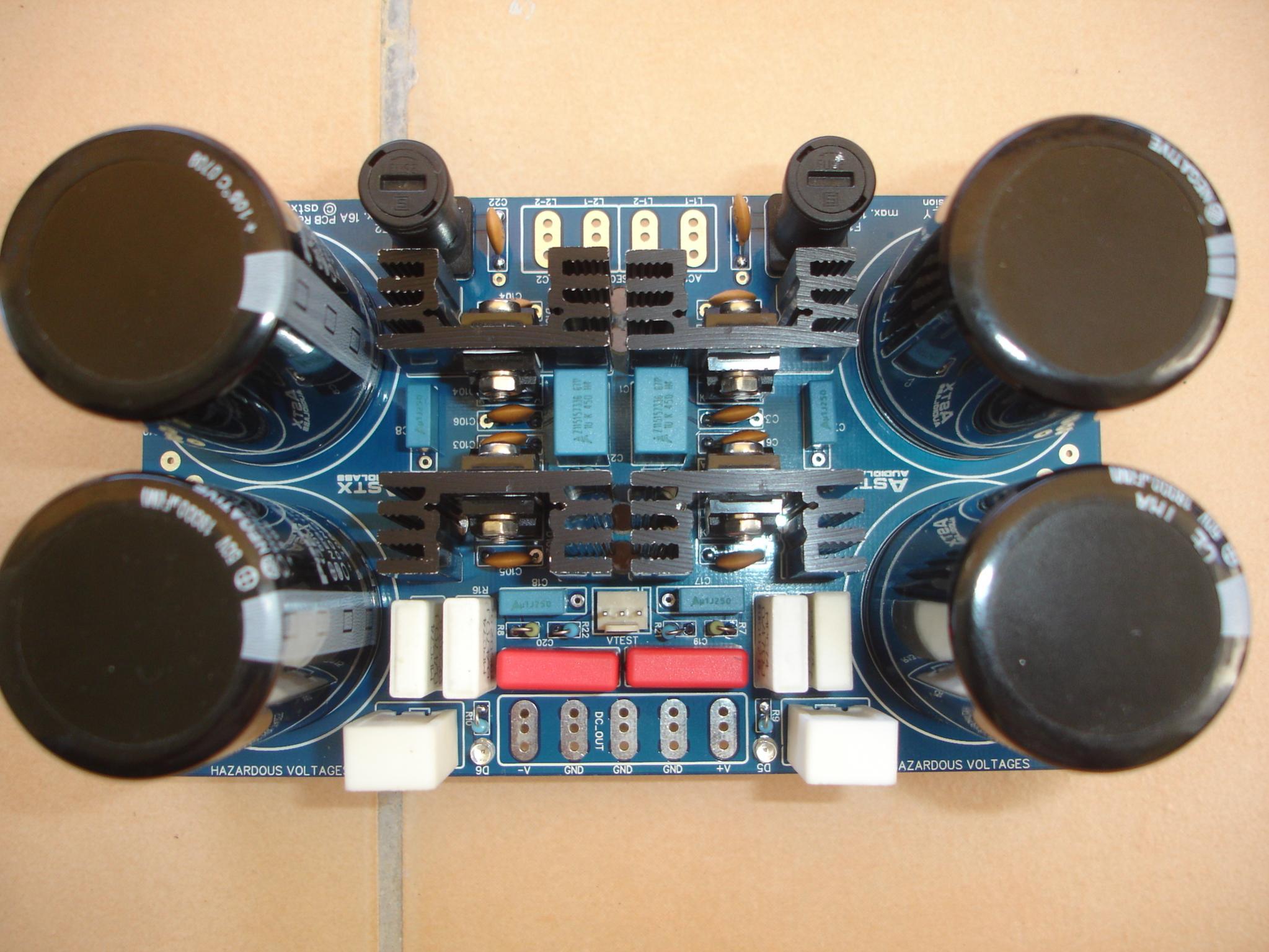

SA2015 Power Supply Boards.
Two Power Supply modules ready for testing.
Top quality parts, easy mount, perfect footprint matching!
Congratulations Toni,very professional drawing😉 as usual🙂
