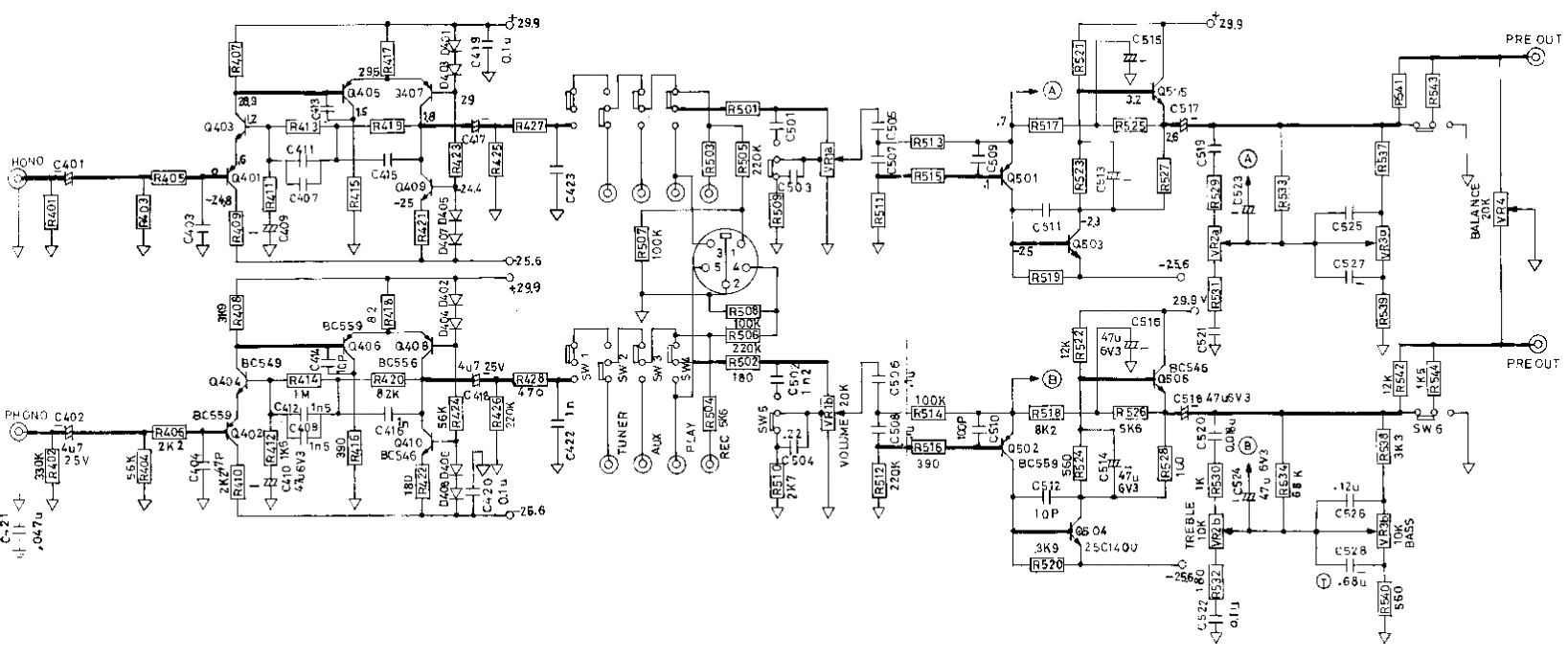

Interesting circuit! Do you have any schematics of NADs application?

Hello
If you mean the Nad phono preamp using a rush (ntp) input and designed by Tomlinson Holman.
Here it is for you and keantoken to save it on yours hard disks.
Bye
Gaetan

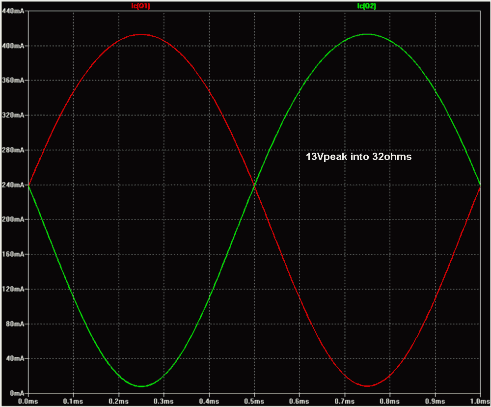

Just so's you know: JLH Class A is slightly (or outrageously depending the
output transistor) more wasteful of quiescent current than "normal" class A.
Class A output current would have crossed at 210mA rather than 240ma.
Hyperbolic A and/or AB would each have crossed far lower than 210ma.
So I submit this mode of operation is similar to HyperA, but 2nd harmonic
of the output currents bent entirely the opposite way.
Though this by far isn't the least efficient JLH design I've seen recently.
I had to lower the load to 32ohms just to exaggerate the graph enough
to take a meaningful picture of what I wanted to show. Not a problem,
just another something to be aware of...
You will need to watch over the thermals, else this design has nothing but
a base current limit to prevent total meltdown... Current gain goes up with
heat, so its uncertain to me if a CCS base current limit alone is sufficient
when you eventually upgrade this to move some real power.

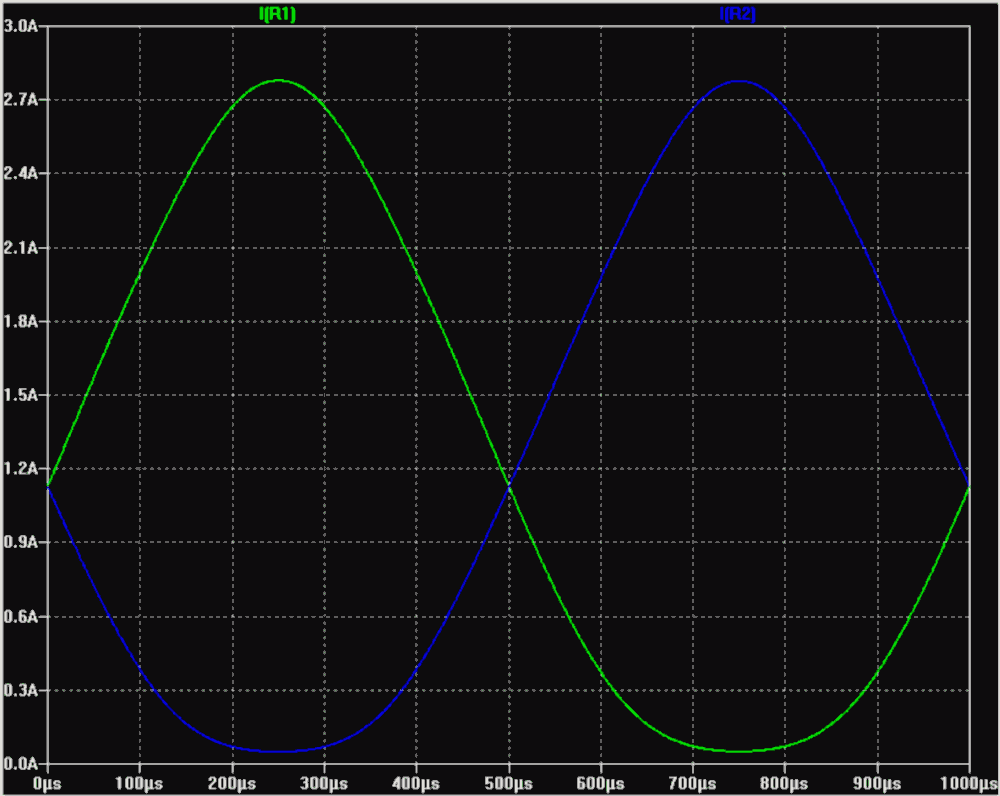

Whatever... Compare these currents to the graph of post #46. Not quite as
Hyper as my usual Allison with the Schottkys. Cause I'm fighting against JLH
natural curve wants big end of the hardboiled eggs pointing the other way.
This still does not address the matter of varying emitter currents causing
a non-linearly varying drop in the follower/comparator. I don't think Rush is
the quick fix for that problem? Taylor might be, but implemented differently
(and for different reasons) than I have here.

JLH without resistors to monitor the output currents? A constant sum base
current yields perfectly complimentary, but somewhat wasteful, big endian
distortions. You have no control what shape the actual output currents
might take (except that they will always compliment), and its guaranteed
to vary with temperature.
