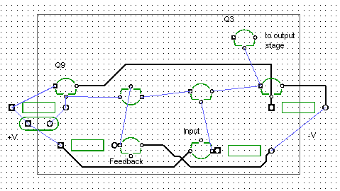

Here is the concept:
Hi kt, quick question. Is your circuit supposed to have 0dB gain? -- because that's how your file simulates. Am I missing something obvious?

It is not a cascoded MOSFET. It is a follower loaded on a counter-modulated current source, and powered by another follower controlled by the same signal. As the result, non-linearities caused by modulations of D-S voltage (or C-E voltage) and drain current (or emitter current) are minimized.
JLH output stage you use resembles one part of this my concept, related to constant current only: the lower transistor is a counter-modulated current source. If you want to improve it turn the bottom transistor into a fair current mirror, adding one more transistor and couple of resistors. As is, it has flaws: a first, "dirty" base-collector currents are always summed with driving current adding an error that depends on temperature, and phase distortions are asymmetrical, especially on higher frequencies, and quiescent current goes up with frequency due to rectification of the signal. Also, quiescent current of an output stage is highly modulated by temperature because it depends on beta of the lower transistor. It causes both thermal instability and non-linearity on lower frequencies caused by thermal intermodulations.
The simulator shows only a small increase in bias current, when using Andy_C's 2SC4793 model. 3mA difference between 20 and 30 degrees C. I don't think this is enough to be a problem. Unless the simulator is missing something? In fact, in the two-Q CCS I'm using, output current decreases with temperature, so there is possibly some negative feedback.
As far as phase distortion, the transistors used have very low Cob, and the MPSA18 is buffered through Q4. What affect will it have in the audio spectrum?
I just did a .ac analysis, there is no indication of these problems. Forgive me for using the simulator exclusively, I have no way of measuring this in real life.

Did some DC-sims with the circuit in your first post but can not eliminate some DC at the output(in the ballpark of 60mV). The optional DC-comp didn´t work as supposed. Tried both with DC and AC-feedback.
Anyway THD with 20db gain seems very good. But that is probably what one could expect with an open loop gain of ca 66dB.

First of all, say you have 2mA bias for the Rush pair.
This means you should have 2mA for the buffers Q7 and Q6.
So if your power supply is +-30V, that's 15V per transistor, which comes to about 6.8k for R3 and R2.
But we need to give some slack here so that we can adjust the offset to be right. So lets lower R2 and R3 to 6.2k, and add in the adjustment resistor.
In the simulation, Offset is below 1mV with about a 6k offset resistor.
If you changed the rail voltages, you will have to adjust R2 and R3 as necessary.

I used your values of +/-15V. With the schematic(1st post) as is(pure follower) offset is zero. When adding 10k/1k feedback for 20dB gain we get an offset of ca 60mV. Tried with and without a capacitor to ground in series with the 1k.
One problem with this arrangement is that unlike in an LTP, the base current if the differential currents does not cancel.
It should help to use a feedback network of 1k/100 (or even 100/10). This way, Ib won't cause so much offset.
If all else fails, send me the file you use. Maybe there is something wrong.
