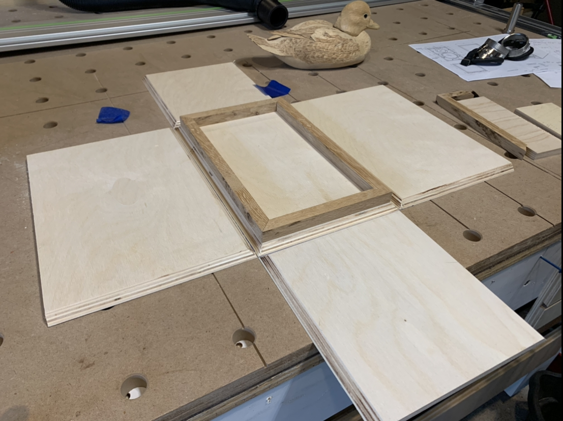

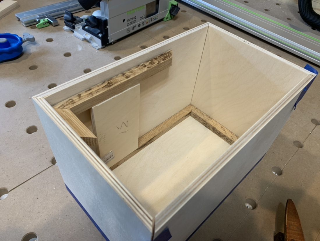

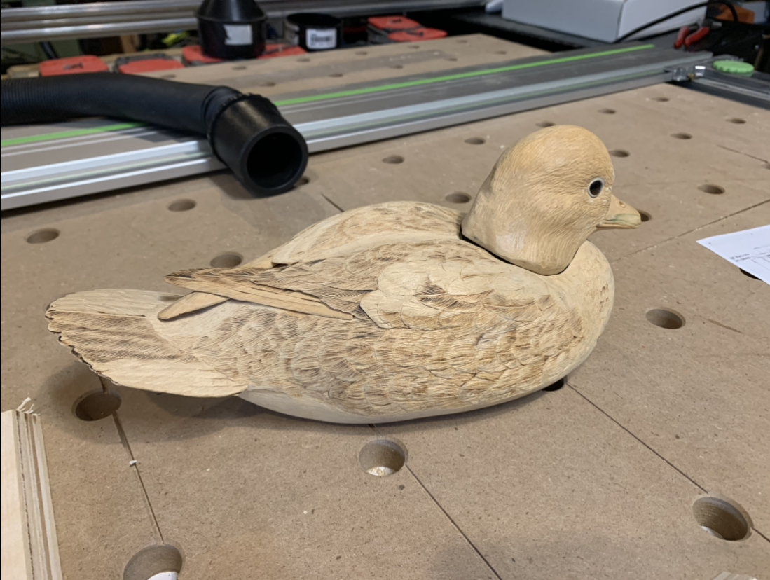

I dropped off the drivers at my cabinet maker’s shop today and saw that we are making great progress: all the wood for the panels has been cut and mitered. Checking the dry fit before glue. The battens are mitered as well and held together with a “V” art framing staple and glue. The white oak is salvaged from a 150yr old barn that was being razed. Very dense and hard wood - a shame to hide it inside the cabinet. I also found out that he is a very talented sculptor too - a wooden duck model carved from basswood meant for museum displays.
Shaping up nicely X.
Your cabinet maker is really good with his hands - very nice handiwork with the duck sculpture there!
There is something very cool knowing that the internals contain wood from a 150yr old barn in Virginia. Basically there during the Civil War. 😎

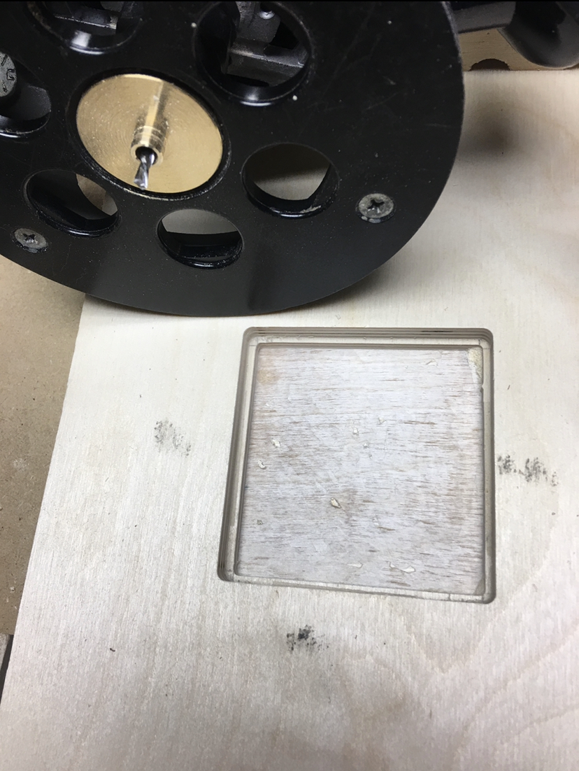

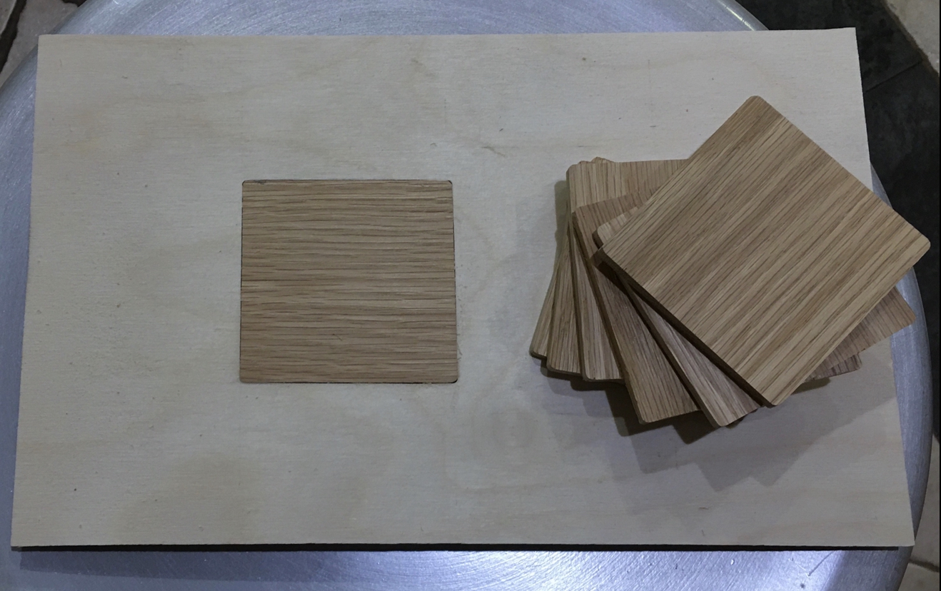

So we are going to make a small plaque out of the antique 150yr old barn white oak and inlay it into the back and then laser engrave the speaker name, specs, etc on the back. This speaker will have to be finished with BLO. No other choice.

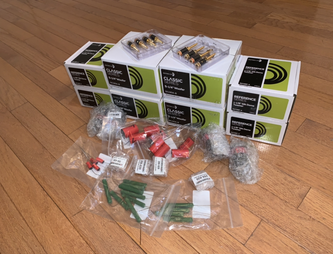

What value resistors did you end up ordering? The schematic shows 13.3 Ohm and 12 Ohm but those values are not available from PE in the type you show in the parts pile.
Two 6 Ohm and two 6.5 Ohm could work for 12 and 13 Ohm. Or a 3.3 and 10 for 13.3. It seems like there should be more resistors shown in your order.

Thanks for your interest. I ended up getting the 12.5ohm for the 12ohm. And a 12.5ohm plus 1.0ohm for the 13.5ohm. This way I only had to buy two kinds of resistors. I used the new 1% green wire wound resistors from Dayton. For the caps, I used a 10uF plus 1uF for the 11uF. The 4.7uF is a single cap. I used Audyn Q4 MKPs. For the inductor, I used an 18ga iron core 5mH from Dayton and a 20ga aircore 20ga from Jantzen.

Nice touch and tribute to the barn. Speakers are coming along well too. Not sure where you find all the energy but keep at it, amazing work..dB
Thanks for the info on the resistors. Everything is ordered.
Had to go with the dayton inductors as the Jantzens were out of stock.
Nice touch with the barn wood panel. Old wood has such character.
