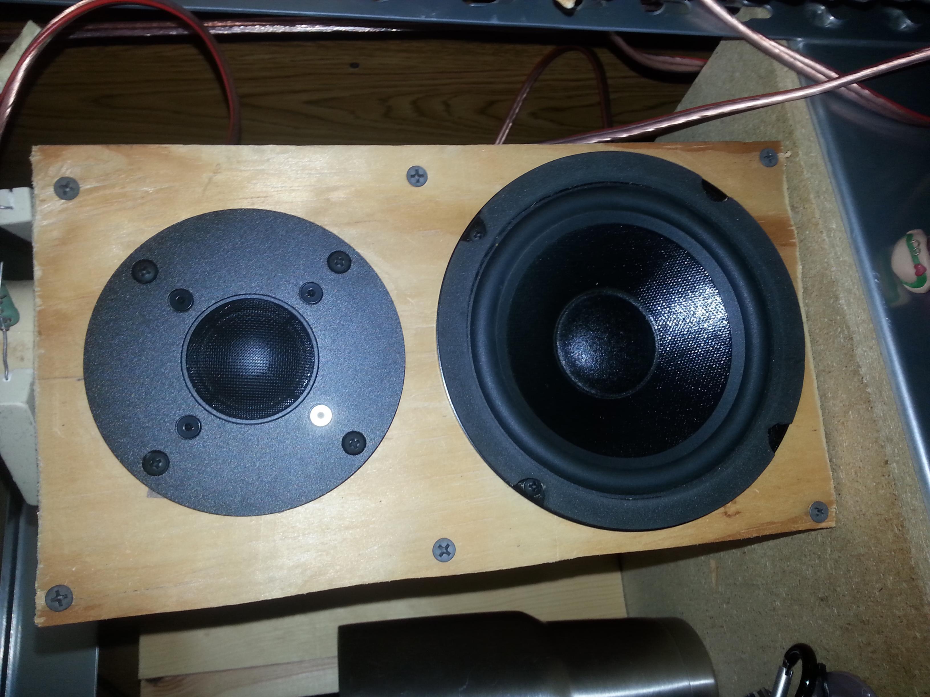

Thanks! I hope that I have put forth here an easy to build and inexpensive compact 2 way monitor that has a nice balanced voicing and relativey neutral frequency response. It probably isn't going to sound like an LS3/5A - I can't say as I have not heard one - but I can imagine it might be something like this.
I already had a box that was the right size. I just had to cut a new baffle and mount the drivers. Then I twisted up the crossover. I have 16 of the woofers in my Art Array. Thanks again. I will post a picture tomorrow. Pretty rough looking mdf box.

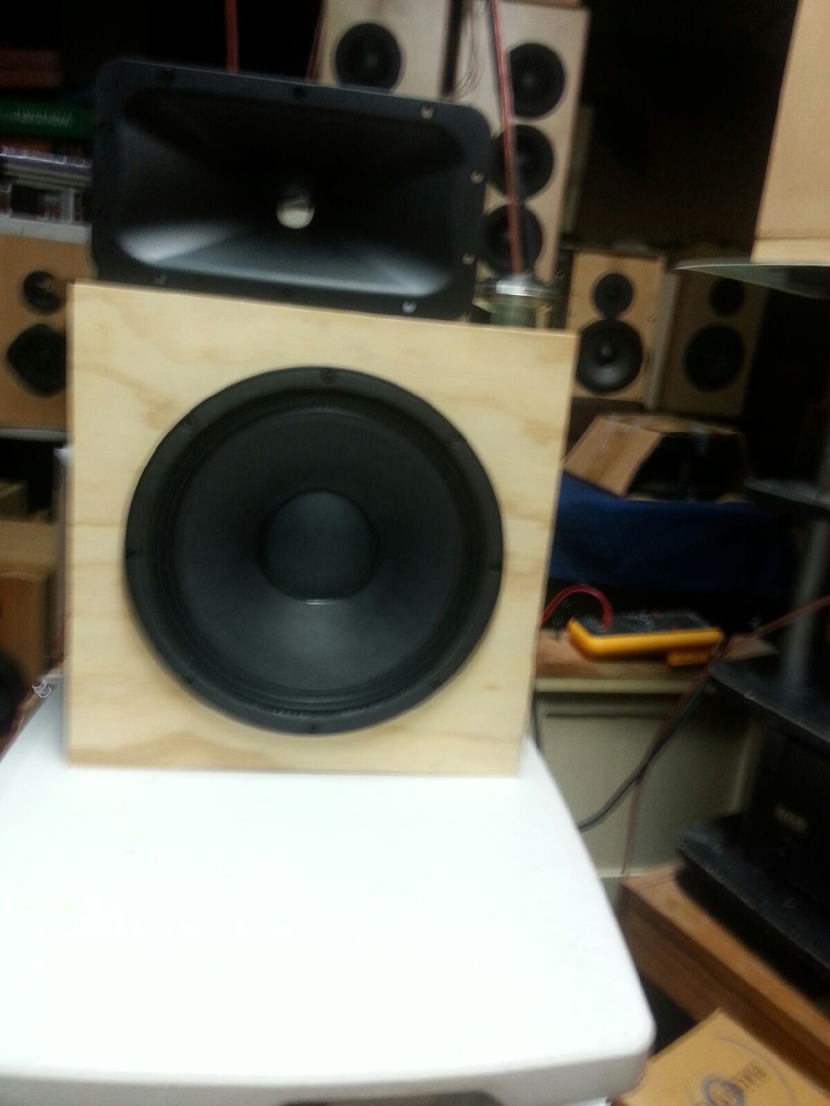

1. Cannot access the image of your link.
2. I need to rotate my head 90% to view the image.
3. Would you be able to advise us on the type of drivers you use?
Thanks.
I apologize for messing things up. I am unsure how to get the picture from the box where you collect it to the box where you show it. I just dragged and dropped. I also don't know how to rotate my photo. The drivers are the RST28 and DC130 in the first picture. The 2nd is a 12" B&C driver with a BMS horn driver and a Pyle horn.
ps: The 12" is not flush mounted.
