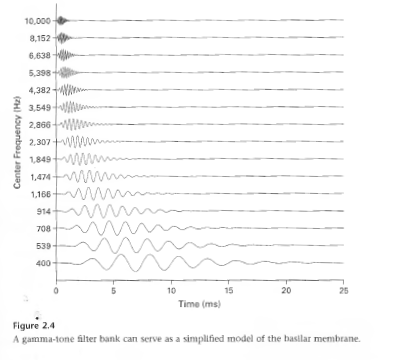

This brings me to another point - Markus, thanks for the reference on that book on "Auditory Neuroscience" It is really quite excellent. A very good survey of the latest research and understanding in hearing. I was particularly impressed with Fug 2.4. This figure explains so much. Note how the temporal aspects (FDW) are not linear with frequency. Also note that of the 15 CB filters shown 12 of them are above 700 Hz. The cochlea is dominated by frequencies above 700 Hz. There is so much to see in this figure.
I used this book to create my own set of gammatone filters to use in my polar map program.

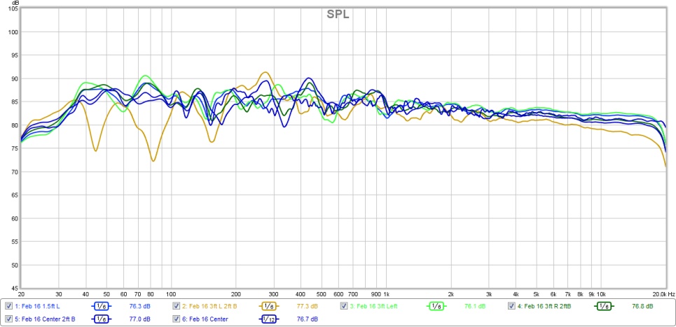

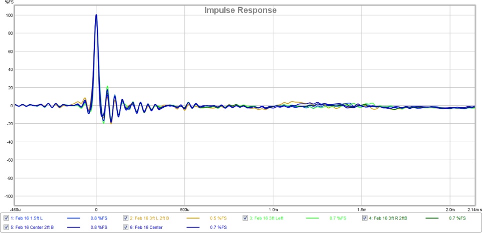

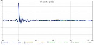

It also explains why I can get both the frequency and time domain responses (overlays attached) measured at 6 different locations across a 6' x 2' grid, using REW software to measure each "point" location.
Getting past PEQ, and into real room correction, one will also find that linear phase FIR filters measure and sound better than minimum phase filters. I linked to the science in earlier posts. As soon as one hears a linear phase FIR filter corrected system, (compared to minphase) you will know why.
Before anyone jumps on me for that last comment, please provide an acoustic measurement of a linear phase FIR filter corrected sound system (like the impulse response attached) to show one has actually measured and heard such a system.
Good luck, Mitch

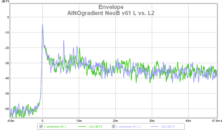

My room decays to complete ambiance in less than 300ms, despite highly reflective walls with lots of brick, glass, and 3/4" wood paneling. Room is well furnished, with wall to wall wool carpet and carpet padding, acoustic tile ceiling, and ceiling broken up by three wooden beams:
Looks ike your room is highly damped not only because of the acoustic tiling but because of glass and false (?) brick wall that can be effective low frequency absorbers.
What I don't understand is the difference in room decay between your woofer and corrected speaker response:

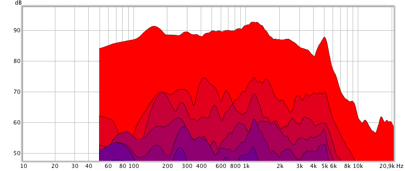

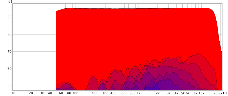

What if i make a FIR minphase correction? It is no problem to do so, and the magnitude response looks exactly like the linear phase correction.

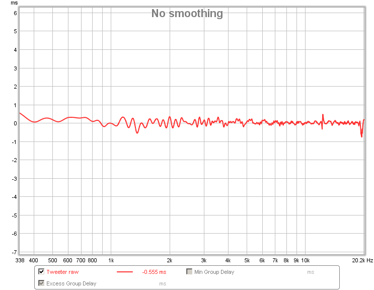

My demonstrated correction does not use FDW, or any house curve psychoacoustic type stuff. Criteria for information bandwidth is flat response. Reflections are highly down weighted by high direct/reflected ratio due to close reference measurement. Speaker design has minimal baffle impact, close driver placement relative to crossover frequency.
Here is GD for raw tweeter measurement using 20ms Blackman-Harris 4 term windowing:
Unlike Juhazi's measurement, this one is suitable for spectral inversion without any additional treatment. FDW would add little if any benefit.

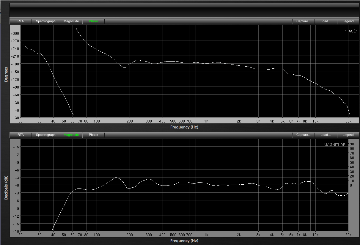

I have measured a self powered bi-amped Mackie HD1521 which uses FIR filters down to around 200 Hz (latency for live use would become an issue if implemented lower) and it sounded far better than I would have expected considering the drivers and horn used.
At the time (2009) I was amazed by the flat phase response, being unaware of FIR, I had never measured a multi-way speaker with as flat phase over as wide a range.

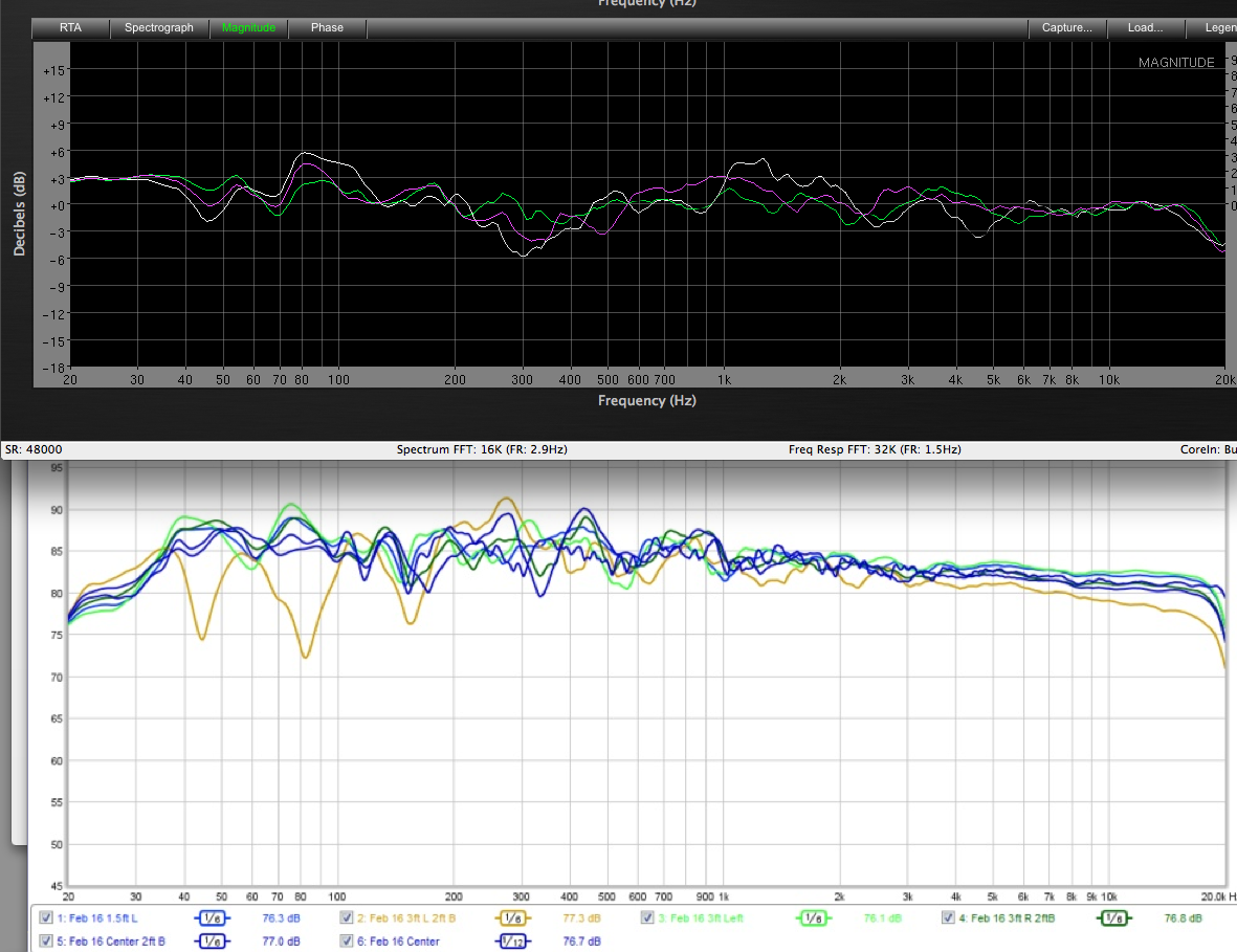

I use an Alesis DEQ830 (30 band 1/3 octave digital equalizer) to equalize my stereo speakers, a pair of 8" with dome tweeters and a 2x12" sealed sub.
The frequency response over the width of my couch show similar deviations as your measurements using FIR filters, though my system shows wrapping phase response typical of a three-way system.
The green trace is the center listening position, purple left of center, and white far left of center (near the side wall), four foot distance between center and far left. The center listening position is also room center, couch is up against the left wall.
Although one can argue that linear phase "sounds better", from a frequency response standpoint, it does not appear to be measurably better.
Having compared speakers that measure flat but have smoothly wrapping phase response to ones that measure flat with more linear phase, I can't tell the difference, so I have not bothered to change to a FIR based system.
