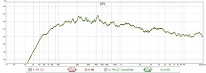

Art,
...What I am looking for is if anyone has measured a linear phase corrected speaker system that has a similar impulse response to the ones I have posted. So far, it appears no one has...
...That’s why I think it would be interesting to see anyone else’s measures and impressions of linear phase versus minimum phase, from a time domain perspective and seeing if the measured results correlate with listening impressions...
...So, if one has the capability to design and implement both linear phase and minimum phase filters, with driver time alignment and excess phase correction, please post your measurements and listening impressions and we will see if there is enough of a correlation to come to some conclusion...
mitchba,

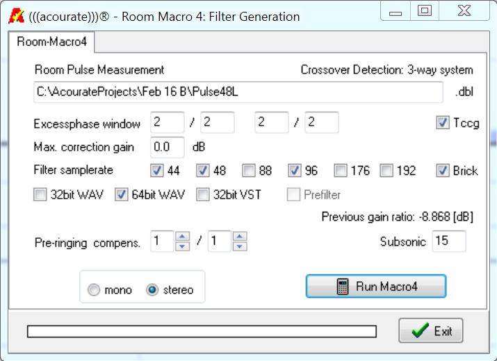

If I understand your request correctly, my setup and evaluations meet your criteria. I showed some measurements in Post 235 and below show the differences with, and without, the final phase correction filter. As commented above by several others this is actually relative easy and free for anyone to do. Just create a phase correction filter in RePhase and then convolve some music selections or test tones files for comparison using ABX type software.
I would quickly agree with comments regarding XO choices, EQ choices and house curve as being important and relatively obvious contributors to the overall sound quality. However, my ABX and general listening comparisons both using headphones and speakers has found no easily detectable sound quality difference using overall phase linearization.
My only experience is with lots of different of XO/EQ setups with my modest DIY setup. It's a single room and setup but still is enough to satisfy me that the researchers are correct that indicate that phase rotation (GD) within typical levels is not a significant factor. There is no cost or other penalty in my setup however so I still place a RePhase correction filter into FooConvolve for my music listening. There is a certain satisfaction in seeing a more ideal looking transfer function response in the measurements even if I cannot hear a difference.
Acourate and other software use very different EQ approaches than typical PEQ filters. These EQ approaches are more likely the primary contributor to the improvements you hear. I suggest that since you have optimized your setup using Acourate that you can now use RePhase to create a linear filter with a typical speaker's phase rotation and use it to convolve some of your music selections so that you can then ABX test. In that way you should get a good sense of just how much the direct phase rotation correction portion of Acourate is contributing to the sound. I would suspect the sound is similar, but would be interested to know if that is what you find.
The linear phase XO filter available in Acourate and other software are a different subject in my opinion and I am more open to the potential merits of that capability - higher slopes/less overlap without the phase rotation of IIR filters to contend with. I can see that that may be a significant factor.

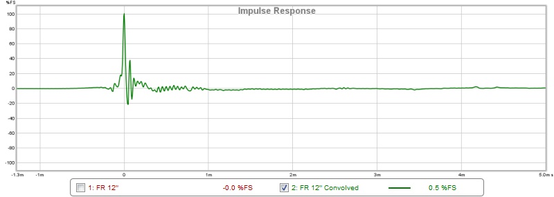

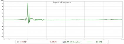

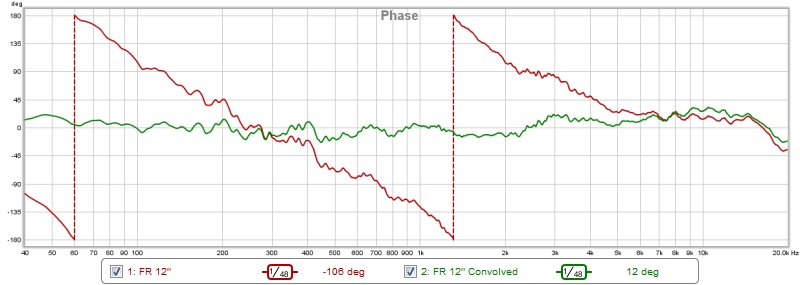

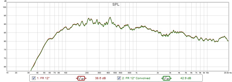

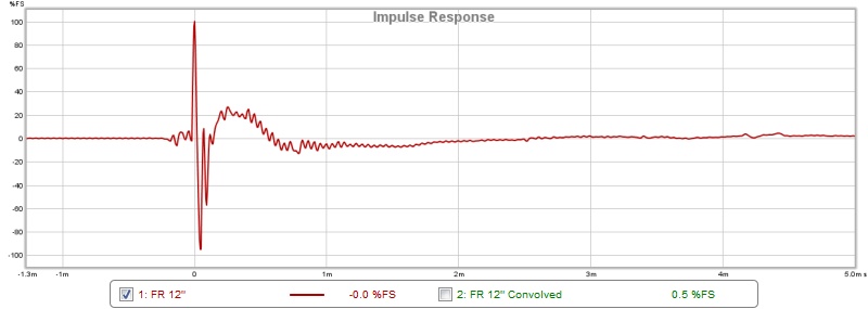

The charts below use a 12" mic distance for my FR main speaker. The SWs are muted. The comparison is "with" and "without" the RePhase filter applied.
The SPL overlay is identical.
Both phase traces show a minimum phase ripple that results from early dispersion and reflection effects. The convolved (green) measurement shows that the excess phase is effectively removed.
The 2 IRs are plotted separately for clarity. Most of the minor ripples preceding and following the IR peaks are due to the impact of Nyquist filter in my setup and their spacing corresponds to 44.1kHz. These same ripples show up in a simple loopback test of my measuring system.

A given impulse shape correspond to a specific amplitude and phase response, and vice versa (FFT).
The steeper the curves the more ringing you get.
If your target is linear-phase then the impulse will be symmetrical and you will get both pre and post ringing, whereas if your target is minimum-phase you will only get (double amount of) post ringing, which is obviously less noticeable on musical signals.
If those filters form a complementary and aligned crossover, then all the ringing (pre and post, regardless of the phase relation) will cancel, and you will be left with a seamless transition.

Hi jmbee, sorry for the delay to respond to your post. Looks great! Would you be able to share a bit more on how you achieved your results? Cheers, Mitch
jtalden, art, and pos. Thanks for posting your results and thoughts.
Art, the conclusion you pulled from the paper is the conclusion for "minphase" filters. The conclusion for linphase filters is different:
"With the linear phase crossovers generated by Acourate we get a perfect behaviour. The crossovers add up to a Dirac pulse. So we have reached a first goal in ourspeaker optimization. Based on the thought experiment with assumed perfect drivers we can concentrate on the behaviour of the crossover filters themselves. And it can be shown that linear phase filters allow us to reach the desired function."

jtalden, "Acourate and other software use very different EQ approaches than typical PEQ filters. These EQ approaches are more likely the primary contributor to the improvements you hear. I suggest that since you have optimized your setup using Acourate that you can now use RePhase to create a linear filter with a typical speaker's phase rotation and use it to convolve some of your music selections so that you can then ABX test. In that way you should get a good sense of just how much the direct phase rotation correction portion of Acourate is contributing to the sound. I would suspect the sound is similar, but would be interested to know if that is what you find."
pos has mentioned that "rePhase is not meant to be a room correction software". This is where at least one difference is. See attachment. Note that the excess phase correction FDW parameters are user adjustable for the measurement at the LP. As I adjust the values and generate new filters, and ABX them, I can not only hear the difference, but I can tell which one has the more excess phase correction.
It is going to take a couple of days, but let me convolve some music with different excess phase corrections as the only changing variable and post up and we will see if folks can hear the differences or not. Cheers, Mitch
