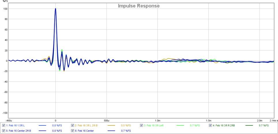

What does the impulse response look like?

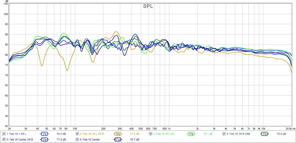

Here are 6 measures of my right (digitally corrected) speaker around a 6' x 2' area at the listening position centered 10' away. Attached is an overlay with 1/6 octave smoothing applied. Also attached is an overlay of the 6 corresponding impulse responses.
The gold curve is the furthest measure from the speaker. Average response is about +- 5dB across the listening area.

The acoustic measures I posted have no preringing. If anything, there is too much preringing compensation, and excess phase correction. Time to adjust and remeasure.
Are you going to post any impulse responses from the measurements you made?

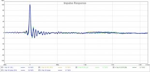

Sure, what do you want to see?

I see a room in those measurements riddled with bad reflections and room modes. Typical situation for 99%. If you cannot separate the speaker from the room and address the room itself then the point of this mental exercise is what exactly? Does not matter if we read all the papers if we do not address the real issues. No amount of nit picking will solve the major issues when we are only talking about the finest details. Forest from the trees
Of course we have to separate the room from the source (speaker). That was the whole point of my graph. The problem is NOT just as one dimensional as fixing a "information transmission system" problem.

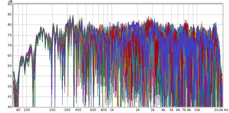

Your measurement set for 20cm x 20cm x 20cm cube looks to have about 12 measurements. Windowing appears to be at least 16k samples for 44.1kHz or 48kHz sample rate, perhaps much higher. This is not what is heard, hearing is perception of continuously fluctuating air pressure across the eardrum, to which very good approximation is fluctuation of air pressure at opening of ear canal.
Mitchba proposes smoothing. This is broad in terms of how it is carried out. On surface this would be applying smoothing algorithm to frequency response data for a given window. Better to start with window/gating that shows direct response of speaker. This is readily compared to windowing/gating out direct response, leaving only that of room. Total response equals superposition of direct response and reflected response for system of speaker, receiver. This holds because system is dominantly linear and time invariant.
