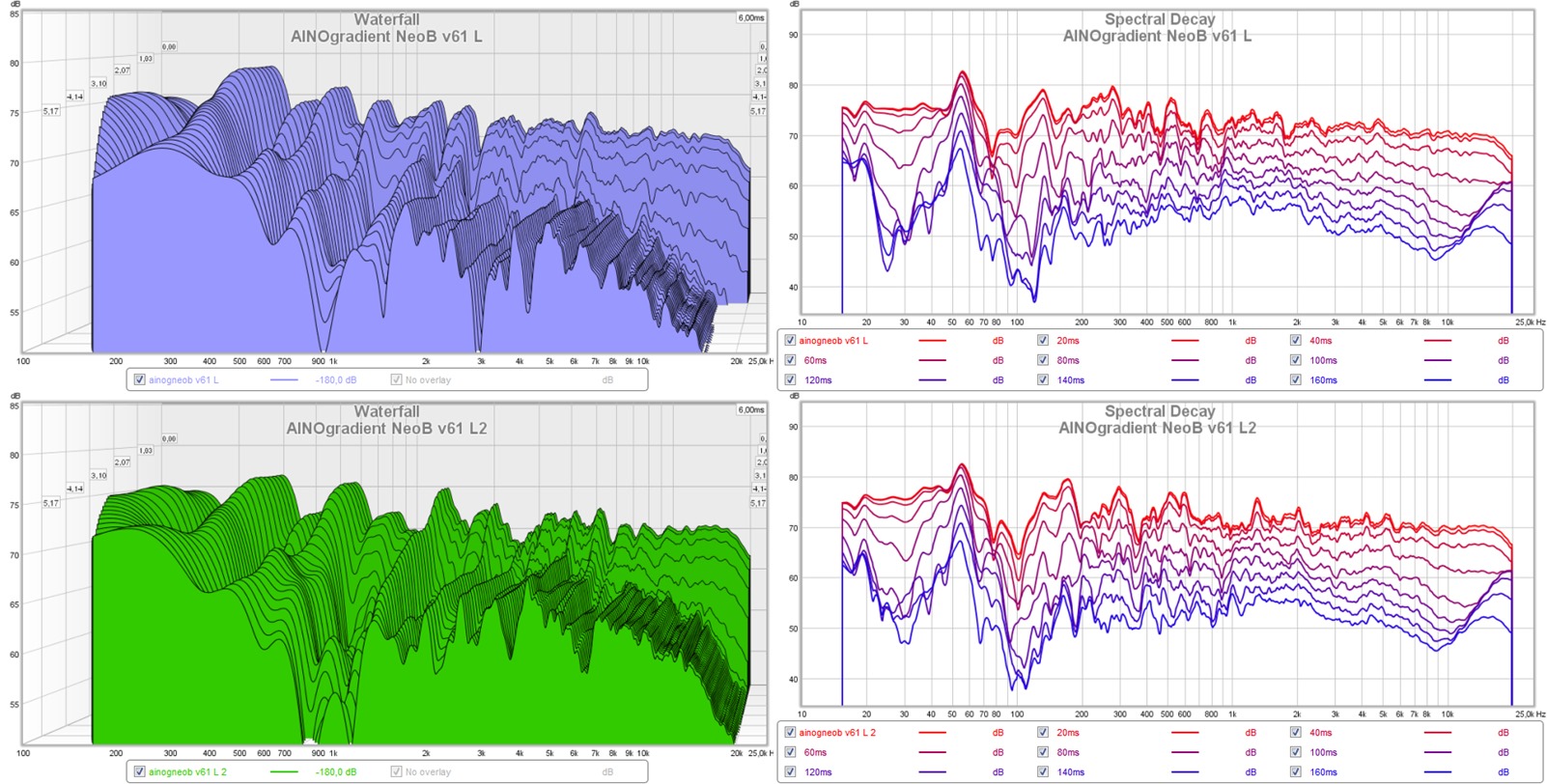

This morning I had a measurement session with AINOs, about 4 hours of hardcore tuning and parameter setting. Result will be shown later here, they are in my laptop now.

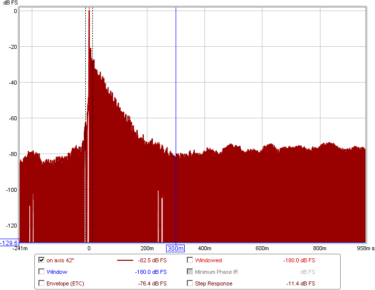

My room decays to complete ambiance in less than 300ms, despite highly reflective walls with lots of brick, glass, and 3/4" wood paneling. Room is well furnished, with wall to wall wool carpet and carpet padding, acoustic tile ceiling, and ceiling broken up by three wooden beams:
![ir 42inch dbfs.png ir 42inch dbfs.png](https://www.diyaudio.com/community/data/attachments/359/359927-011e532d2ef92e3bcd473239f16fbfee.jpg)
Zooming of time axis reveals pre ringing of FIR high pass filter controlling bass cutoff used. Pre ringing peaks at about -40dB <1ms pre peak. No ringing is heard with music source:

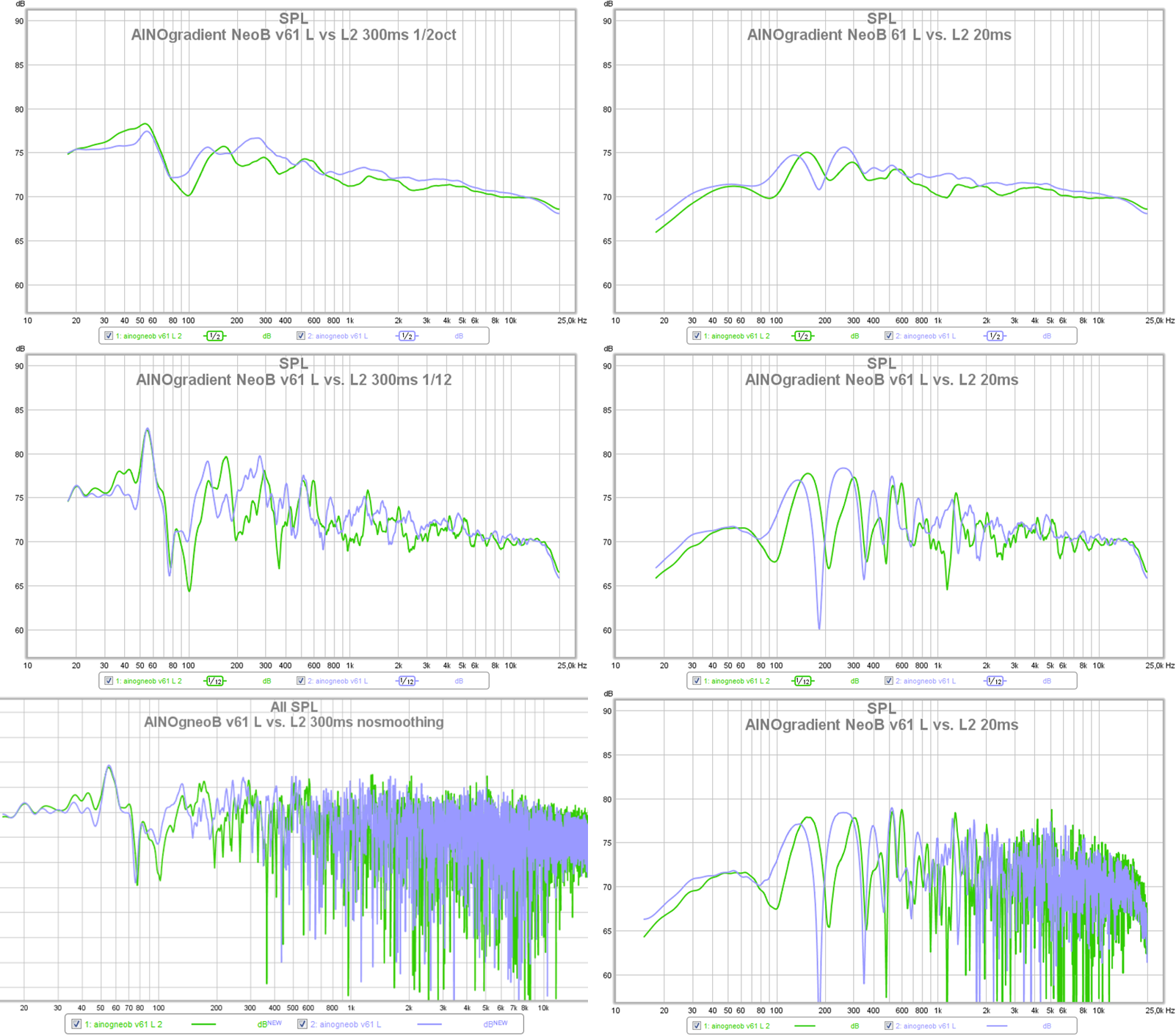

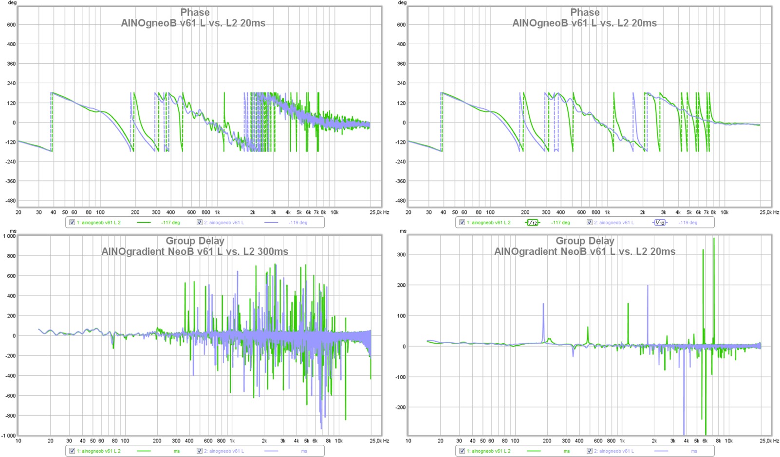

To make things simple here I show only 2 measurements of the same spaker in same locations, only microphone moved 50cm in z-plane (distance) in my living room. The EDT is around 0.3ms and T30 is 0.3 - 0.6ms. The speaker was some 20¤ turned, that is why response is declining so much. These measurement represent the "best" response that I achieved after many hours of minidsp tuning. Room has not any acoustic treatment and speakers are 80cm from Windows on the front wall. Side walls are 2m away. The speaker has monopole bass xo130Hz, dipole mids and tweeters.
Please look at these and notice the difference of "peaks" and "dips" frequency and magnitude. Phase and GD changes are very sharp because they are due to reflections, not caused by the speaker itself.
These are just 2 measurement sweeps analyzed with REW. Then, take 6-10 more measurements and try to make sense of that! I get a headache from just these 2!
