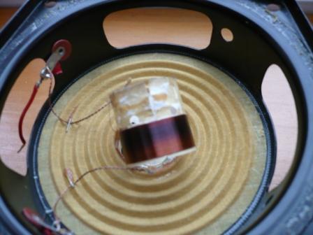

So, Here's the start of my dis-assembly of the speakers
- Using a rolled wet tissue around the dustcap makes it far easier to remove (whitens the glue,which goes back to clear after drying) - Picture 1

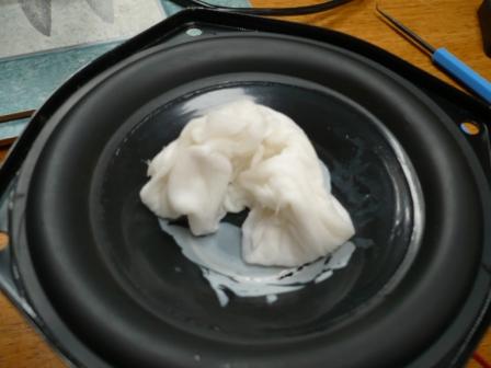

- I started to unstick the cone from the rubber surround but saw some minor cracking in the rubber where it meets the cone so I stopped & realised that it would be easier to unglue the rubber surround from the basket (thicker rubber here also)- Picture 2
- Now I'm at the stage where I need to unglue the spider from the
basket to take out the whole (cone+rubber surround+spider) so I can unglue the voice coil from the cone
- This step is proving to be a problem - can't seem to loosen the glue holding the spider to the basket - have applied water as solvent and left for a number of hours but no shift - will leave overnight but I imagine it's not a water soluble glue
- Any suggestions that might dissolve the glue but not the spider
which seems to be a fine mesh of some corrugated material, not paper!

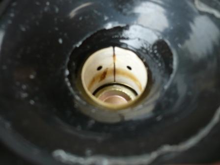

- The voicecoil measures OK 6.? ohms for both sides but I can see some browning of the former & browning of the wires - Picture 3

Yep, salas,
That's the problem! Here's two more shots
- Cone removed
- Voicecoil Removed
I don't see any obvious deforamation of Voicecoil but if it's an overall swelling it wouldn't be visible, I guess

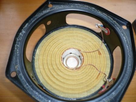

I can't get a close shot of the voice coil but what I mean is - there is a wire from both ends of the coil (a single layer of wire) - how is the one from the bottom of the coil routed to the top of the coil (where it has to be located) without overlapping accross all the wires of the coil?
Secondly, can you explain - could the coil expand uniformely due to the heat produced? Don't know if it's clear in the photo but there's a small gap in the former - caused by heat?
If the former has expanded how do I know what diameter to make the new former?
It could go up through a channel (a little gap before the folded former cylinder side ends meet) in some old voice coil constructions.
It can expand evenly yes. The gap is the one I was talking about in the former paragraph, but it has widened now, from overheating most probably.
The diameter must be such, so the new voice coil centers in the magnetic gap exactly, and moves freely too.
