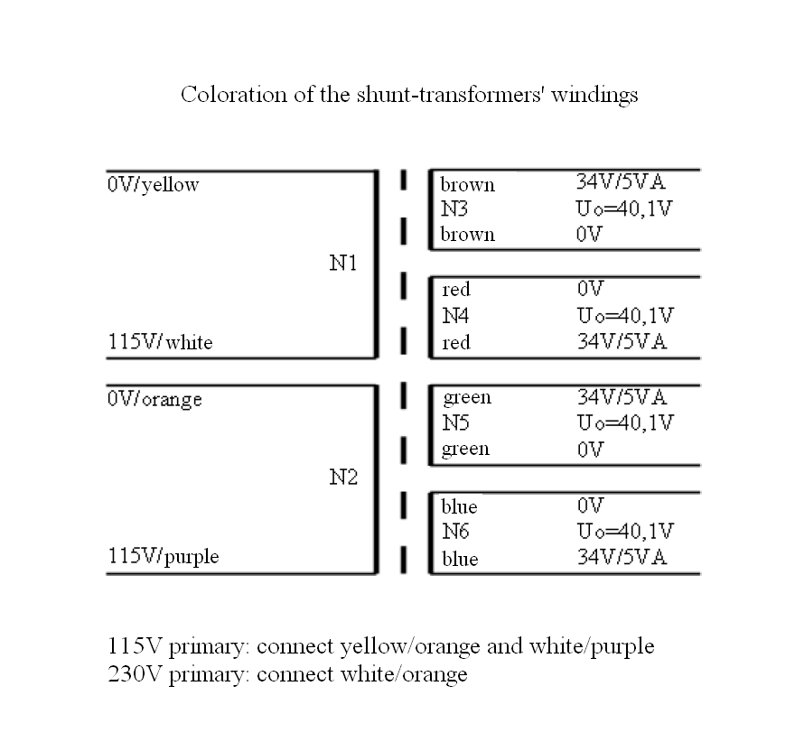

Gentlemen, I received the 4x34VAC shunt transformers today and will immediately send them to you.
Please keep in mind the image showing the colours of the primary and secondary windings.
Best regards - Rudi_Ratlos

Andrew,
can You better explain your last post? Why do I need to know the phase of the primary and the phases of secondaries? For grounding issues?
And how can I determine that? Relative polarity of secondaries can be detected quite easily: if I put two secondaries in series, "counter-phase alignement" will yield 0 Vac, while "equi-phase alignement" will yield 68 Vac...
I imagine that should exist a better method, isn't it?
Fabrizio
the two tappings for each winding are the same colour.
You must find which of the two ends match the corresponding ends of all the other windings. That is where we usually see a . (dot) used on the labeling and a colour code identifying that . (dot)
Take for instance a dual primary transformer without any phase coding.
For 110/120Vac mains power:
Wire the two windings in parallel but out of phase and the mains sees the primary winding resistance in parallel with the other primary resistance and when mains is powered on the transformer primaries draws hundreds of amps and instantly goes into NASA mode. The only thing that saves your transformer is the breaker back at the distribution board.
For 220/240Vac mains power:
Similarly wire the two secondaries in series but out of phase. The damage scenario is the same.
Use a bulb tester. The bulb will light if you wire the primaries wrongly. No damage. re-wire correctly, bulb stays off.
Now move to wiring the secondary. The out of phase secondaries when wired together will appear as a short across the two coupled windings. That again will damage the transformer if the distribution board circuit breaker does not come to your aid.
Use the bulb tester to prove you have wired the 4 secondaries correctly.

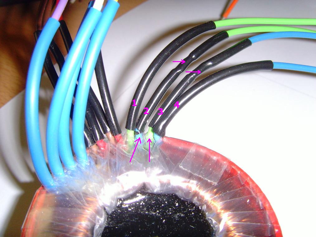

Gentlemen, the coloration - as is - of the transformer's leads has been requested by me.
Please have a look at the attached image.
You can see two secondary windings, with green and blue leads, labelled 1/2 and 3/4.
If you take a closer look, you can see that lead 2 starts as a blue wire ending in "green" and lead 3 starts as a green wire ending in "blue".
Connect the "blue-starting" leads 2 and 4 together resulting in 68VAC between the the green leads.
The same applies to the red and brown leads.
Connect the "red-starting" leads together resulting in 68VAC between the the brown leads.
Of course: use a bulb-tester before applying voltage to the transformer.

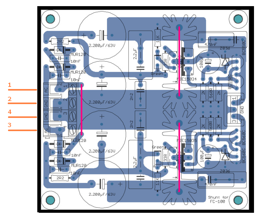

Now, looking now at the shunt PCB I can see that two taps are connected together and connected toground (i.e. they are not "floating"). So When recognized that, my first question should be: how to connect the transformer correctly so that at "the opposite sides" of diode bridge flows 68Vac and not 0 Vac?

Fabrizio, have a look at my post #418.
The attached image shows you how to attach one shunt-regulator to the "green" and "blue" secondary windings.
Do not forget to manually solder the pink wires on the solder-side after you have finished the Shunt PCBs.
