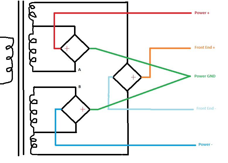

The grounding scheme with regulator for the front end Vcc/Vdd
There is no chassis and as a result no complications with extra connections to PE.
Hi Andrew,
You should connect A with E. Your topology is not suitable for ground separation between front end and power stage because there is only one common AC central tape.
Kind regards,
Mihai

Do you mean dual bridge per channel? I had never use that configuration.
Yes,
Dual secondaries into dual bridges into a dual polarity single channel.
Your PCB suits this.
Then adding a single bridge does for the regulator.
What does the hook up wiring look like, since you say the single bridge arrangement cannot be done as I asked?
Something like that? I don't think it's a good solution.
Where are you going to tap for frontend ground? If A and B points are going to be connected together in order to get the frontend ground then there is no point for dual bridge power stage.
IMHO, use a separate transformer for front end PSU
Roender.
That arrangement does not work.
The dual secondaries demand that the extra taps must also be dual secondaries and separate. The single bridge is not compatible with the dual bridge when joined at the AC side.
I have a separate transformer for the extra 9+9Vac. That is why it is shown without the common core "|||" in the diagram.
What I don't have is a Low VA, 35+35Vac to 40+40Vac transformer.
I do have a doubler that gets the 9Vac upto 80Vdc open circuit, that falls to ~60 to 70Vdc depending on the loading. Typical droop for a doubler style circuit. Dual 9Vac secondaries + quad doublers, gets me +-80Vdc separately. I can join then at the DC side and bypass the single bridge in the reg PCB.
I'm going to post those experiments in a new Thread shortly.
