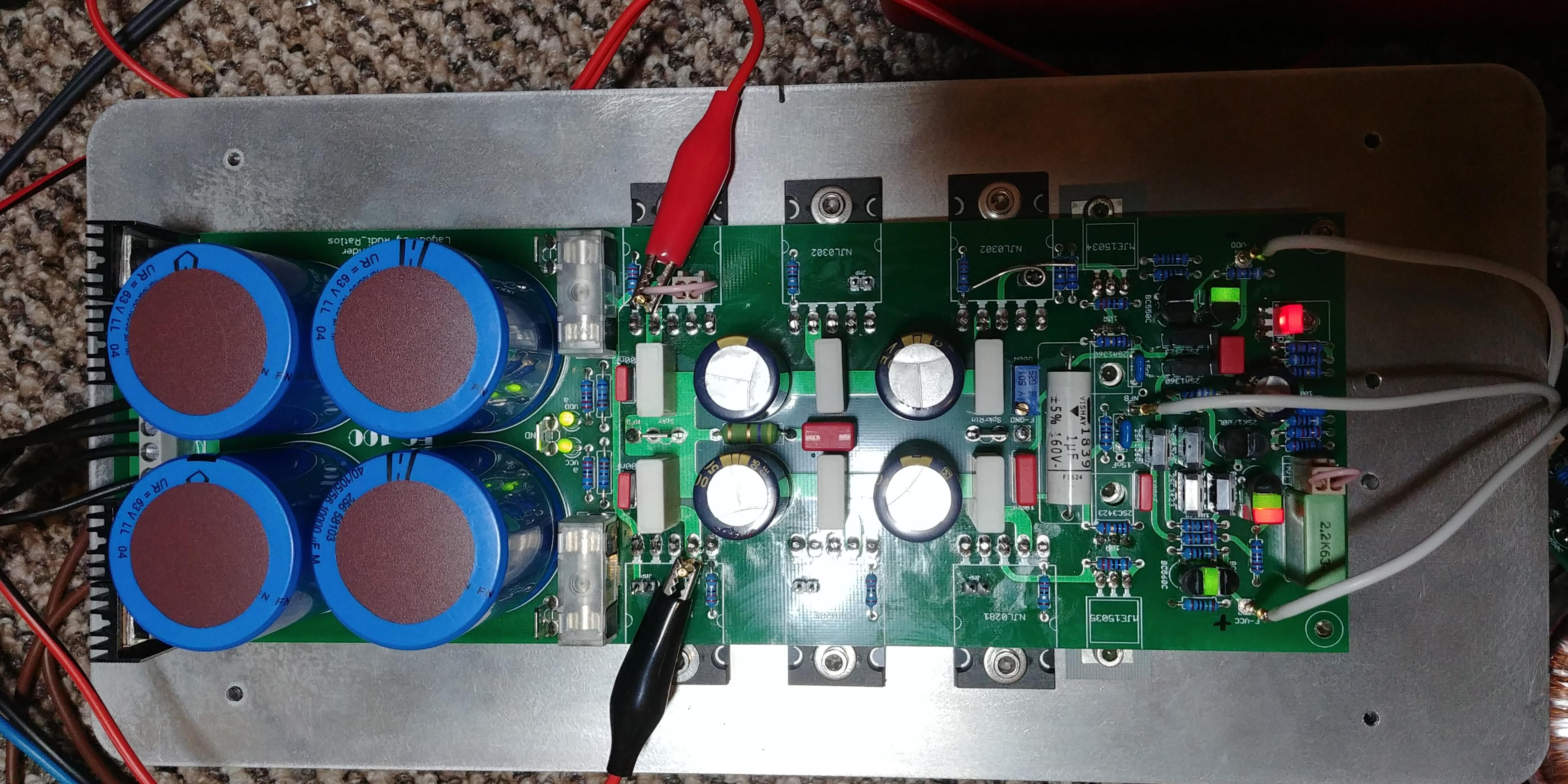

Hi All,
I wonder if somebody has experienced the same issues during first power on.
I strictly followed Rudi's build guide, checked all part prior to soldering.
The circuit seems to work fine, at least all diodes are lit initially.
However it is only when the voltage drop measured is 0.0mV.
When I try to increase the drop with potentiometer R22 it raises very rapidly to about 70mV. I tried to power on with one or two diodes shorted, similar result (with two diodes shorted I can keep it at 0.0mV, with one shorted the drop goes quickly to 70mV).
Do you think there is a fault somewhere or is it a matter of bypassing the NJE diodes?
I would mention that my transformers when idle give me 26v (not 25V), -/+37V after rectification, should this be a problem?.
I uploaded videos showing the power on.
20180226_220559.mp4 - Google Drive
20180226_221052.mp4 - Google Drive
20180226_220805.mp4 - Google Drive

Greg:
at first glance your build Looks quite o.k.
Did you solder (manually) the two wires on the solderside of the PCB to:
1) connect Frontend-GND to Backend-GND
2) connect the Negative Feedback
Please remove the wire to short the second thermal track diode and try to do the adjustment again.
I wish you success - Rudi
Hi Rudi,
I did solder the two wires as per your build guide (the red and purple line).
I will try again with only one thermal track diode shorted.
My concern is that the bulb lights not only when initially charging the caps but after several seconds it lights up again (70mV drop).
I assumed the pot R22 is to adjust the drop starting from 0mV going up to 38mV.
I can no way get this reading on my voltmeter. Its either 0mV or 70mV.
I don't want to accidently destroy the components, I guess it would be a real pain to get a new set of matched triplets!
Thanks.
Greg

Greg, I remember that there is a problem, when you run both the frontend- and the backend-PSU from behind a bulb tester that is connected to your mains.
Since you know that your frontend will not produce a short, run your frontend-PSU from your mains directly (without bulb-tester) and test again.
Regards - Rudi
Regards - Rudi
Thanks Rudi,
I found the fault. I connected the frontend-GND to NFB. Now it works however I can only increase voltage drop up to 20mV and then I reach maximum resistance of the potentiometer R22.
Do you know the best way to solve this?
Greg
Greg
