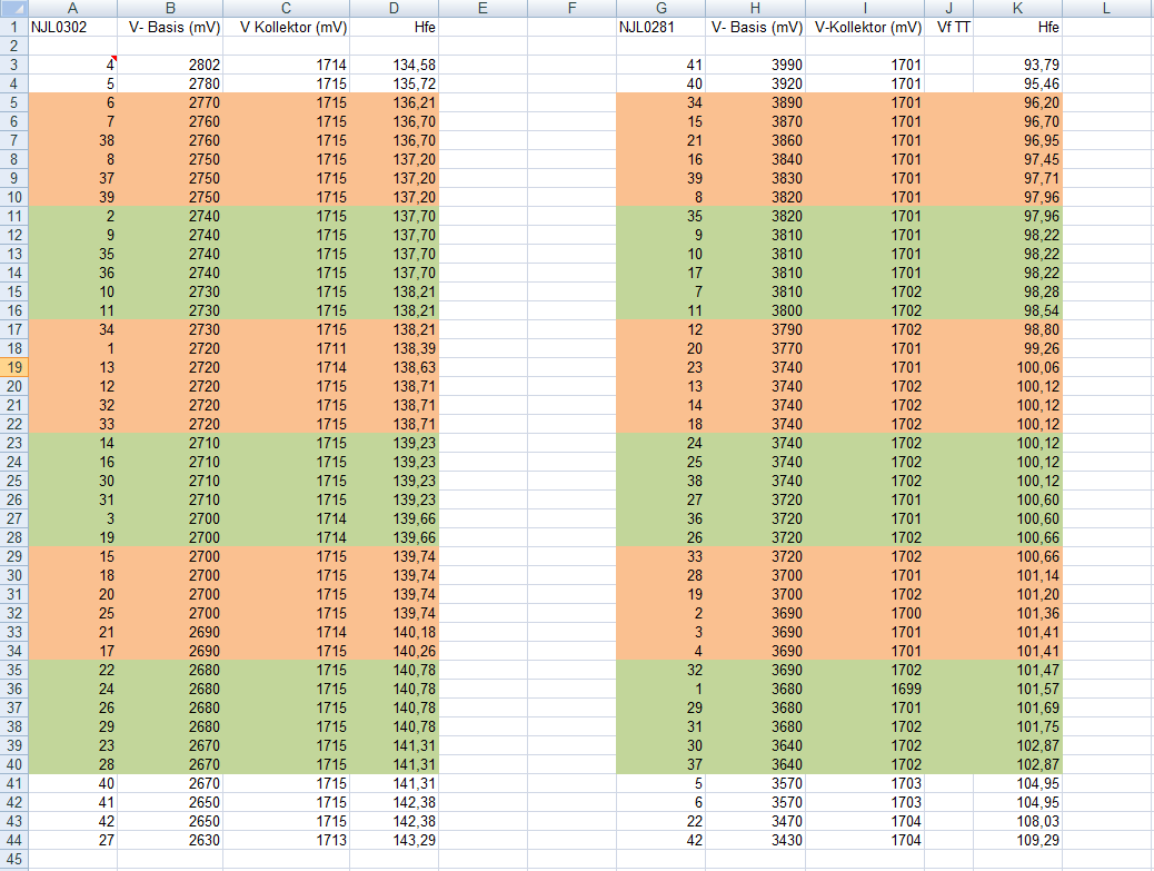

ok then... That will cost me lots of BJTs to be able to match them. I don't even know if I buy 20 of each that I'll be able to match them...

Matching closer than his limits is pointless between compliments. It would be nice, but what is critical is the match between NPN parts, and between the PNP parts. Normally the devices matching in a single lot is pretty close.
Matches between parts for MJ21195 and MJ21196 is a little wider between PNP and NPN parts, but very close within each polarity. I just bought 25 pairs from Arrow that are due in tomorrow to bring stock levels back up and allow for a decent yield for matching. I still have 9 pairs to go through, but it doesn't pay to wait until you're close to out of stock these days! My order is coming from two different warehouses as it is.
Expecting any better is hand wringing for no reason. Back in the 80's, parameter spread was huge, even for premium Japanese parts. Stocking outputs was no joke in those days no matter from Motorola or Toshiba. I had thousands tied up in parts inventory. Gee, I have that today as well! I guess you get numb to stocking parts when you are used to times that were a lot worse. By comparison, devices today are a dream come true.
The fact is that today, we are spoiled by how good parts like output transistors are. 2:1 beta ranges between NPN and PNP parts are common and always have been. The dream devices were MJW0302 and MJW0281 as they were all clustered around 100 for a beta reading. I wish they had not discontinued those parts. They were the best I had ever seen by far.
The voltage amp section will compensate for the 2:1 beta difference between those parts. You only need to worry about each polarity, and that is where matching really counts. Polarity matching is nice to have but completely unrealistic to expect.

Do, I have measured/matched hundreds of NJL0302/NJL0281 transistors in the past years.
I have attached the results of matching about 50 transistors of each type a year ago.
I have measured the transistors with a test-rig that I have set up especially for measuring/matching.
I have measured with the collector current resulting in about 170mA.
According to my experience it is "impossible" to "cross-match" NPN and PNP.
You will be very lucky, if you find 2 "matched" triples of each, when you buy 10-12 pieces of each.
