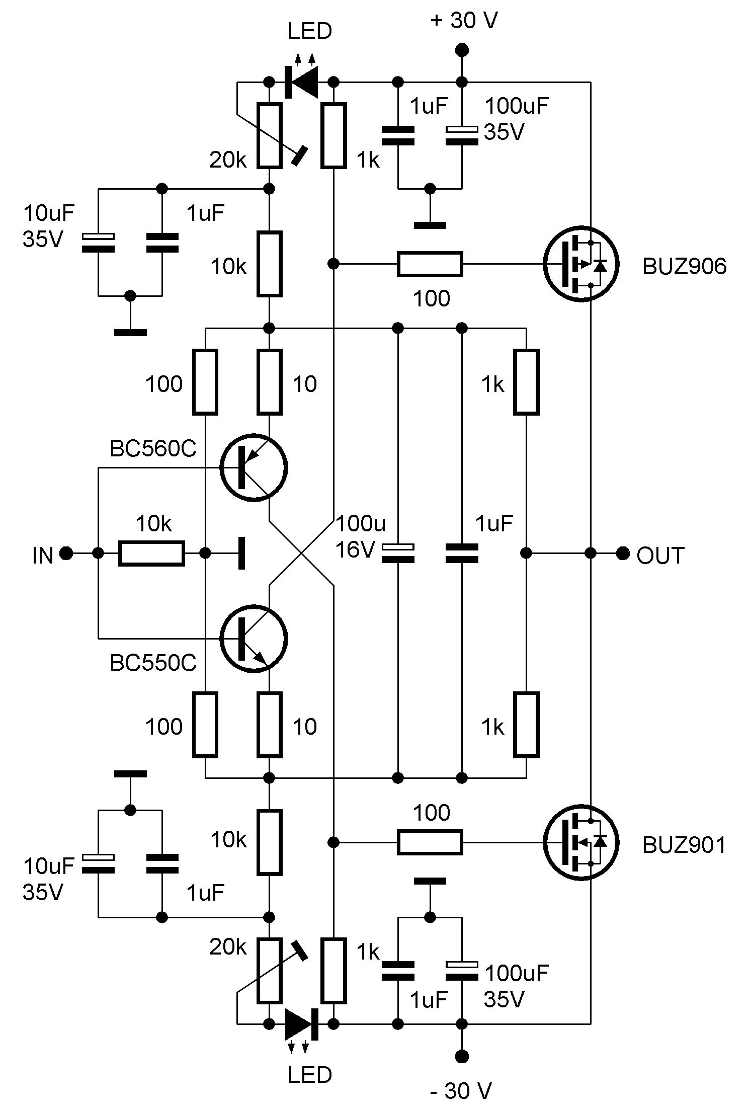

Here is the circuit (apologies if I transgress a forum rule about other people's circuits).
Note that this circuit is for the p3, not the p3a.

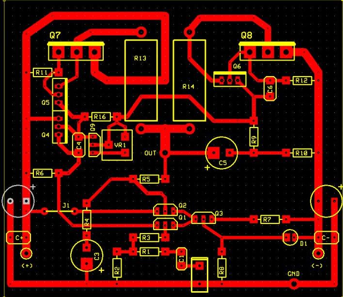

I've edited the layout to some extent keeping your points in mind and i hope that I haven't f**ked it up!!

Hi Paranoid06
Really nice work, one more comment:
A sensitive node (to both pick-up and stray capacitance) is the feedback to the input pair (the common trace(s) connecting R4, R5 and Q2's base).
Try to minimize the copper used for these connections. There are numerous ways including moving C3 with another vertical ground trace.
Have fun and good luck
-Antonio
First thing to do - look at the picture of Rod's board. Even though you can only see the top side, you can see how he has placed components. Use this as a hint.
Traces - use 1.27mm traces all around apart from the power and ground traces - make those as wide as possible, at least 2.54mm wide. The bypass capacitors should also be close to the output devices.
The big looping circle around Q7 from the power rail - shorten it. Take the track from the centre collector pin to the resistor from the other side.
Compensation caps C4/C6 - get them as close to the device as possible. Practically right on the pins. Dont worry about using fancy silver mica capacitors - good NPO dielectric (low K) ceramics will work just as well.
Put Q9 right next to Q5. You can move Q4 away a bit. Keep the TO-220 devices horizontally aligned.
R11-R12 - these feed the drivers, so make the track go from the resistor, to the driver collector pin, and then from the driver collector pin to the outputs base pin.
R9-R10 need to be 1W resistors, so you need a larger part spacing there.
C1 - too small a spacing. I found a Wima MKS2 3.3uf 50v polyester capacitor works well here. That is a pin pitch of 5mm, and a diameter of about 7.5mm. If you want to use an electrolytic capacitor there, that will also fit.
You appear to have left out C2. It's important.
You should be able to use a board thats half the size you currently have. It just takes practice. Expect to lay out the design a good 5-10 times before you get it right, if this is your first attempt at designing a PCB. It was my first attempt too, I think I got to version 6 before I was happy 🙂
well ...it seems that from the things i told you you have done almost nothing.....
your pcb will work ( produce sound) as is as i said if you are aiming to really high quality sound this pcb cannot go there
jay cee has given you also some useful advice....
--- you use a jumper to supply Q1-2 which is actually ok but proximity between traces is not right .... you can actually do that better
--- Making such a big circle around + rail around the power transistor is not OK ...better with a jumper
--- you forgot to relocate C6
--- you was advised to make Q1-2 go face to face .... it works better for mechanical reasons not one behind the other
--- you was advised to move Q9 close to the driver
--- Finally the all pcb can be rearranged to be more more clean and reorganized see how others did and see what you like to keep
