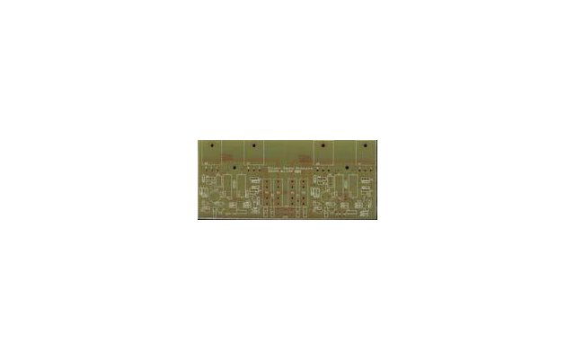

Rod Elliot P3A Layout - Critics
Have you pruchased the parts yet? If you have them in front of you while you are doing the layout you can measure and play with them. This helps things go faster, reduces mistakes. How about ground plane? I would use a coper fill on top and make the bottom solid copper with the two sides connected.
Your layout is not bad at all, components are to widely spaced, squeeze the whole amp, it will aid in shortening signal paths lengths. Your board can easily be shrunk by 50% and could look and work quite smartly.
U-Shaped heat sinks will not be good enough for your application, need something a little more substantial. Try changing R13/14 orientation because their far ends will short against the heat sink if it were mounted vertically. Also provide some securing mechanism for the heat sink, you cannot hang them off the transistors, you need some form of support.
P03A Image
Here is an image of the P03A PCB from Rod's web site. The image is open to the public so I am not infringing Rod's copyright or IP. Normally, I would, and do, suggest buying Rod's boards, as I do, but a poor 15 year old needs a little bit of help.
You can use this image to use a guide for parts placement then link up the pins.
Ian, the reason I posted the image was because I thought if the OP had seen the PCB, he/she would have made an effort to copy, to a reasonable degree, placement of parts and work from there. Seems sensible to me; why re-invent the wheel?

For learning and understanding how to position components on a pcb, go to the Symasym designed on this forum. Look at its schematic and the pcb and understand what is going where and analyse with whatever your wisdom permits. Now u will find your pcb is resembling like that of the experts. Just give it a try.
At your age, u should be quite smart posting here.
Also remember, u have to lay the filter electrolytic capacitors as close as to the output transistors.
I have already given a try to copy the layout earlier, but the pic distorts really very badly.....so its difficult to analyze!
Gajanan Phadte
I have no idea what you are talking about, I tired searching 'symasym' but i didn't find anything pertaining to this topic...Please Elaborate!!

I've read Rod's description and it is indeed possible to get away with not mounting the Vbe multiplier on the heatsink. In this case anyway.
As far as I know this is always the case with CFP/Sziklai output stage amps.
According to Self, only the drivers' temperature influence the quiescent current, and the multiplier should be on the same (small) heat sink as the drivers.
This cannot be the same heat sink as the output devices.
I have a p3a clone in service for about a year.
The drivers do not have a heat sink, but the multiplier is located just next to one of the drivers on the board, almost touching.
If I recall correctly, quiescent current is relatively stable after 15 minutes or so.
For sure there is no thermal run-away.
I'm not sure about that. The Vbe multiplier does not need to be on the same heatsink as the output drivers, but it still needs to track the temperature of the pre-drivers. Randy Slone explains this rather better than Douglas Self - I have just checked. Not mounting it on any heatsink can work, but not every time.

Here is the circuit (apologies if I transgress a forum rule about other people's circuits).
Rod describes it as follows:
The circuit for the bias servo (actually the whole amp, with some of the other mods I have mentioned elsewhere) is shown in Figure 1a - notice that I left the diodes in circuit as a fail-safe, since the servo I used will go open circuit if the pot wiper becomes disconnected (I strongly suggest that you do the same). In practice this works extremely well, and I can set bias current to anything I like.
Those diodes in parallel with the bias servo (a.k.a. Vbe multiplier a.k.a. amplified diode) changes the picture a bit.
But wait, there is more:
Variations in supply voltage will have an effect on Iq as well. I hadn't actually considered this much (I have never had one of these amps self destruct, and normally don't even bother measuring the quiescent current). The variation is caused because the Class-A driver current is not derived from a true current source, but is a simple bootstrapped circuit. Since the current must change with voltage, so must the voltage across the diodes (or bias servo).
If there was a current source instead of the two 2k2 resistors the Vbe multiplier, things changes again. With the current through the bias servo constant, something has got to give.

We can now start analysing this thing to death, but let us not confuse the OP. The circuit works well as it is and as long as it is not changed everything will be fine.
