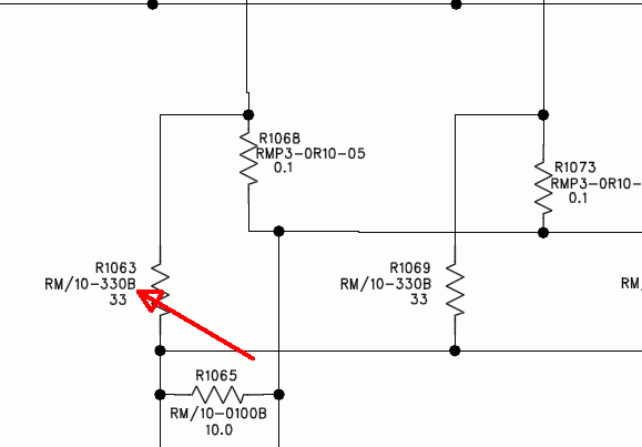

They should be 0805s. Wait until you get the diagram, it will tell you what size they are. There is a suffix on the part number on the schematic diagram. The following show the various sizes:
B = 0805 (0.080" x 0.050")
C = 1206 (0.120" x 0.060")
D = 1210 (0.120" x 0.100")
The image below is an example from a different Rockford amp.
okay i got my schematics in today, i cannot seem to find the numbers off the pc boards on the schematics. is it possible they are abbreviated? like r59 for r2059? or i am just not looking hard enough? thanks
