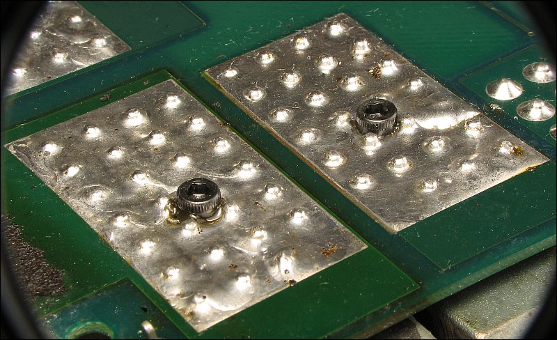

i might ad also , that while fixing the amp i came across the B+ terminal, and found it was super loose with next no no solder on its pad, i soldered it best i could as the block kept sucking the head from my soldering iron.
the amp didn't cut out before with the problem of the loose power terminal, but do u think this may be an issue now/

That could be a problem. These terminals can be very difficult to solder. There's a plating on them that deteriorates when they overheat when there's a bad connection. Even if you can get enough heat, it may be difficult to get solder to stick to the pins. A new terminal block is (was?) available from Rockford. Now you'll likely have to buy it from PacParts if you can't solder the one you have.
To heat it, you'll have to use the butane torch. Heat it ONLY from the component side of the board. Do NOT heat it with the torch from the solder side of the board. Using the torch and your soldering iron, you should be able to get it hot enough to solder the pins.
You have to be VERY careful when doing this. Make sure that everything is completely stable. If something shifts and the terminal block slips out of the board do NOT try to grab it (normal reflex). Let it fall. I generally drill and tap them to put a screw in to hold them but that requires a bit more effort. See attached.

i will try and better solder the terminal, its not loose anymore, but in no way soldered like the picture.
