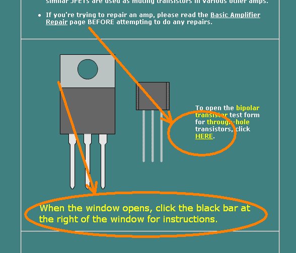

You need to check them with the black on one leg and the red on another leg.
On the following page, go to the bipolar transistor section and open the link indicated in the attached image. This section is for bipolar transistors but the lead placement is the same when checking either type of transistor initially.
Basic Amplifier Repair - Transistor Test Applet Link
Post the values (or screencaps of the form with the values) for one power supply FET, the first 28n you listed and the second 36p you listed.
Which FETs have you removed from the MEHSA insulators?

i have already remove the (4) u1620's from not only the mesha boards but the from the amp its self, and tested them outside amp, and still they appear bad. and basically from what your article says all my readings that are 0 are bad, and some of the items reading an actual resistance may still be bad?

The quickest way to test the output transistors (FQA28N15-FQA36P15) is to place black meter probe on leg 1 (right leg) and red probe on middle leg. Then black probe on leg1 and red probe on leg 3 then finally black probe on middle leg and red probe on the 3rd leg. You should read nothing near 0 ohms.
If you arent sure if its defective or not pot your results as followed
Leg1-2:
Leg1-3:
Leg2-3:
Do this with all outputs and all power supply fets.
