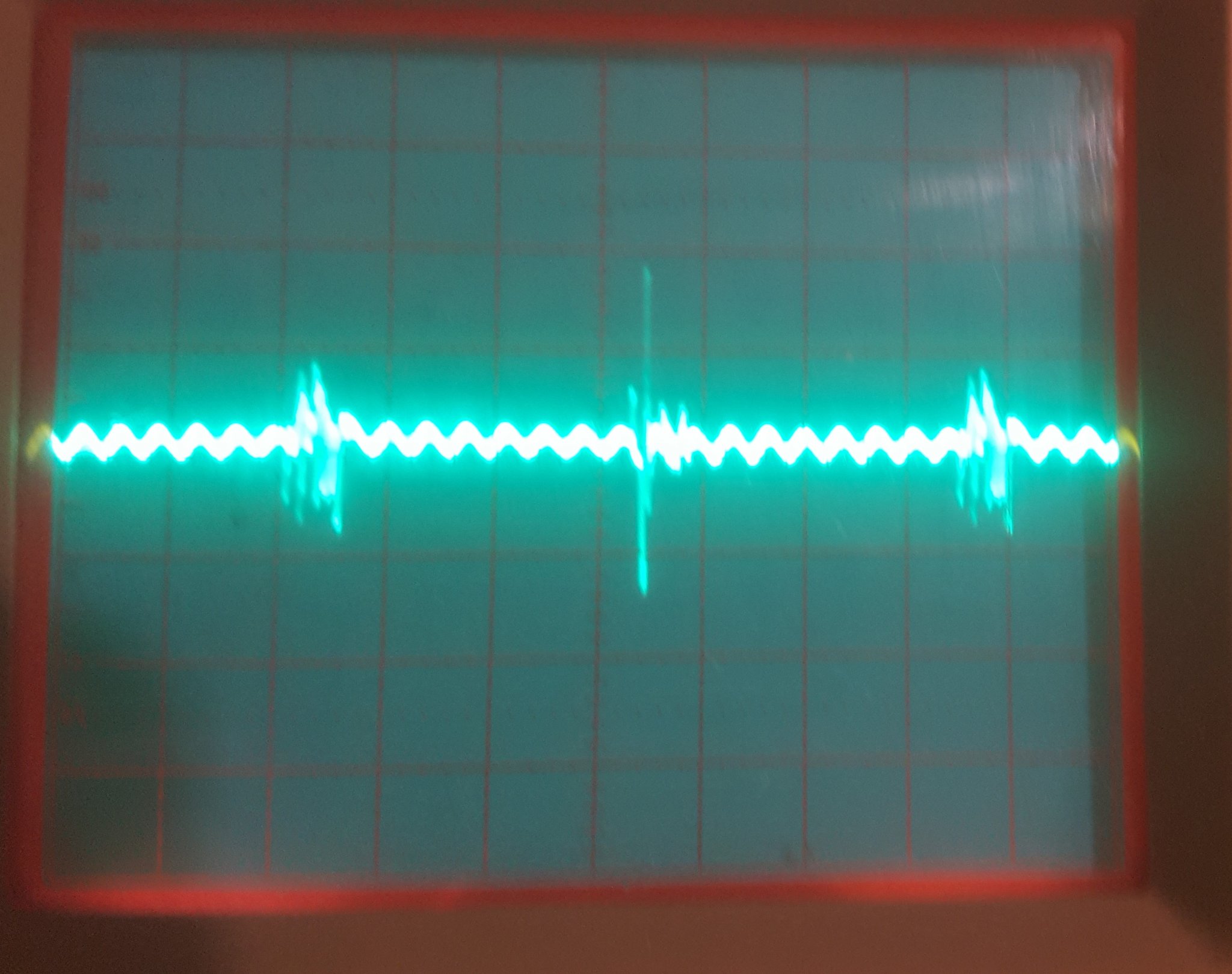

All measurements: 0.1 V/Div 5 uS/Div
Using probe ground on non-bridging speaker terminal as reference.
No treble boost on this amplifier.
Adjusting gain does not change anything.
Low pass and full pass positions do not change anything.

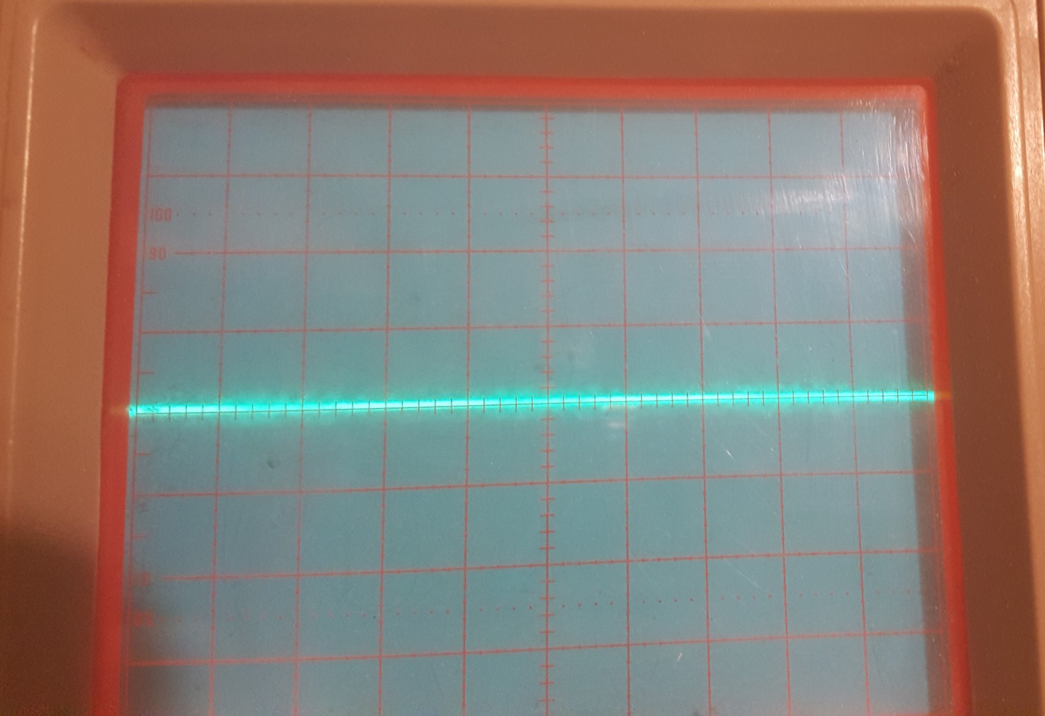

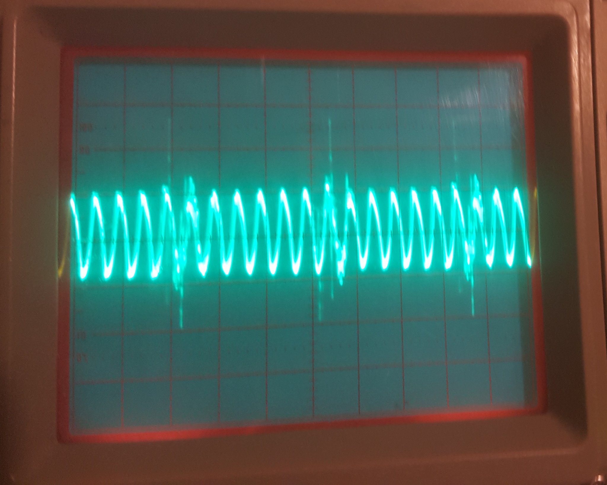

Yes, it flattened out to resemble Ch 4 above then as soon as the P.S. ammeter bumped up it changed to the image below and stayed that way until I cycled the remote.

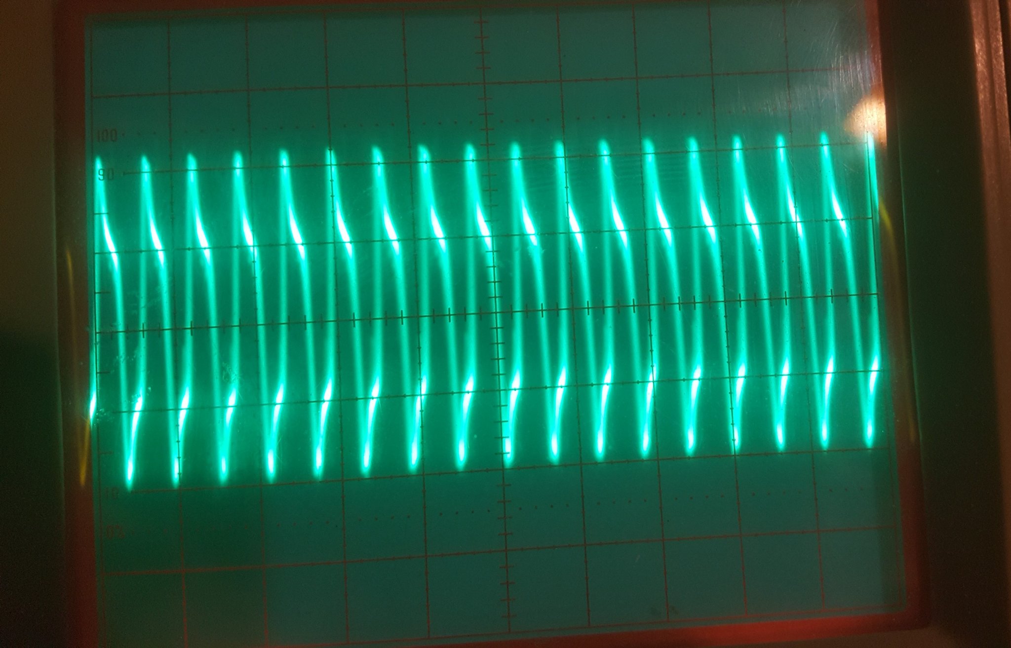

1.05 mV across the resistor in image, after I cycled the remote the voltage across the source resistor read 0.04 mV although the pot was not adjusted.
0.1 V/Div and 5 us/Div
It appears that the oscillation is what's causing the increase in current draw and it doesn't stop until the supply is shut down.
