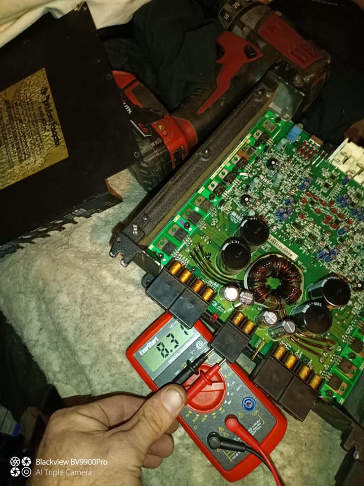

I have one resistor that I think is out, but the top looks damaged and I cannot read the value. I know it starts with 30x and reads 8.4k with the meter. Of course the designation R92 is not on the diagram we have been using.
if there's any way i can help you out, i have a fully working 400a4, (non-x-card version) i was about to see how much i could sell it -as-is its not vary shinny outside anymore - but still works 100% .. but i can identify any chips or such for you ...
