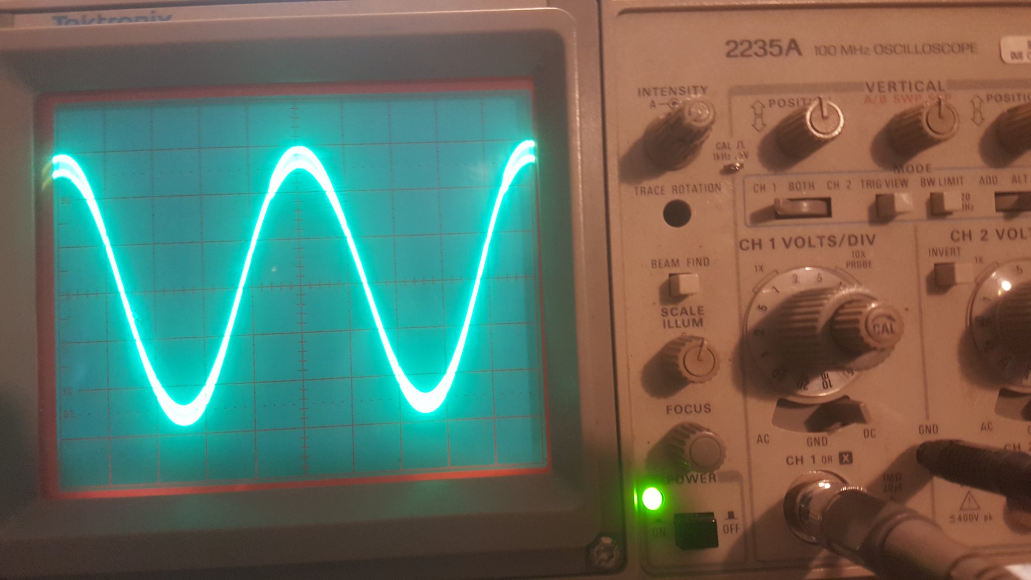

If you drive a sine wave into the amp, is there any distortion in ch4 with the pot at the fully CCW bias position?
If you heat the amp up (including the heatsink and outputs, during bench testing), does the bias hold on ch4 from room temperature to near thermal protection?
I remember someone else having the same problem on a 4ch rockford amp so this isn't the firt time this has been a problem.
The top and the bottom of the sine wave is 'fuzzy/wide', attached is the image, 1 kHz sine wave, bias pot full ccw.
To get voltage back to 0.040 mV after turning pot full CCW I had to cycle the remote. It was at 1.8 mV from previous test.
What I also noticed is that with pot full CCW and reset to 0.04 mV , when signal was feed into to get the pic below, the voltage jumped to 6.1 mV, but when the input was removed the voltage dropped to 2.8 mV and stayed there even though pot was still full CCW.

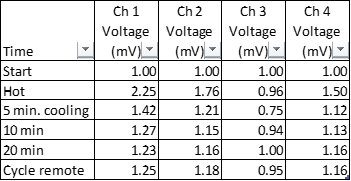

This morning while at room temp the voltages on all channels were 0.7 mV +/- 0.1 mV.
I set them at 1.05 mV +/- 0.03 mV and I am about to test it with music with all channels loaded with dummy loads.
Should the voltages still be at ~ 1.0 mV when the amp is hot?
If they have risen should I set them while they are hot to 1.0 mV? I know there is a mention of this in the tutorial, but I think the wording used was a "significant increase when hot", just making sure what is significant.

Oscillation would appear as a widening (vertically) of the waveform. There was some evidence of it on the waveform you posted but that can be due to incorrect biasing. The frequency of oscillation, as well as the amplitude, can determine the amount of current draw for a particular amp. Technically, there should be no oscillation for this class of amp.
For some class D amps, there is enough carrier wave leaking through the output filter to look like there is a problem but that's entirely different than what we're dealing with here.
Ran the amp for an hour. Removed signal and took below measurements at various times. After test amplifier idled at 1.2 amps.
After taking voltage readings, I input a 80 Hz sinewave and a 1 kHz sine wave.
80 Hz, oscillation top and bottom on all channels. Greater amplitude than image in #24.
1000 kHz, oscillation similar to image in #24, on Ch 3 and Ch 4. Ch 1 and Ch 2 'sharp' sinewave.
What do you think?

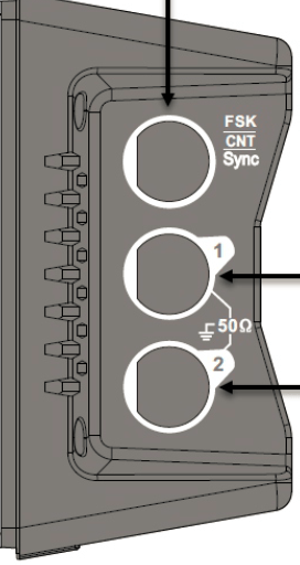

What's the resistance between the input RCA shields and the primary ground (no RCAs plugged in).
Does the signal source have grounded shields?
If you set the amp to low-pass and drive a signal (80Hz) into it, do you still see the oscillation?
In full range, does the oscillation on the output change if you bridge the front/rear shields with a jumper wire?
956 Ohms on all channels.
I am not sure. It is a mains powered signal generator. It uses a bnc to rca cable to carry the signal. The plug is two terminal as is the power supply, so I am thinking they are isolated from one another. Is this correct. Attached is what it looks like.
You didn't give the make/model so I don't know precisely what you have. Try connecting the ground (should be somewhere in the case of the generator) to the ground of the 12v power supply.
It is a UNI-T UTG932.
https://www.amazon.com/UNI-T-Generator-Arbitrary-Dual-Channel-Frequency/dp/B08SJNLJCM
I may have misunderstood. When you say in the case, are you saying to open the case? If I disassemble it, I will void the warranty by breaking the warranty seal.
I don't see a ground. The best that you might be able to do is to jump the BNC case to the 12v PS ground.
low-pass 80 Hz, I can see it on all channels. When I ground the shield of the generator to the power supply, Ch 1 and 2 it disappears. Ch 3 and 4 it improves by ~ 75 % reduction.
Full pass 80 Hz no difference jumping rca shields.
1 kHz Ch 1 clean, Ch 2 minimum, evident on Ch 3 and 4 about the same as original image #24. Audible humming on all channels, ( not sure if its coming from the transformer or not). When generator grounded to power supply oscillation shifts from top of sine wave to bottom of sine wave or vice versa, depending on which channel. i.e. Ch 3 is opposite of Ch 4.
