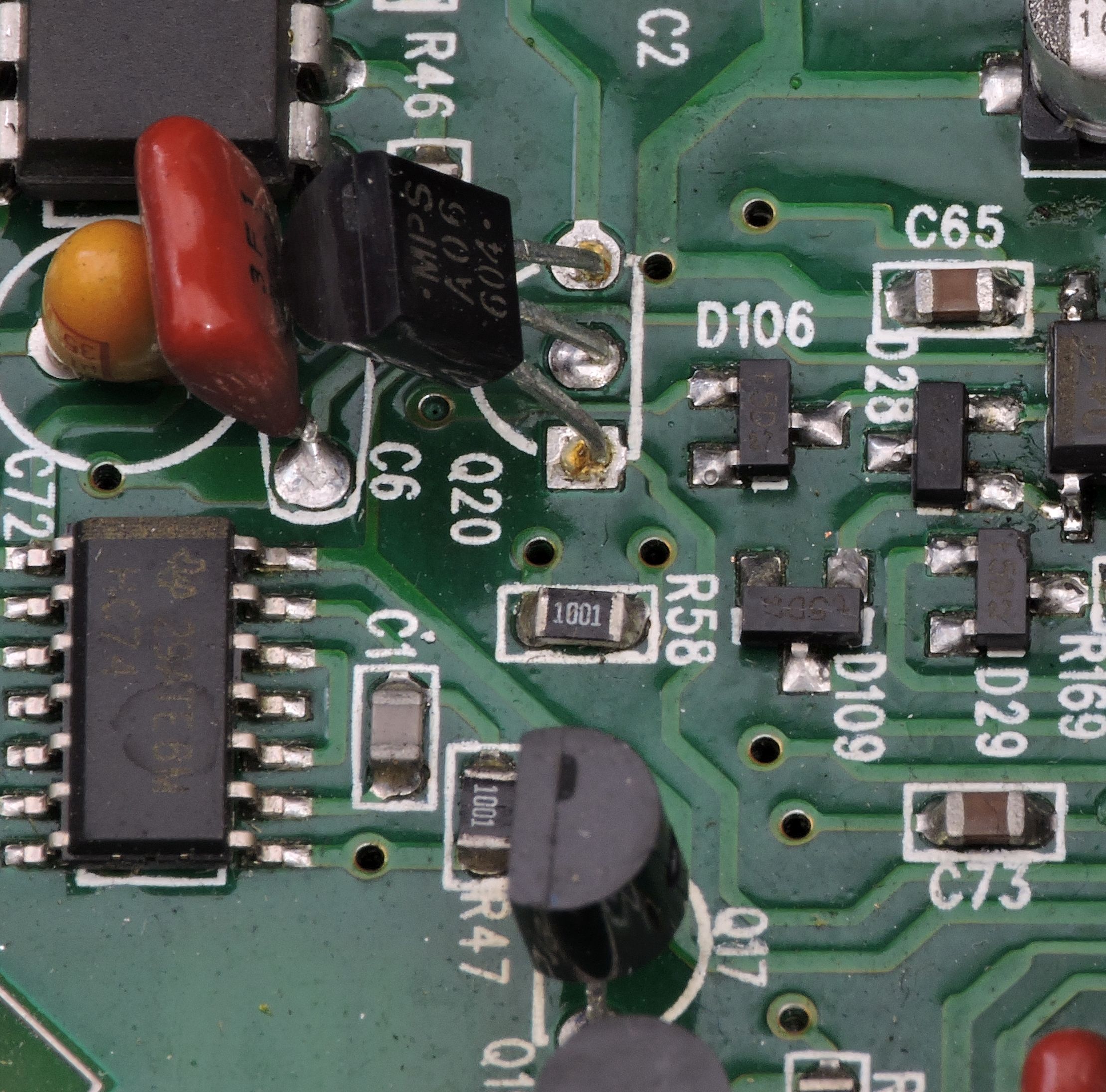

I replaced all transistors on both sides of the board, 3205, 3415, 6215, also the four rectifiers 1520's. and all the gate resistors also. And the drivers Q17, 19, 20, 21.
No i do not have a scope, i have only the basics, All the output transistors are in the mega ohms range.

DC voltage on all terminals of Q17 and 20.
yes just remote and ground. ok so on:
Q17
1-2 -4.83v
2-3 4.83v
1-3 74.8mv
Q20
1-2 6.85v
2-3 4.76v
1-3 11.61v

Ok so 1 being closest to the B+ and neg.
Q17:
1=72.9mv
2=4.85v
3=.3mv
Q20:
1=11.7v
2=4.85v
3=73.3mv

Also perry the driver Q20 was burnt when i removed it, it fell into pieces, im sure thats relevant somehow.
ok so here are the values:
Q20:
1=2.46v
2=4.86v
3=11.73v
Q17
1=2.45v
2=4.86v
3=.03mv
Q20:
1=2.46v
2=4.86v
3=11.73v
Q17
1=2.45v
2=4.86v
3=.03mv
There is too much difference between the bases and the emitters. Compare to the other pair of drivers.
These are the values of all now.?
Q20
1=4.91
2=4.91
3=11.72
Q17
1=4.91
2=4.90
3=.3mv
Q21
1=5.17
2=4.86
3=11.72
Q19
1=5.17
2=4.86
3=.3mv
