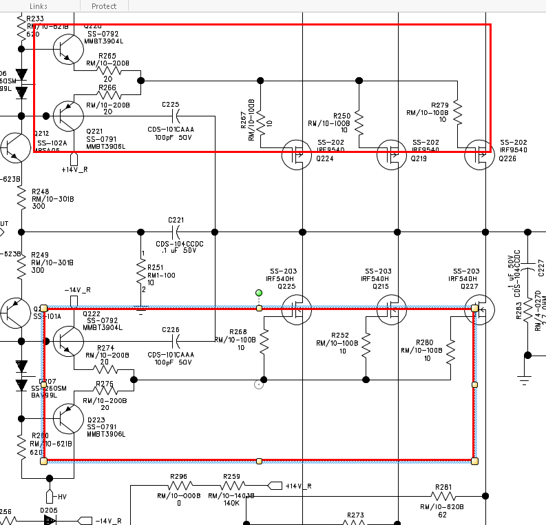

Did you check the driver transistors for shorts and open junctions?
Do you have a scope?
I checked R265,R266,R267,R250,R279
R274,R275,R268,R252,R280
Is there something i missed?
No I do not have a scope yet.
You have to check all parts in the red rectangles (and maybe others).
For Q220,Q221,Q222,Q223 do I test for voltage passing through? or iam I checking for the one leg of the diode?
You test to make sure that there are no shorted junctions and no open junctions just like any other BJT transistor.
I belive that Q222, and Q223 are bad. They are open both ways on both legs.
Would these be good replacements?
MMBT 3906 LT1 Infineon Technologies | Mouser
SMMBT3904LT1G ON Semiconductor | Mouser

I replaced Q220,Q221,Q222,Q223, and iam still getting distortion on the right channel.
The only thing that I havent replaced in the red box's Is C225 and C226. Could these be causing the distortion/static?

Without seeing the distorted waveform on a scope, it makes it difficult to know where to check. At this point, you're left to compare readings between the two channels.
