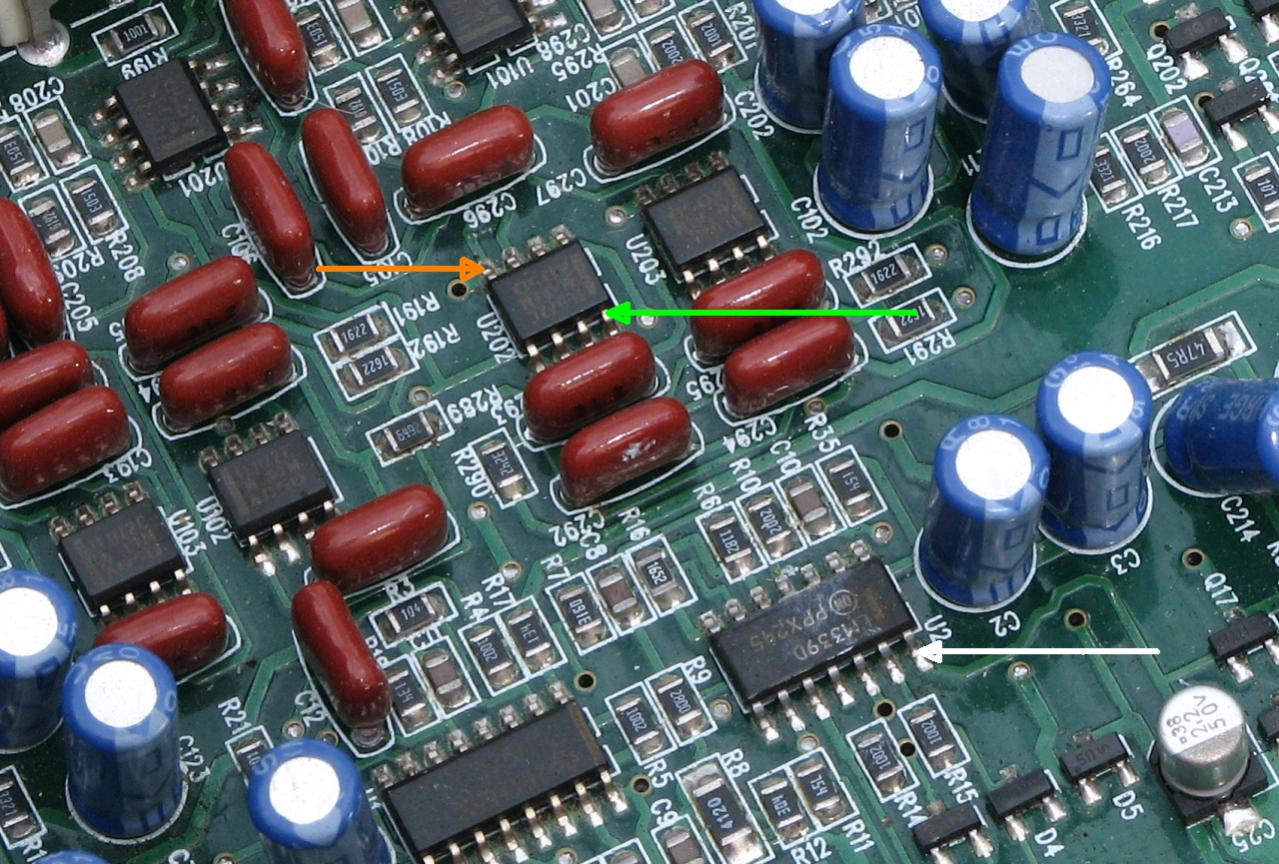

Do op-amps have board designations beginning with U? For example U101-A?
This might be a good point to end for the night because I will need to study up on where all of these test points are.
See attached.
Ahh ok. That is certainly helpful. How many are there to measure?
The marked ones should be enough.
Ok, thank you. I'm getting pretty sleepy so I will measure them tomorrow night. Thanks a lot Perry.
The Various Op-amps are showing -10.31 on pin 4 and +11.86 on pin 8. They were all consistent.
The LM339 pin 14 is showing open.
Pin 14 open? What was the DC voltage?
After a second or so, it just goes to 1. Sometimes it will have a quick voltage before it goes to 1. but, it hasn't been a consistent voltage. I keep trying over and over.
Did you have the meter set to DC volts?
Did you try the other meter?
Yes, I tried both meters because I didn't expect that reading. Confirmed DC voltage is set on the meter. If I leave the lead on there and remove amp power, it then will return to 0V
Set the meter to a higher range.
I'm embarrassed I didn't think of that when I saw that goofy reading. I was set on 20V and expecting around 10V
DC voltage is 24.8V
Find R122 and R276.
Before the voltage goes high on pin 14, the voltage across those resistors should be low (0v?). After the voltage goes high on pin 14, you should read approximately 10v across those resistors (both probes on the resistor). Is that what you have?
