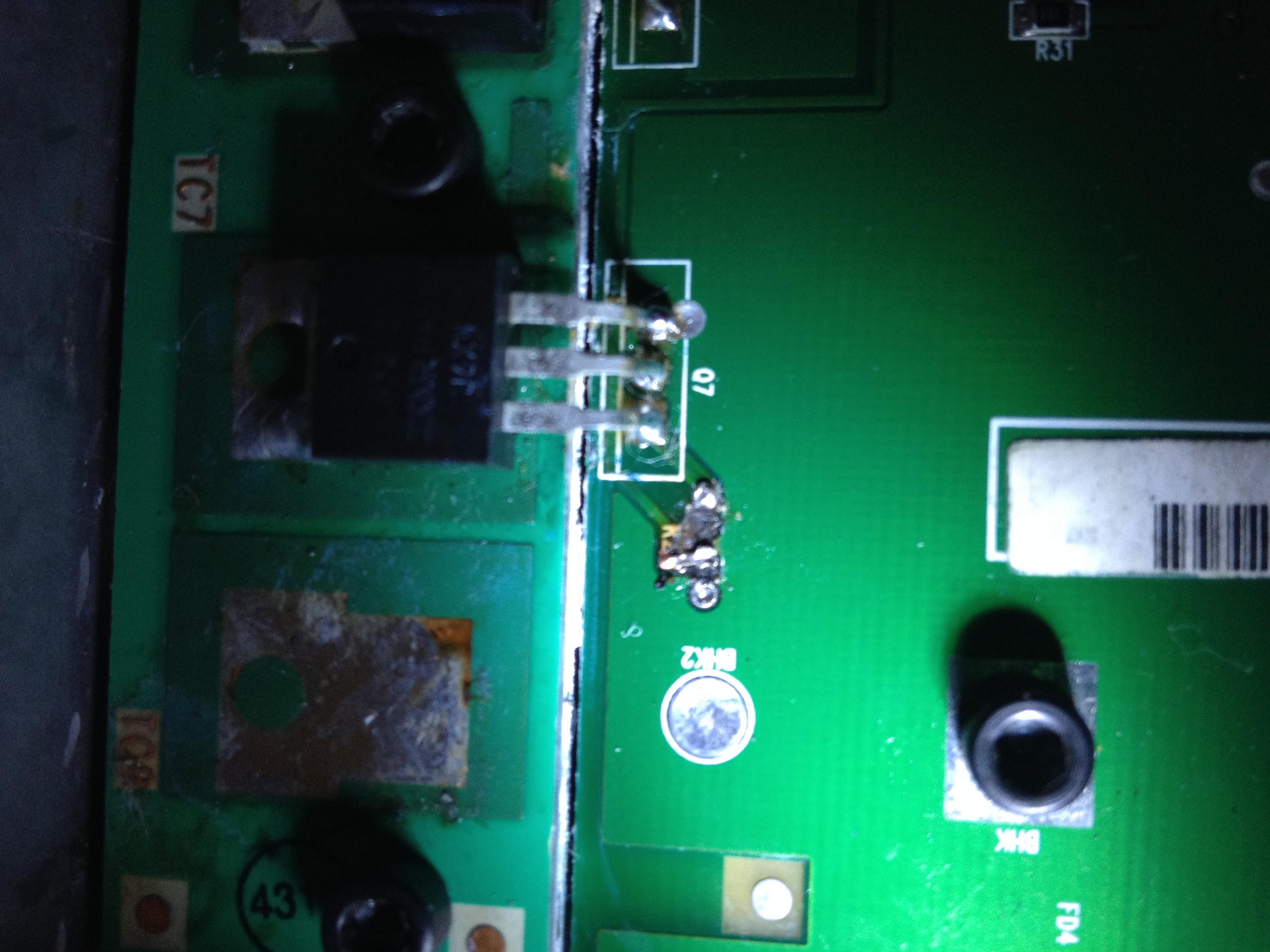

I just noticed that R20 I must have lifted the trace off the board when unsoldering. I can't get continuity between it and Q7. I'll have to repair that. It looks like if you take all of the screws out, you could lift the whole board assembly right out of the heatsink? I could maybe fix that broken trace underneath?

Can you post a good quality photo of the area around R20 (after cleaning the area with alcohol or acetone and cotton swabs)?

No, I removed the board when replacing the 3205s. That resistor (R20) had fried originally. I'm not sure if the trace was gone then and I didn't notice or, if it went the second time I removed it to check Q7 again.

Actually I think I made a mistake. The bottom trace in the picture goes over to Q2. It does still have continuity so it might be ok. The top one in the picture goes to Q7 and does have continuity with Q7. It might still work
