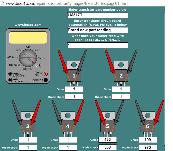

I've received my new parts. I decided for a good learning experiment I would measure and record the parameters of each new transistor.
I noticed a big difference in the drain to source resistance in test number 6 on Q8 for the new one and the removed original. Everything else was close. What to make of this? I'm thinking the original is good but, it does show about 600 ohms more in the test.
Q8 and Q9 are not transistors. They are voltage regulators and are actually integrated circuits (multiple internal components - see attached). They cannot be tested like simple transistors.
Ahh I see. I knew from ordering them that they were regulators but, I never gave any thought that it couldn't be measured in that way. I'm learning a lot with this repair. I suppose I should just change it while I have the little daughter board out of the amp. Do regulators fail often?
The regulators sometimes fail but it's rare because they have all sorts of internal protection (described in the datasheet, if you want to look it up).

Thank you Perry. I might just leave the original in. The other side I changed everything. Q6, Q9, CR2, Q215, and Q219. Q115 and Q119 out of circuit measure very close to the new ones so I believe they are ok. I can see they have been replaced before. I bought this as a refurb so I'm sure that's when they did it. It's looking like the IRF 3205 and the U1620R should be all I need to do on this side.
