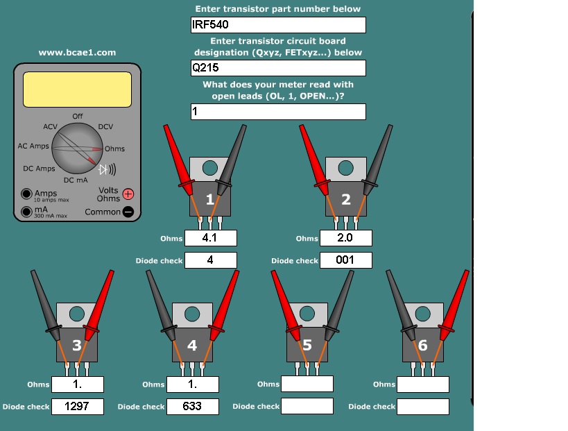

I was reading through your tutorial on amp repair. Great job on that. Very informative. I followed it and took some measurements. Q6 and Q7 are obviously bad so I know I will be ordering those. R20 by Q7 is visibly damaged and has audible continuity. It has a 330 on it and from reading here I believe it's a 33 ohm gate resistor. The other gate resistors seem to be measuring accurately but, if they are cheap, I may just order some in case. I took all measurements in circuit. I read where that might throw it off. I may cut the legs of the suspect pieces and remeasure.
For now I tried your form on the IRF540s. They are quite different. I'll start with that and see what you think.
That 540 is definitely defective.
