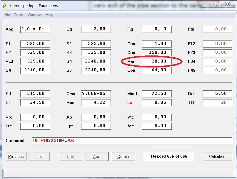

Anyone knows on how to compute for the expansion at S3-S4 (marked in red)? ROAR cab
I usually use "PAR" in that section in Hornresp. The section length is from the very exit of the pipe section to the center line of the driver(s). It is close enough when compared to actual real life measurements.

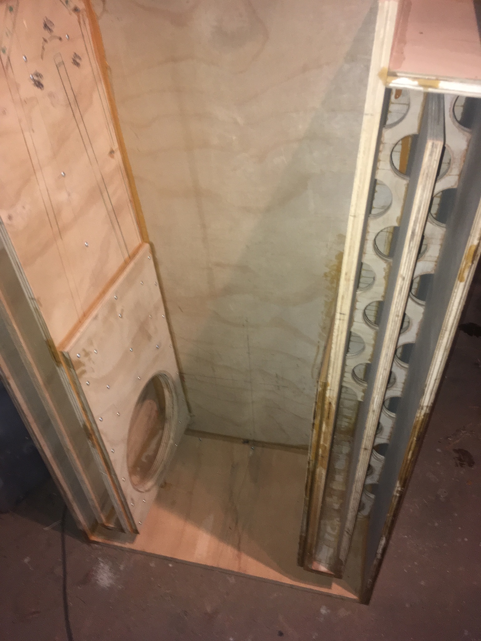

my first real speaker build, a single ROAR 15 (15mm edition) with 15TBX100 to complement a pair of no-longer-active-speaker bi-amped Proel Flash12As.
We tried the combination outside with somewhat reasonable sound volumes as the neighbors are very close and the first results are very promising. No measurements done yet and equalizing so far done with ears only 🙂
first proper testing at an empty lot in industrial area: the current 2.1 configuration works really well for EDM-style music, still tuning by ear. I already have Umik-1 and REW, I just need to put them into proper use. At the moment getting any reasonable sound for metal at higher volumes requires some further tuning.
First proper use: popup party at a somewhat remote part of the city, attracted apparently roughly 100 people, great feedback on the sound system, was shut down by the police due to numerous noise complaints in the early hours. Closest houses/apartment buildings at ~500m.
Power from a portable 2KW generator, ROAR 15 powered by a t.amp E-800 in bridge mode, DCX 2496 as cross-over. A lot of the stuff has been bought used, just seeing what kind of setup we can get for reasonable money for the DJ in the family.
I have another 15TBX100 waiting but I cannot fit two ROAR 15s in my car so I'm not sure when the other one will be built.
So far a very successful project 🙂
