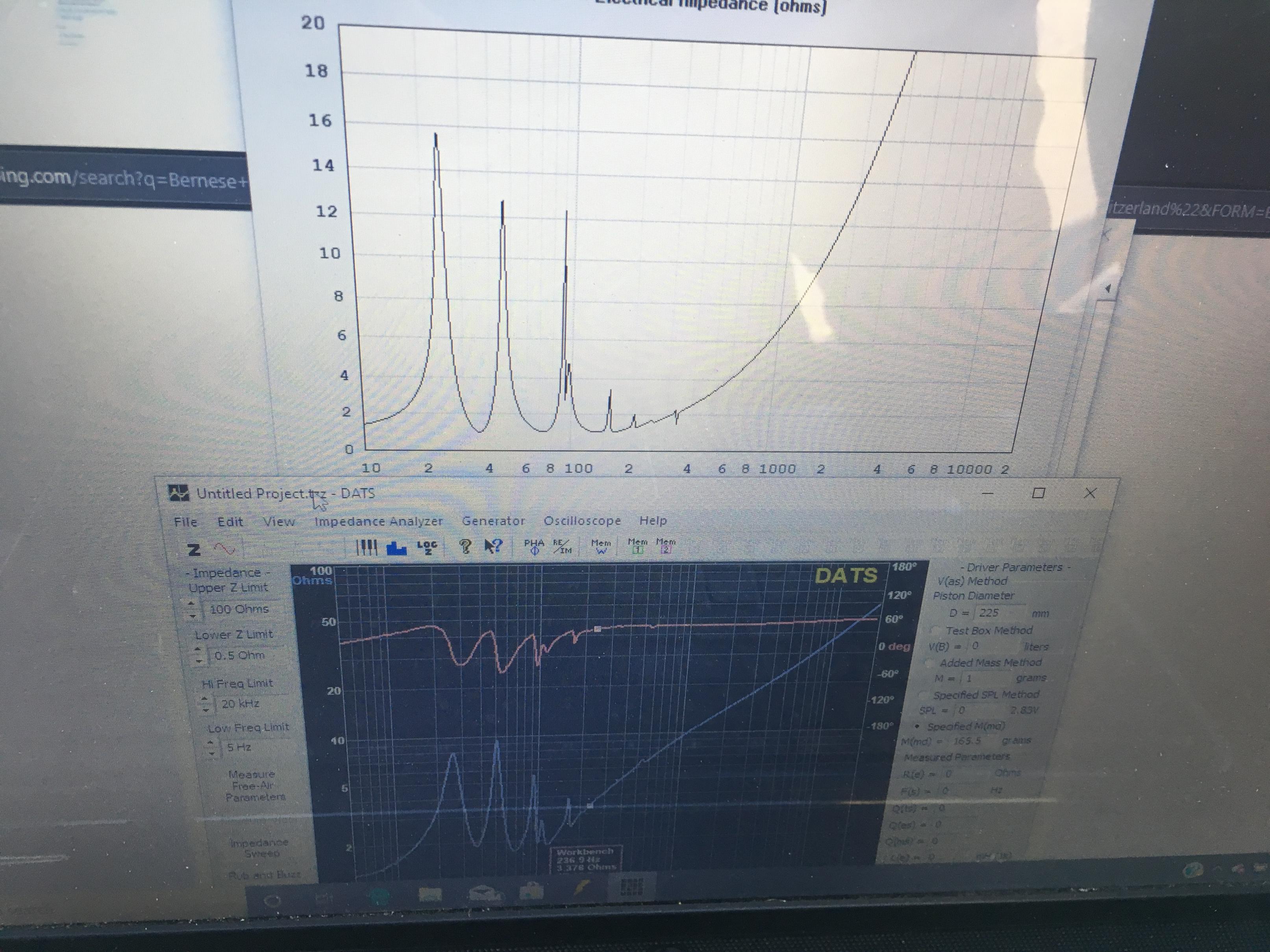

Impedance Measurement
Here is a cheap and reasonably easy way if you have some alligator clips, some cable and a suitable resistor.

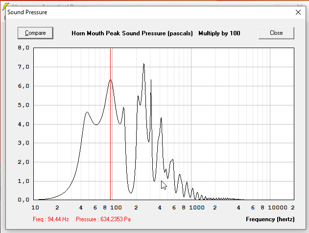

I could be off in my sim approach in HR, so I thought I would check in here?
My results are: if B&C 15sw115 in the topic roar of the thread I get this:
Impedance nulls at 38 and 78hz in 0.5xpi
Peak SPL at 108 hz is 109dB using 2.0 xPI and 2.83v
In 1.0xpi and rated power of 73.8v I get 141.1898 dB at 101hz Fb is 39hz
The cabinet is 276.836 liters
Really exciting cabinet and it seems to provide similar results to a paraflex. Which means a tapped pipe on steroids as far as I’m concerned.

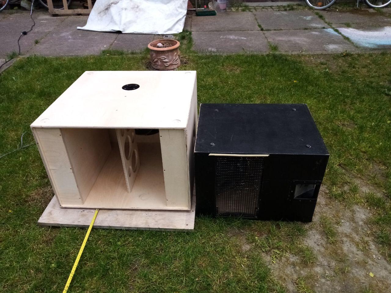

It is supported with very stiff bracing, also the backboxes of the cutout handles are braced against the wall and add extra stability. I was worried, if the backboxes could be a little to big (they sum up to ~5 liters) or causing irritation, but the simulation shows almost no difference.

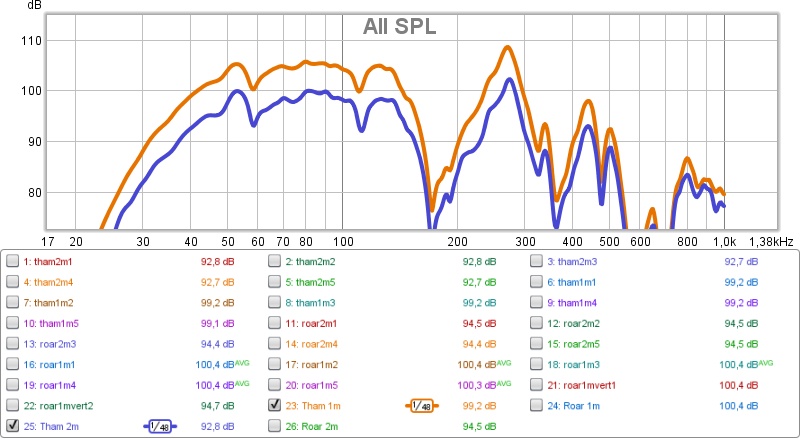

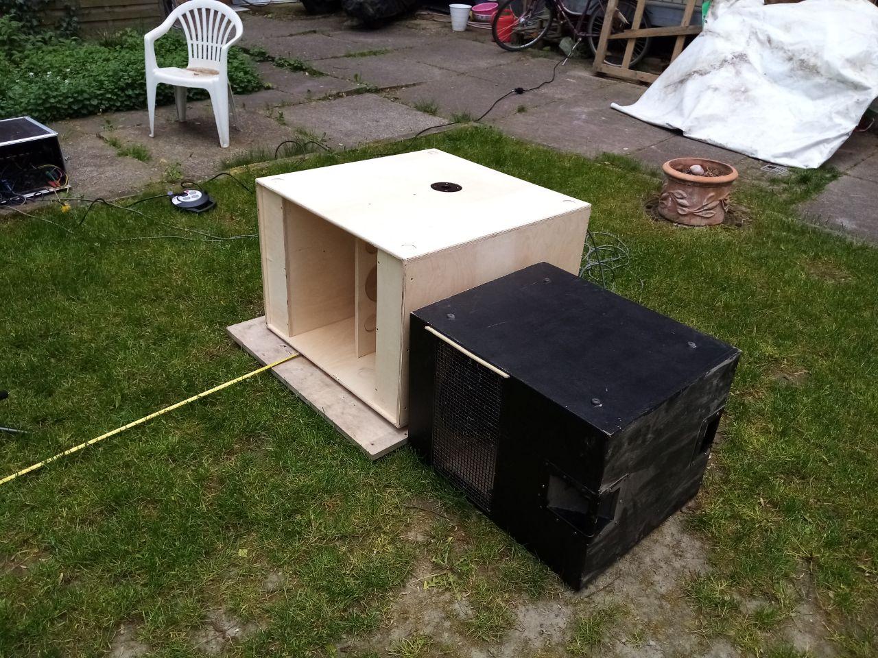

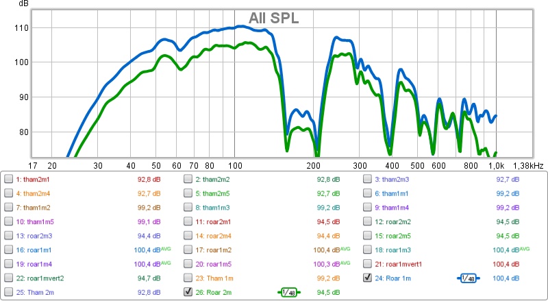

I set up the ROAR15 and a THAM15 in the garden today and did some quick 1m and 2m measurements. Sadly I could not measure impedance yet, but will buy a multimeter as soon as a recover financially (got fired because of COVID19 🙁).

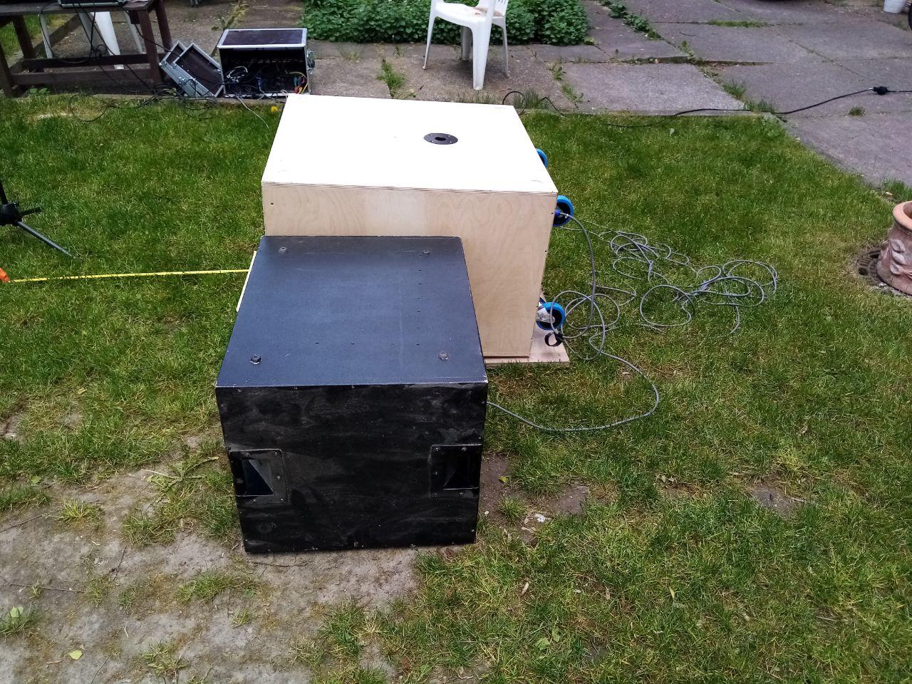

The measurementsas shown below are not too reliable, i fear, since i could not move the subwoofers farther away from the house. The dip around 60hz present in both measurements seems to result from a reflection of the wall. wavelength at the given frequency calculates to almost exactly the distance I set them up. Also, due to the smaller size of the THAM, it hat a little more distance to the wall, so the dip should move down some 4 or 5 hz (as it does).
-> Will have to repeat the measurements at a friends site with more space.
At least, the initial impression of a somewhat honky sound did not rehappen, hence I suppose it was a matter of placement.
Thank you for posting a direct comparrison like this, even if threre are some minor uncertainties it is still a comparable result which helps alot since far more diy'ers are famailliar with the THAM15 than the ROAR15.
I'm a bit qurious about the ~110Hz dip only being present in the THAM15 since it is not iherit in it's response, any thoughts?

No idea about the 120hz dip. I do remember having the same issue the first time I measured the THAM, but it disappeared after inverting the phase. Hopefully, better measurements will give clarity on that. And also on the low end of the ROAR15, which I expected to be a bit stronger. According to the simulation it should be a little higher in the upper 40s range, right?
Ok, thats a bit strange, inverting the phase should not influence the response in this kind of meassurement (swept sine i asume), I would have guessed it's an artefact from the ROAR15 aperture being in close proximity, anyway, just qurious.
The ROAR15 has a longer path from front to back of driver so it should coupple lower than the THAM15, which I found becomes evident when applying some eq, it seems to respond well to this even below 40Hz, and in my expirience it should be a one or a couple of dB's up compared in the 50 Hz region compared to THAM15 and then the difference in sensitivity should increase in favour of the ROAR15 all the way up to the upper passband limit.

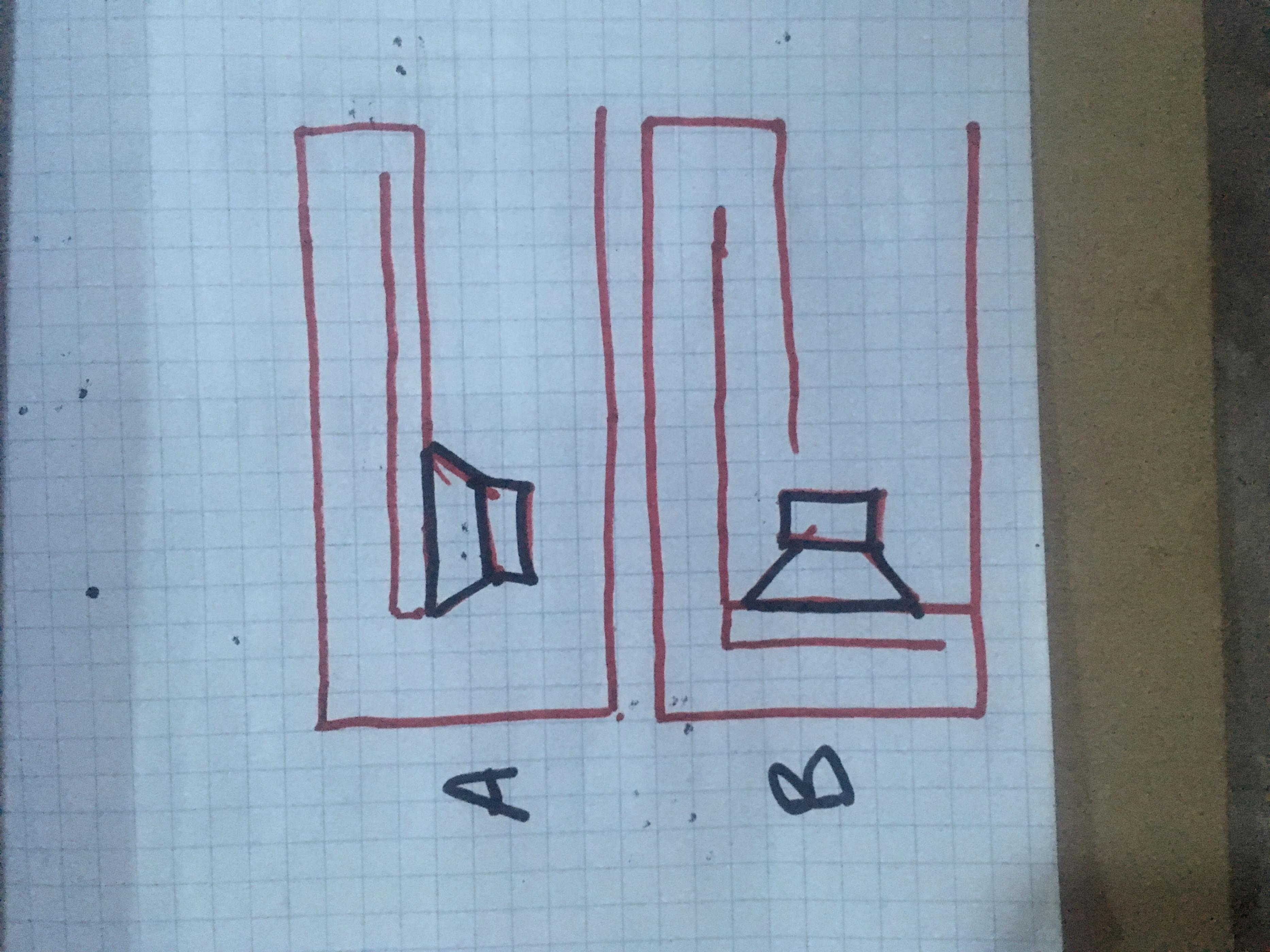

Is the roar design more like A or B here? Not much difference except ‘A’ might fit 2 drivers easier?

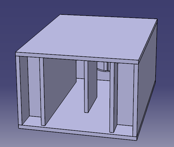

I would say that the ROAR series are more of a type B in your picture above, but symmetrically loaded, like this:
ROAR15 3D:

They both were side side by side while measuring? There might be your problem. When I compared tham15 and cubo15, there was strange dips in response because the other enclosure was resonating too and affected measurements!
So keep the area clear from any other subwoofers when measuring one 🙂

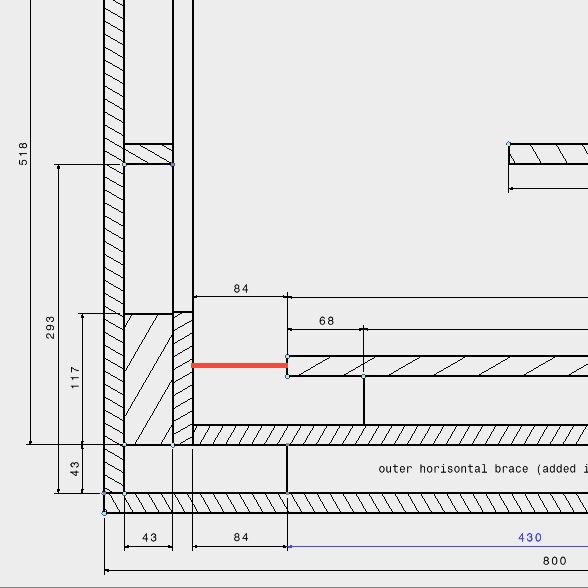

I believe (but I'm not sure) that perhaps the L45 depiction in your box plan sheet is more accurate, this since it might be so that only the fully enclosed volume is the one making up the QW resonator, and if so this is staring after the tapping (the openings into the resonator).
The question (and this was initially never fully resolved) is how the L34 transition should be set up, granted the L34 transition in the cad image might be slightly to long since the coupling (or summation) may not occur at the center of the driver, even though this is how you traditionally set it up.
I also see you adopt the advanced centreline method which has proven to be very accurate, in our case we let CATIA set up a natural flow line with neutral tension to describe the corner so we might loose some length there, I'm not sure which is best.
