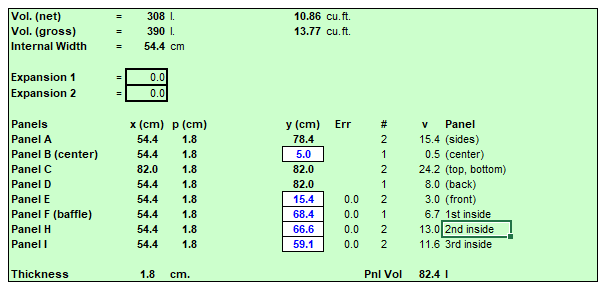

I tried the boxplan using data for the 15tbx100. thanks for the useful sheet, brian!
Between 15mm and 18mm, there is almost no noticeable difference in response.
But it noticed, the boxplan comes up with different S1 to S5 values and uses Par. The resulting curve using the standard values is quite different from the original simulation.

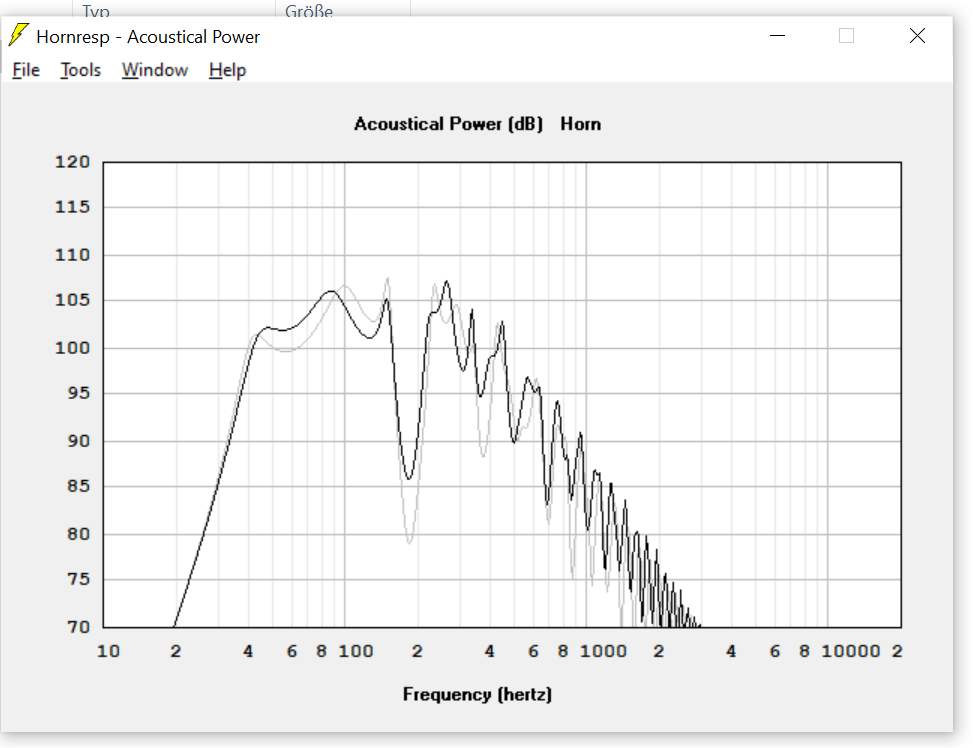

Unsure, what that means? the spl-response of the original simulation by martinsson looks better, in my opinion. assuming, that the change from 18mm to 15mm in boxplan results in almost the same curve, i might just adapt the original layout and change some of the measurements for +/- 3mm where necessary, right?

The use of Par (for Parabolic) segments, while technically the correct approach for a horn folded up into a rectangular box, should not make much difference here as there isn't any real expansion taking place between S1-S3 and S4-S5. S1 can be adjusted to match the ROAR 15 sim by changing the length of Panel B in the workbook. Once that's adjusted and the external dimensions are adjusted to match the ROAR15 as well, and the optimization routine is performed, the resulting response curve should be a lot more similar. It won't be exact though, because the original ROAR15 didn't have the S1-S3 path extending all the way to the front of the box (I think for aesthetic purposes, I'm not sure).

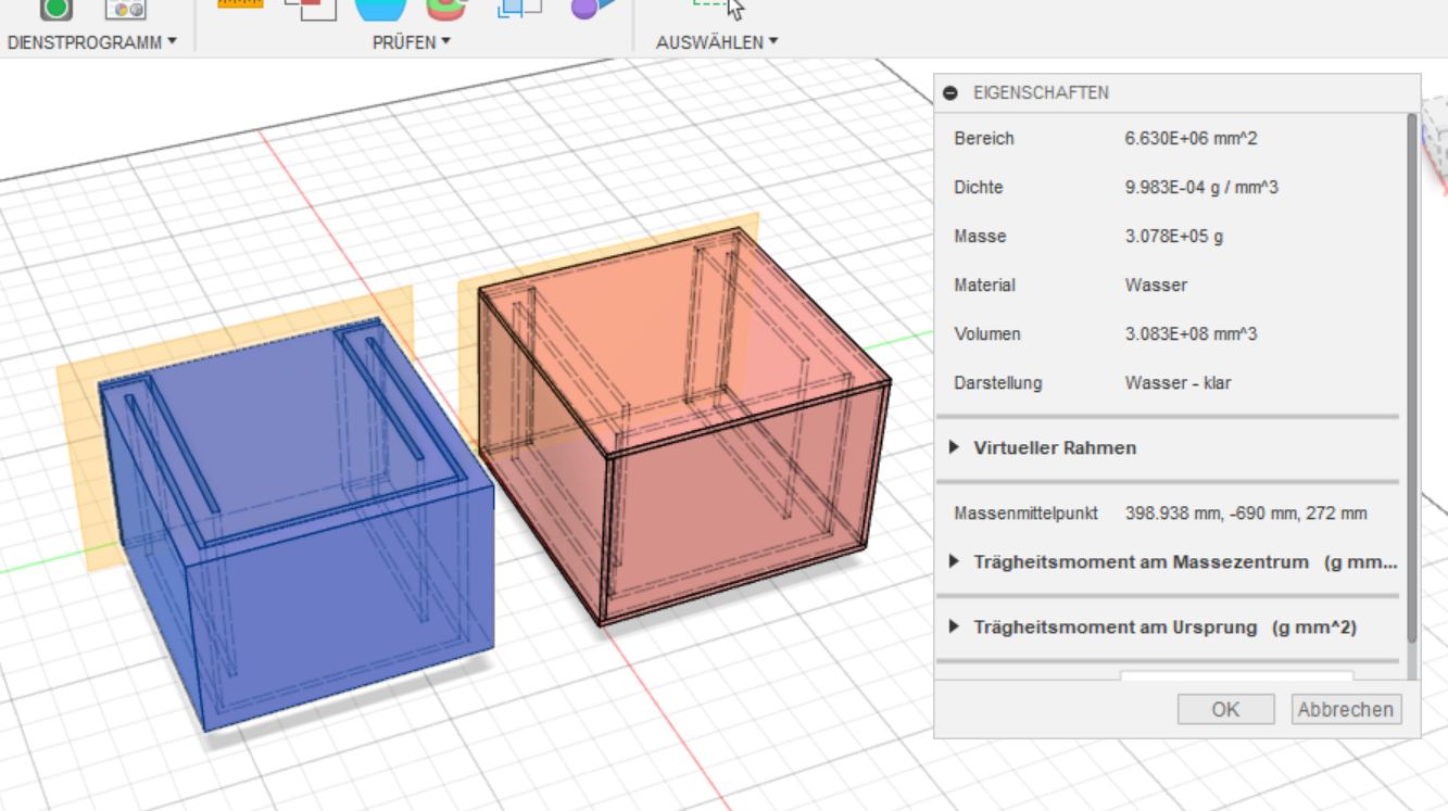

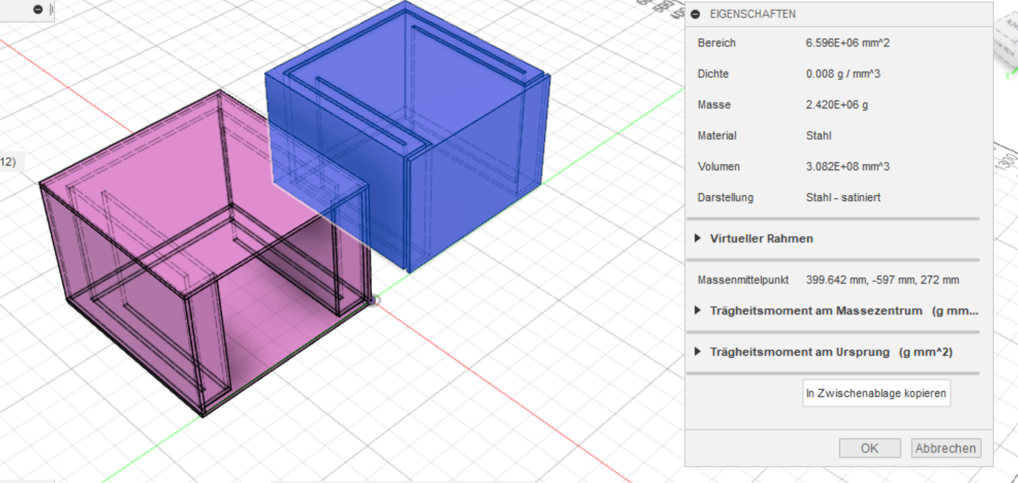

With the boxplan, I couldn't get close enough to the original simulation. So i modeled the original ROAR15 in Fusion360. My goal was to compare volumes between the 18mm vs. and a 15mm version with the original dimensions.
The Sketch in F360 included all the length-specifications and dependencies derived from the original 18mm-sketch. I then used it to calculate the inner volume (to keep it simple, I excluded the bracing, shouldn't make much difference at all) and compare it to a version, where i kept the original enclosure size and just changed the wood to 15mm. Following Circlomanens advice, I kept 18mm for the baffle and thus didn't include the baffle cutout in the volume calculation.
Results were somewhere additional ~10liters, if I were to just swap to 15mm without adapting the overall dimensions. I wouldn't have thought it was such a difference!
The original 18mm-version:
I then tweaked the 15mm version, to match its inner volume to the 18mm as much as possible. I came up with something as close as can get - ignoring the bracing and baffle cutout. The inner volume of the adapted version is 308,2l compared to original 308,3l.
Regarding the dependencies, through changing to 15mm, theres two competing distances: 1) 648mm measuring from port to port (the piece between outer and inner braces)
2) 512mm reso to reso (the most inside pieces, forming the walls of the resonator. I had to make a compromise there and decided to change them to 646mm and 516mm, because that gave the closes approximation to the original volume.

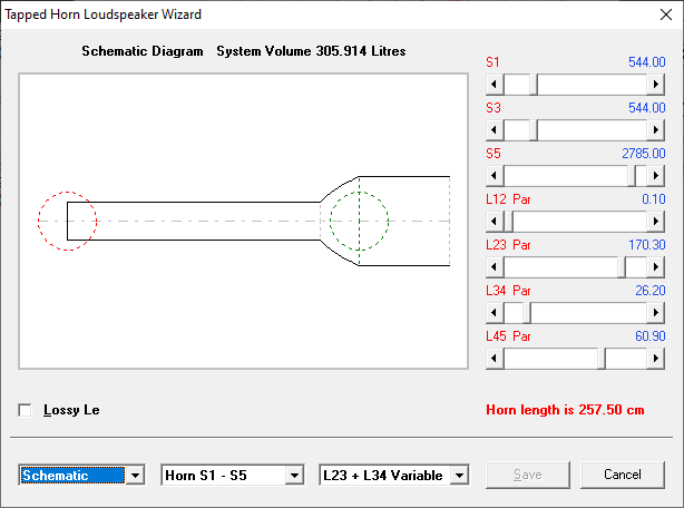

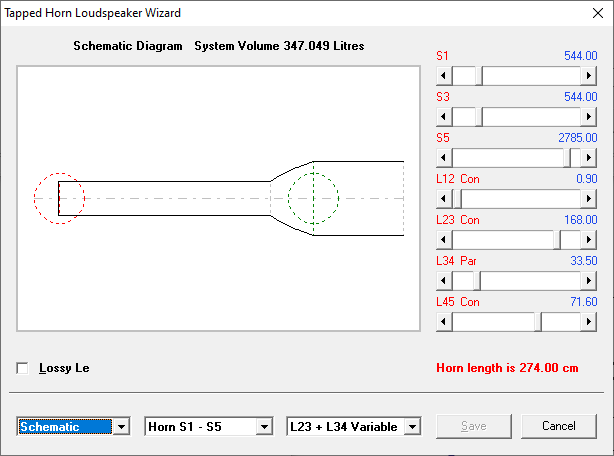

This got me curious, so I went and had a further look. It seems that the BoxPlan sheet gets it right for S1, S2, S3, L12 and L23 (accounting for the slightly different layout), S4 and S5, but the deviation occurs at L34 and L45, and it's due to the way that the path is analyzed. BoxPlan analyzes it as a mirror-imaged path along the center, but the ROAR image from their website puts L45 and L34 at the center of the path (see attached image).
So, which approach is more correct? Hmm...
Does anyone have a measured impedance curve for the ROAR15?
I believe (but I'm not sure) that perhaps the L45 depiction in your box plan sheet is more accurate, this since it might be so that only the fully enclosed volume is the one making up the QW resonator, and if so this is staring after the tapping (the openings into the resonator).
The question (and this was initially never fully resolved) is how the L34 transition should be set up, granted the L34 transition in the cad image might be slightly to long since the coupling (or summation) may not occur at the center of the driver, even though this is how you traditionally set it up.
I also see you adopt the advanced centreline method which has proven to be very accurate, in our case we let CATIA set up a natural flow line with neutral tension to describe the corner so we might loose some length there, I'm not sure which is best.
Another way to determine which approach is more correct is to look at what the Hornresp sim says about the net volume of the horn. And usually it's best that, if there's a difference, that the sim show a volume that's slightly smaller, rather than larger, than the actual net volume of the built horn.
This means that either (1) the sim on Martinsson's site is off a bit, or (2)both the Boxplan sim and the Boxplan estimate of net box size is off. I think the former might be more likely, as it's fairly easy to calculate net box size, so unless I made a REALLY big mistake in the Boxplan workbook...
- The calculated box volumes in Boxplan work out to be 390 liters gross (using the external dimensions) and 308 liters net volume (external volume minus the volume of the panels that make up the box).
- The corresponding Hornresp sim generated by Boxplan, with cone compensation turned off, puts the net volume at about 305 liters, a -1% error).
- The ROAR15 sim off of Martinsson's site puts the net volume at 347 liters, a +12.7% error (and the layout of the horn in the built ROAR15 doesn't occupy the entire box, so the real error is slightly higher).
I think the method used in your sim puts S4 closer to the right location, but results in a sim volume that's higher than net box volume, which means that the horn's lowest resonance frequency will be a bit higher than the sim suggests.
OTOH, the method used in my sim seems to get the net box volume correct, but puts the mouth tap (S4) off a bit from where it actually is, which means that while it should give a better estimate for the horn's lowest resonance frequency, the sim might be off a bit at the upper end of the passband.
I suspect that using Hornresp's "stepped horn" feature and moving the tap to S3 (by setting the sim type to "TH1") and using S2-S3 to represent the section by the driver might produce a sim that's closer to the build. The mouth "tap" will still be off a bit, but the error will be a lot smaller.
