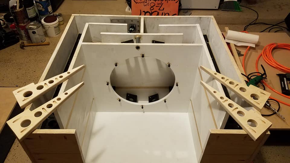

with some real interesting designs which reeeeally look like ROAR, just with different located low end entrance into the the big front resonator. Just look at the attached picture below. The guy who built this says the sounding is massive, punchy and tight, how circlomanen already described it.

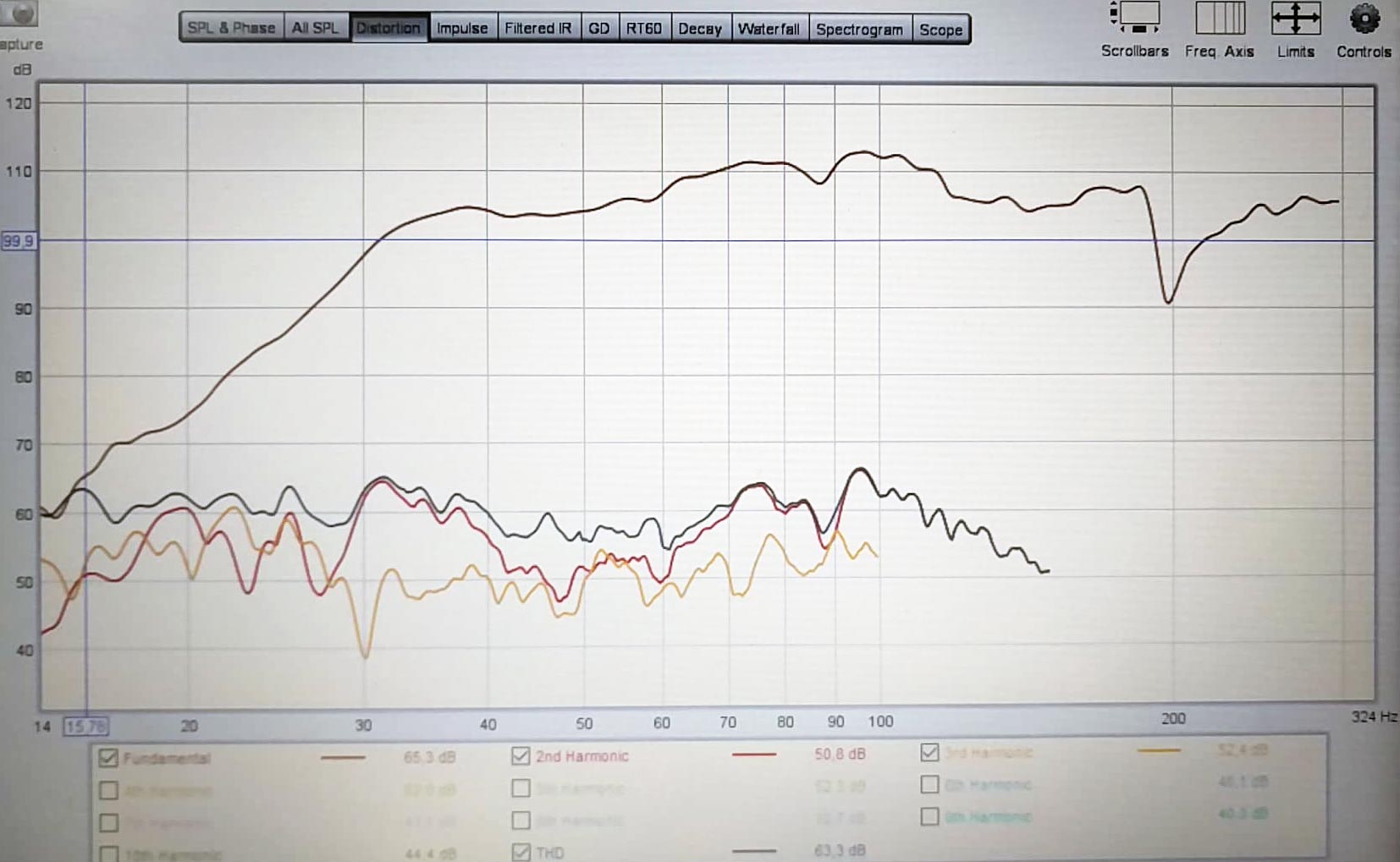

It's hard to say if Roar/Paraflex outperform the other. There are others in the group that did build a roar and compared and say the paraflex is outperforming the roar. But as far as I know this was not a scientific measurement.
What I do know is that my build and tested Type-C with data comparison with 1m outside ground plane measurement using REW, runs circles around the Xoc1 TH18.
My test included the same driver in both cabinets, the Type-C goes a bit deeper from 30hz up to 130hz and about 5db more output between 60 <> 130hz compared to Xoc1. Of course a bit apple to pears since the Type-C is a bit larger in size.
Here is my measurement of the Type-C:
Cool! that's very impressive, I'll see if I can find out more, I have asked permission to join the group, if they accept me I will try to find out more, I saw there where some really cool renderings on that page, interesting designs, your type-C measurement is really impressive, both in range and response.

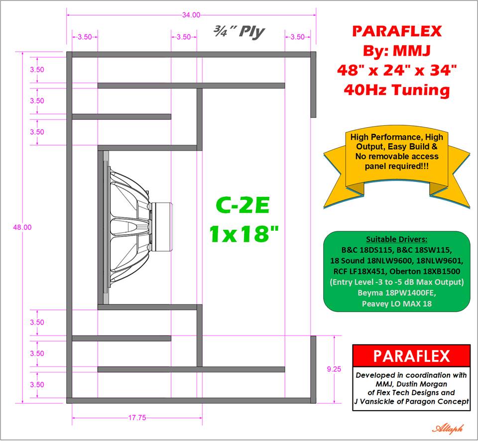

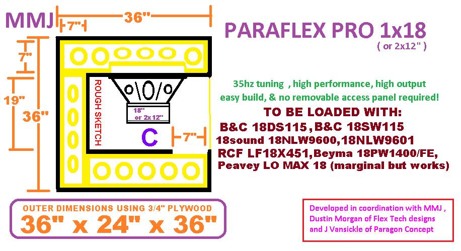

Nice Smitske69, I'll keep an eye on the Paraflex topic to follow your progress and findings, I must say the C2A is intriguing, the response shown by USRFobiwan looks amazing! as an 18" design it should be compared with ROAR18 which is roughly 50dm3 bigger than the C2A at 553dm3 external volume.
The measurement (at aperture) of the ROAR seems to indicate it has slightly less distortion, and with a 2nd harmonic dominating the pass band, but if measured in the same fashion we may see other figures.
Do you know where I might find the plans for the C2A? is there a site similar to mine with drawings published?

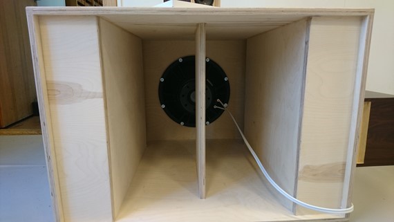

I visited the diy shoot out in gothenburg in April where matrinsson brought the ROAR15. I've both built and heard a lot of different loaded enclosure types and I got to say that this cab sounded very responsive with a presentation that could sound delicate or powerful depending on the program material. Before listning, I had my doubts due to the ragged simulated frequency responce and group delay. However, when built, it sounds smooth like a high impact band pass sub (in a good way). The lack of higher order distorsion products (due to the suck-out above the band pass) and panel vibration/box-sound is easily noted and very appealing.
If you want to assemble it according to the drawings (meaning no cutting away of material, i.e routing groves in the top and bottom panels) then the dimensions of the various pieces making up the enclosure should be pretty easy to derive from the drawings, there should be no dimensions omitted to just that since it is needed for external manufacturing/assembly.
This goes for all the ROAR drawings, a specific cut list was therefore left out, it should not take long to get the dimensions down on paper for all the pieces, there are not that many unique ones (symmetrical design).

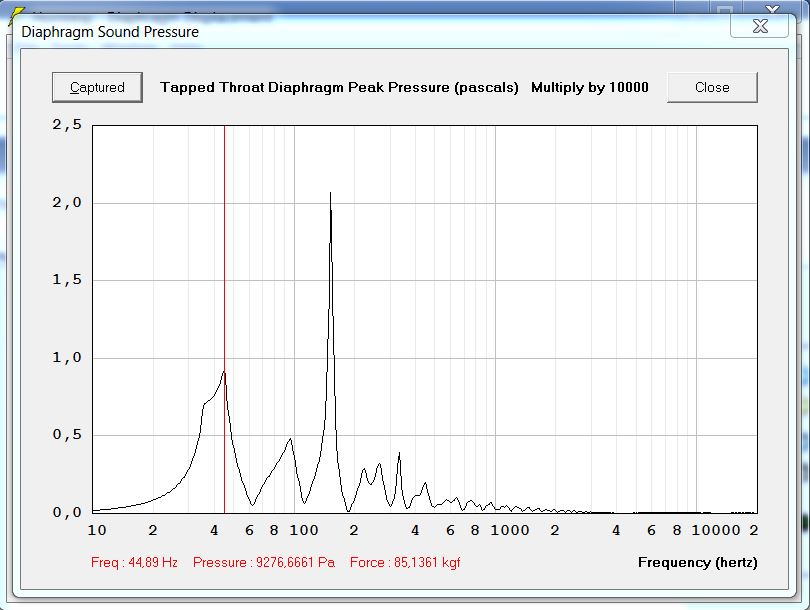

Hi everyone, Circlomanen brings me here :) I have a question regarding the minimum thickness of the PLY as I have weight limitations. Does anybody have tried to build a ROAR15 with 1/4" / 7mm plywood ? would you recommend to do so ? If not, what would be the minimum recommended ?
I'm using a quite powerful driver (the RCF LF15N401) where you can find specs here : https://www.lautsprechershop.de/pdf/rcf/lf15n401.pdf
Thanks ^^
You could definitely build a THAM15 from well braced half inch/12 mm birch plywood, but since the ROAR has several parallel and much larger unsupported wall sections I would personally use at least 15 mm birch plywood as an absolute minimum. And use 18 mm or two layer of 15 mm in the baffle holding the driver.
If the cone experiences 85 kg peak force 44,8 times a second at peak output spl, then the rest of the plywood holding the driver and the tapped pipe air column needs to be quite stiff and robust.
